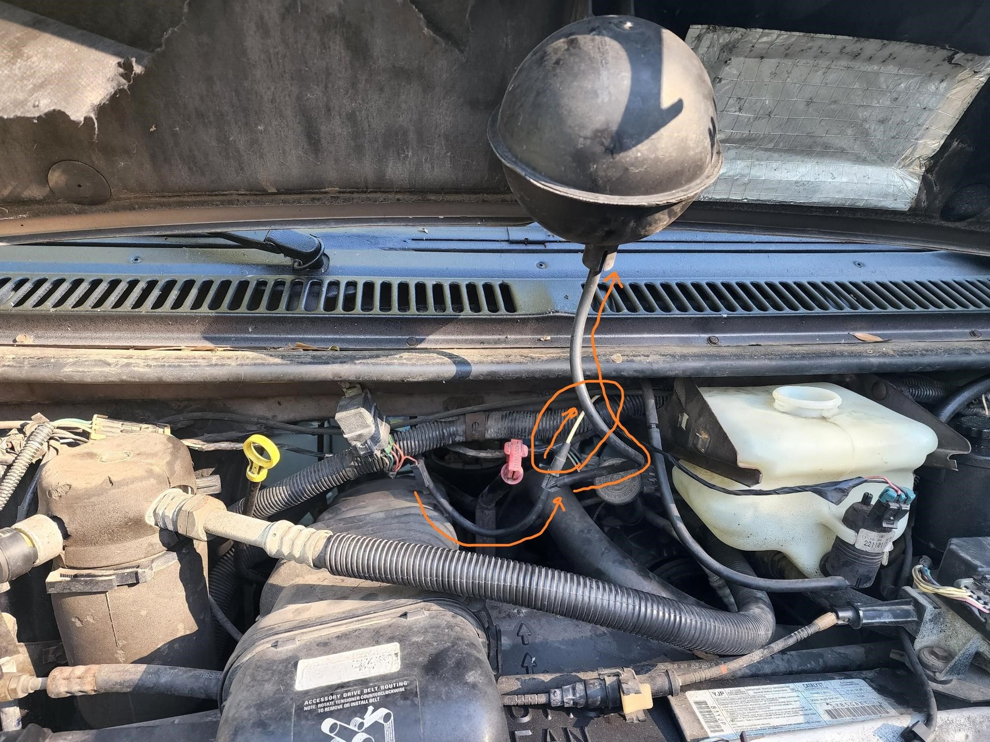

So, I'm cracking the engine case open today, tomorrow I replace that vacuum valve, and I just want to be ready. I noticed that the valve I have has one port capped off. Pictures I have seen in other applications, such as this image here of a 94 G20, has a hose connected to the bottom of the "T" valve. Look below at my attached image to see that mine is capped (the small white valve). Is this for the brake booster? I know that some applications use a vacuum line to the BB..

Re: Lose Air to Vents at Highway speeds 60+
Normally the thing goes to the engine, the ac vacuum system, and the "orb of power" aka the vacuum reserve canister.

Quote: Normally the thing goes to the engine, the ac vacuum system, and the "orb of power" aka the vacuum reserve canister.
Okay. Looks like mine just connects to the intake manifold and then to the almighty orb, and I guess the ac is capped for whatever reason. I am not original owner, bought the van months ago, so I don't know if this was changed by previous owners or if this is something that changed from 94 - 95. 1995 is the last year of production for the G series vans. 1996 is when the vortec change occurred, I believe...
I'll swap in the new valve tomorrow, keep this line capped, and see if I can get a fix in. Thanks for the help, I'll update tomorrow.

According to the diagram below (1st pic), #45 is the AC vacuum hose that is splitting off from the Great Orb vacuum line, which btw is fed from the original picture I posted, the line coming off the valve.
Look at my application (the second pic) and you'll see a smaller white-ish line splitting off and disappearing behind the firewall/wiring harness. The line goes into the firewall toward the driver, which I assume is going to the AC controls. Is that correctly where you meant the vacum line should go to the AC?

Im a little confused...The picture of the actual engine bays is yours right?
So you have two areas of interest,,, the first pic with the check valve, and the second with the 'orb? So,,, the vacuum line goes from the manifold, to the 3 way valve with the cap, and from that valve, the line goes to the orb" in your second pic right?
Tru check first thing that al lyour connections are tight... I find the hose on the orb likes to work its way loose at times.

Quote: Im a little confused...The picture of the actual engine bays is yours right?
Correct, the line goes from the back of the manifold near the dist, up into the 3-way (capped) valve (that I replaced). It then runs forward to the small engine bay and splits, one line going to the ball, the other (the thin, white line) going into the firewall (assuming that goes to to the AC head unit?).
