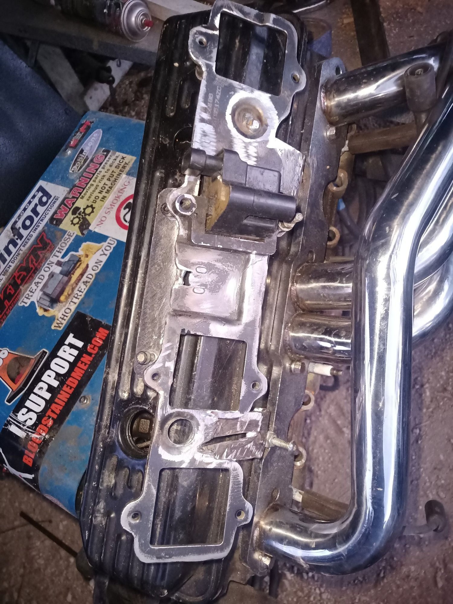

I have the fancy high flow single plain Holley intake that supports 8 Big or 8 Small injectors to my L31 heads & basically any intake plenum I want to adapt to it. My brain is exploding on basically 2 or 3 things WHAT Whack Throttle body, or ram Air, or vortech supercharger do I want to run? / fabricate . I weld, and do fiberglass & carbon work as well.

Im building my own LS Harness on a 0411 PCM for my Essentially LT1 /LT4 ish 350. 24 pt reluctor wheel to run my 8 LS coil packs and 8 injectors. I still need to figure out if if I can do the tuning to put 20 hole, ultra high atomization LSX injectors. .

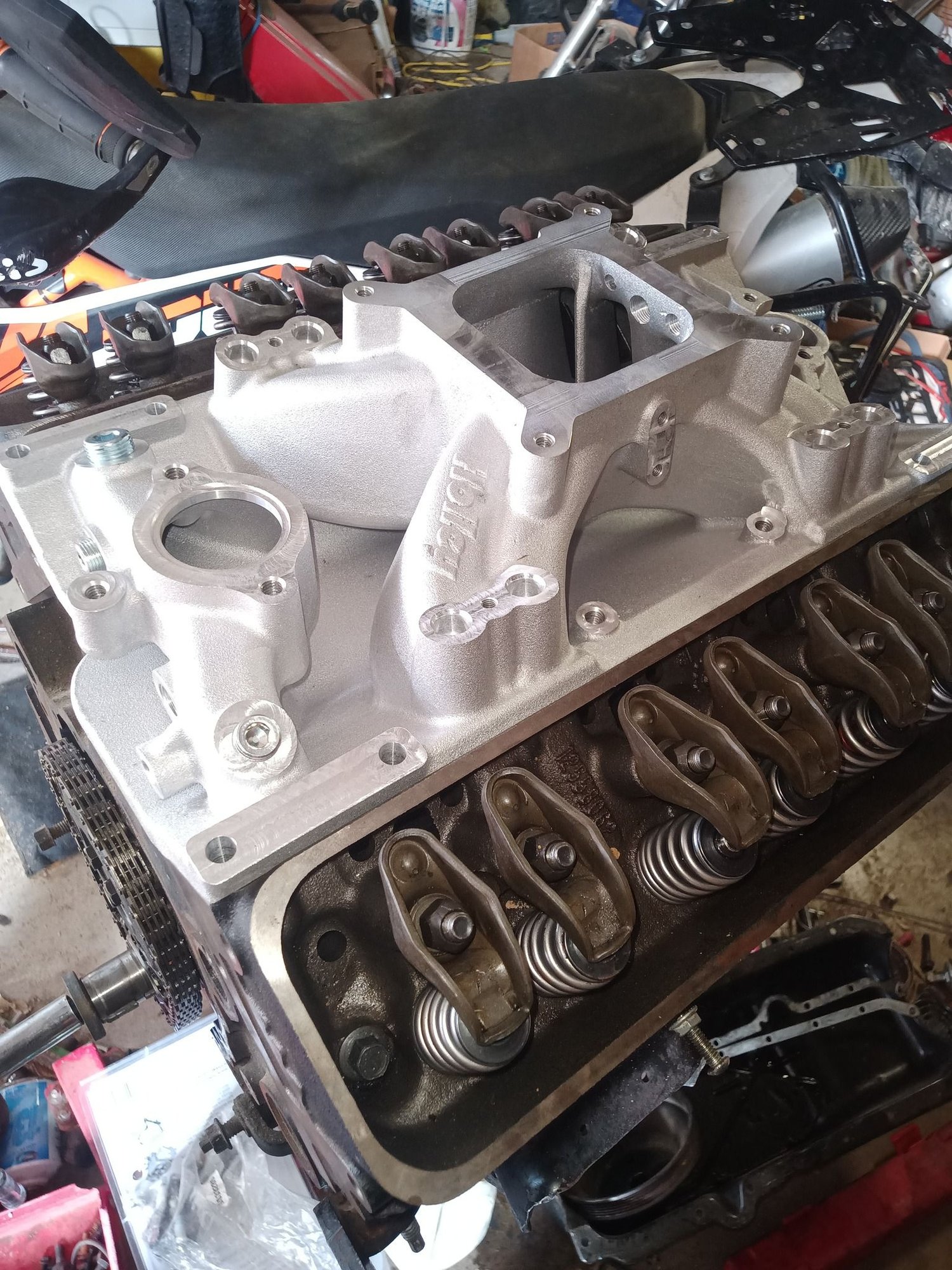

I was trying to research your Intake-Manifold... I believe that I found it.
Do you know the Part Number?
Anyway, what I saw was a very nice looking Single-Plane Carburetor-Flange Manifold.
You would actually gain a significant amount of Low to Mid RPM Torque (up to 40 Ft/ Lbs, depending on the Camshaft)...
By switching to the Edelbrock Vortec Performer RPM Air-Gap Manifold.
It has Bosses in each Runner for Nitrous Nozzles... they can very easily be machined for your Fuel-Injectors instead.
Or honestly even a Throttle-Body with the Injectors built-in, would be worth it just to change the Intake-Manifold.
