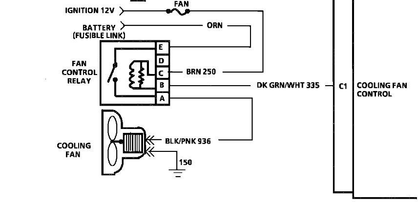

The '89 single fan set up is ECM controlled (yes, electronics). Pin C1 goes low to activate the cooling fan relay.
With the key-on, engine-off you can ground C1 at the ECM and the fan should run. If not then the relay may be bad or the C-H FAN fuse may be bad.

Just a typo, what I described is actually for an '86. The fan is ECM controlled via the fan relay. The wire from pin C1 is DRK-GRN/WHT.

Firewall near brake booster. Identify it by wire colors. RBob's schematic is very helpful in many ways even if not strictly applicable.
The diagram shows a fusible link. does anyone know where that might be found? I have replaced the motor and relay and it's still not working.??

Iirc fusiable link is next to the battery, is that where your loosing power ?
