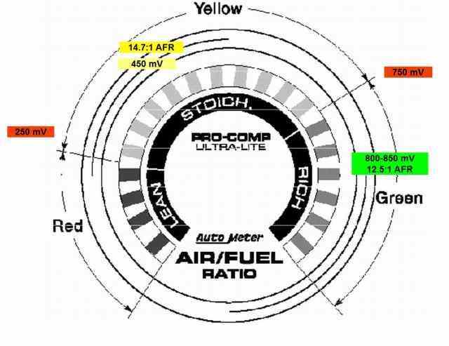

If the engine is starving for fuel at high rpm causing the carb to lean out it will clearly shiw up indicated by a change in WOT AFR as seen on a AFR guage.
This is a better indication of whats really going on than say a fuel pressure guage is.
It need not be expensive.. I use a Narrow Band AFR guage with heated type NB Oxygen sensir.
No calibration errors... easy to install and use.
Clearly shows if when the fuel system cannot keep up to engine demand @WOT as the guage clearly leans out under WOT as rpm climbs.
If the fuel system is good the AFR guage will stay solidly in the typical "rich zone" on the guage @WOT. If its running out of gas @WOT the guage will clearly shift progressivly LEANER
.85 mv +/-. is normal for WOT AFR.

Low cost. Tells you a LOT.
