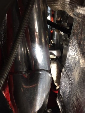

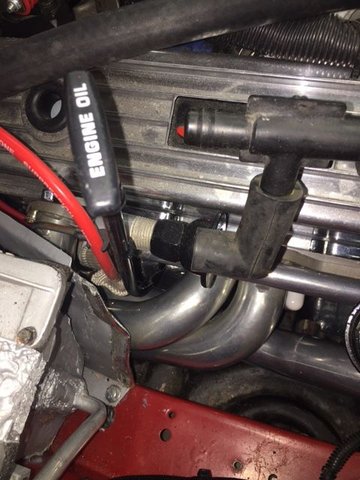

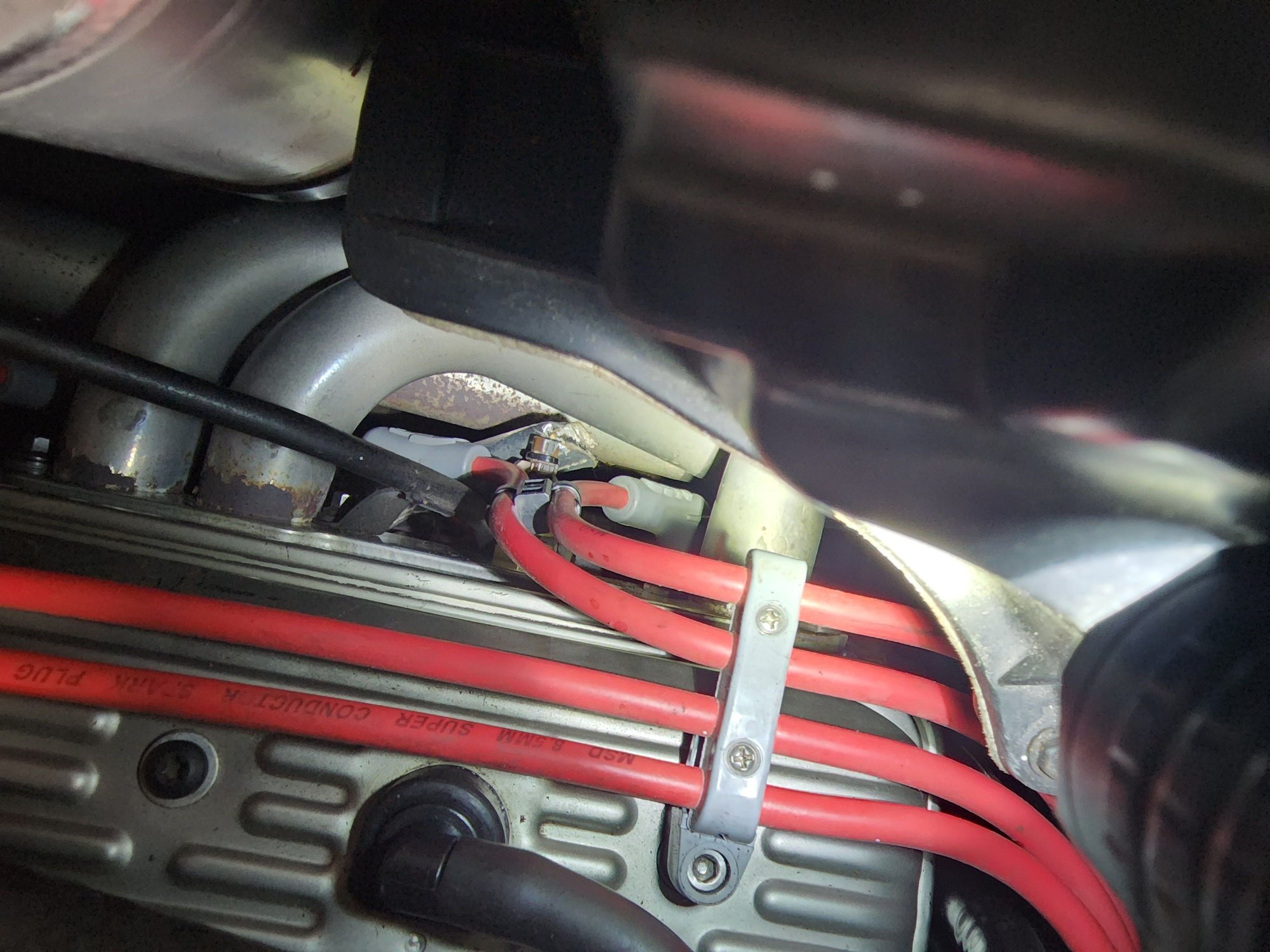

Just finished fitting spark plug wires routed under headers with heat resistant tubing routed up back of engine to distributor.
Having second thoughts on #8 (passenger side rear) despite using ceramic boot and spark plug booty, it is routed between header into head exhaust and lower header collector which will put allot of heat on this plug both below and next to it.
Looking for feedback from anyone who has run #8 wire down in this configuration, did it hold up?
I'm thinking about running this wire up over the valve cover by the oil dipstick to avoid the "heat sandwich" it could face in the current setup.
Passenger side, #8 plug
#8 plug, closer view
#8 plug, underneath looking up.

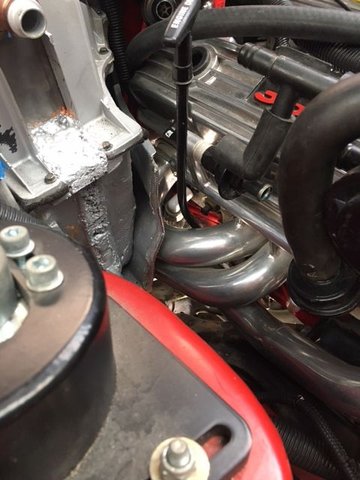

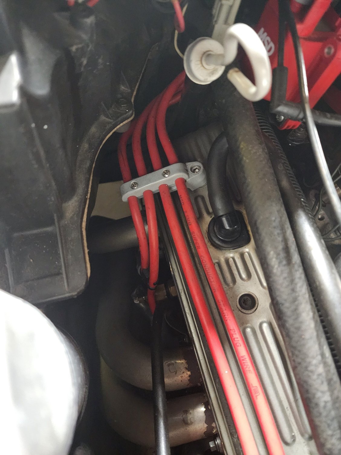

Decided to go with 1-7 spark plug down and #8 up. I epoxied a spark plug holder to the oil dipstick tube to keep the #8 wire away from the headers.
It's a little unconventional but after trying a few options, appears to be best solution to avoid the heat. Mallory ceramic plug boots should keep the plug ends safe from the heat.
Driver side
Passenger side

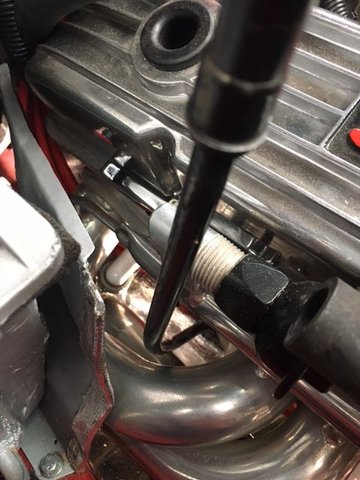

Re: #8 spark plug wire: up or down?
What oil dipstick and tube is that? Mine had to be mangled to work with the headers and it doesn't pull out very smooth. It also had to be angled much more than yours to line up with the header bolt hole. I bought a Lokar flexible dipstick but it wouldn't fit in the block.
As far as plug wires go I haven't had any issue with routing them all down from the top using center bolt valve cover wire retainers and 90 degree terminal ends with Ac Delco plugs.

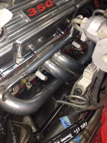

here's the best pic I could get of how I routed from the top
