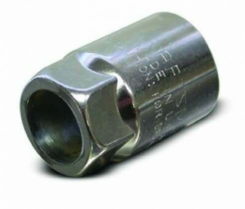

And the matching box wrench on the hex to turn it.
Trick Flow Specialties TFS-90500 Trick Flow® Spark Plug Sockets | Summit Racing

is there anything different about this socket than a normal spark plug socket (which i was using)?

Re: So. I screwed up. (Broken spark plug)
Look closely.
The square for the ratchet drive has been drilled out, so that the spark plug insulator can pass through.
The socket has been shortened. This socket works great with headers, or any other limited clearance situations.
You can do these mods yourself if you have a lathe.
