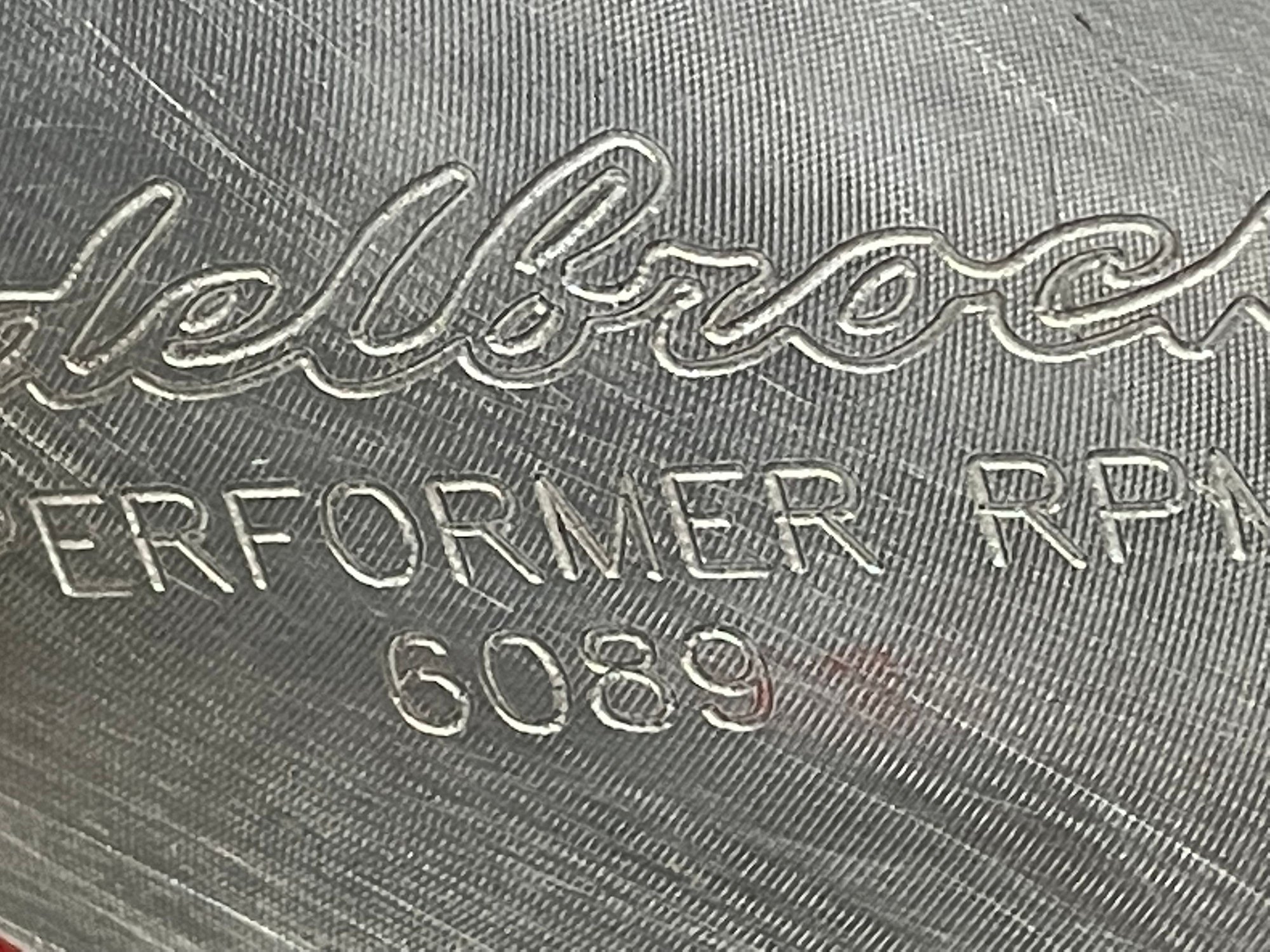

Old Nov 26, 2022 | 01:41 PM
caperkev's Avatar
Joined: Nov 2022
Posts: 8
Re: 383 BUILD ADVICE
edelbrock rpm performer old casting 6089

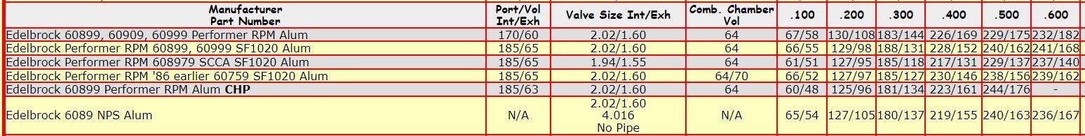

skinny z's Avatar
Joined: Dec 2005
Posts: 9,919
Likes: 884
From: 53.0907° N, 113.4695° W
60899 perhaps?
Although there is a twenty year old 6089. And you did say old style.
Flow numbers are down by way of comparison. How that will affect your output may be difficult to predict.
Old Nov 26, 2022 | 02:49 PM
caperkev's Avatar
Joined: Nov 2022
Posts: 8
60899 is the new casting these were bought about 11 years ago an never used
6089 is the 64 cc head
Old Nov 26, 2022 | 02:56 PM
skinny z's Avatar
Joined: Dec 2005
Posts: 9,919
Likes: 884
Old Nov 26, 2022 | 03:05 PM
caperkev's Avatar
Joined: Nov 2022
Posts: 8
the numbers are very close i dont know i had them here an figured may as well use if they dont work well i can always swap them out for some new stuff just being cheap is all,
i did install100 thou longer push rods too forgot about that as they were with the heads when bought i had a plan just not sure what it was lol
