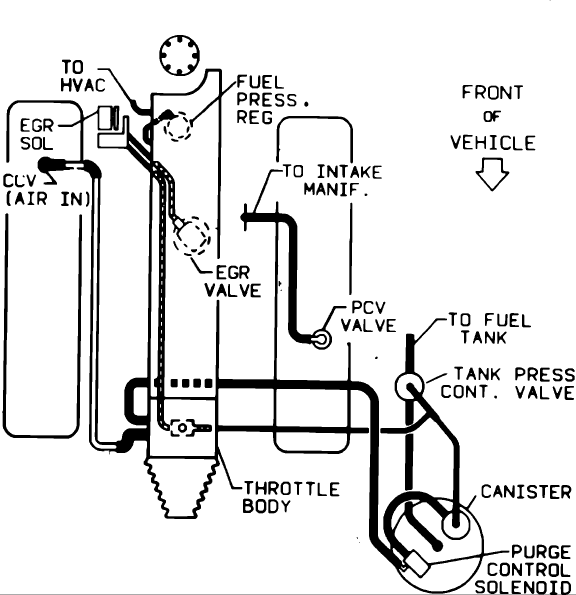

It's not hard to see on vacuum controlled egr, just put a vacuum guage on the vacuum line to the egr valve. Common sense would show you can't have something turn on with vacuum at WOT because of the lack of vacuum at WOT. But trying to stay on topic you don't need EGR for anything beyond being compliant with your state inspection. Here in Texas we quit doing emissions testing on cars 25 years and older but we still have to verify all of the emissions devices are still there. They don't have to work they just need to be there and look like they might work.
The induction system does still make vacuum even at WOT. Carb engines alao used ported vacuum for EGR. It only takes a little bit of vacuum to unseat that valve.

some makes do use ported vacuum to control egr even on fuel injection. The tpi is that way. I'm not sure about the tbi.

FWIW TBI is also ported vacuum. Pulls from about the same point above the closed position of the throttle plate as the purge canister. The solenoid is only there to prevent EGR with a cold engine and in some cases one that is overheating.
