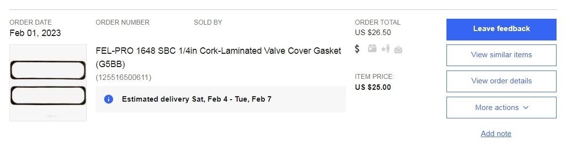

Actually just scored a cheap set on ebay Glad I remembered because of this thread. Got a great deal on a new set of Holley cast center bolt valve covers for one of my future projects, so now I'm GTG! Prices are gong up on a lot of stuff and some places have them for $65!!!
