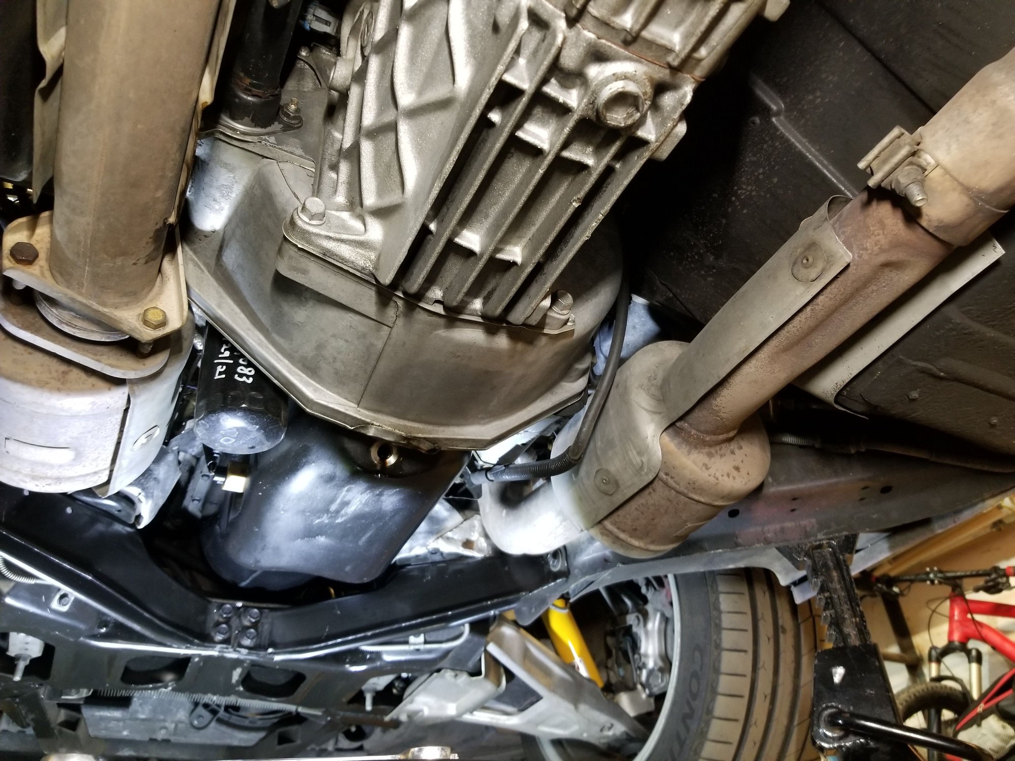

It's already covered, but I wanted to add to this, based on data from my stuff, which aligns with LAFireboyd's post, above.
When "which oil" threads come up, I always say, "All oil today, is better then good enough". What's "Good enough"? The answer to that, comes from the question, "How long, is long enough?" In other words, how long does your engine really need to last? In some people's minds (my own mind, years ago, for example), we want our engine to last indefinitely, right? We don't need engine problems, so what oil will make my engine...."never wear out"? Of course, the rest of the car is going rust out, wear out, fall apart at some point anyway, so we really don't need our engine to last to infinity. So how long should it last? 150k? 200k? 300k? How long is long enough? I've settled on 200k for myself. By 200,000 miles, most cars that I've owned are in one of three categories:
1. The rest of the car is worn out/rusted out
2. I've lost interest and sold the car/got something else/car priorities changed.
3. The car has been relegated to "Toy" status, where it gets driven little, and has been modded to the point where the original engine doesn't matter or is no longer in service anyway (engine swapped).
Last night, I changed the oil on my 'Vette. One of the measures of engine health is oil consumption. The Oil Life Monitor called for a change, so I changed it and noted the mileage since the last change; 8100 miles, then I measured the amount of oil that I had drained out; 4.25 quarts. The engine burned .75 quart, over 8100 miles. That is some pretty low oil consumption, indicating pretty good engine health. Note that the engine exhibits good health in other measurable areas, too. Anyway, the car currently has 210,000 miles, gets daily'd in the summers and has seen a fair amount of drag track, road track and auto cross use/abuse. .75 qt over 8100 miles.
My very first car, an '83 Trans Am, w/the LG4, I drove that car to 200,000 miles, then sold it to a friend who drove it to 245,000 miles and sold it and I lost track of it. I ran "Cumberland Farms XP Lube" engine oil in it. Cumberland Farms is a New England, regional chain of gas stations/convenience stores. I don't think that their oil is exactly top shelf...but it was better than good enough. When I sold the car, it was faster than when I bought it, got the same gas mileage, started and ran perfect, and burned essentially, no oil between 3000 mile changes.
Another example; a '96 Silverado 1500. I ran the wee out of that truck, towed my boat to Lake Powell 100's of times, 620 mile round trip through mountainous terrain. No sports car I've had has been worked as hard as that truck was flogged with hours, upon hours of WOT use. 100's of hours at WOT, I'd guess. I had that truck for 15 years, sold with 300,000 miles, still running perfectly, by all measures. The body was rusting off the frame. How long, is long enough? For that truck, 300,000 miles was longer than the rest of the truck was good for, and the engine likely had another 100,000 miles of life left. Possibly more.
Finally, at work, I manage fleet maintenance on well over 100 vehicles. Been doing that for over 25 years, so with vehicle turn over and changing companies, I've been responsible for maintenance on over 1000 vehicles in my career. I've never seen an oil related engine failure. I've seen three engines fail at work;
1. Mercedes OM926 had a rod bolt unthread
2. Vortec 350 had an intake gasket failure, filled the oil pan with coolant and seized up
3. Early '80's Blazer, employee never checked engine oil, ran it out of oil, seized it up.
But more interesting, is the snow cats; one brand calls for a change interval of 250 hours -about two weeks' worth of operation. We change and sample at 250, as per the OEM recommendation on every cat. The oil samples consistently show that the oil isn't close to needing a change. All of the indicators; viscosity, fuel, metals, soot, cleanliness, etc....they all look fantastic and indicate that we could push out the interval significantly. Jackson Hole ski resort, runs the same cats and using sampling, they have pushed their oil change intervals out to 1500 hours -a full season! No issues. OEM recommends 250 hours. Oil is better than good enough. Way better.
So? Today's oil is pretty fantastic stuff, and when combined with a reasonable change interval, is way better than good enough...even cheapy-cheap, off brand oils do as well or better than we need them to. So buy the oil that comes in the container that you like the looks of...or has the brand that you like the sound of....or fits the budget that you have. ANY of 'em will do better than you need it to. Buy the right weight, change it on time, drive and enjoy..
