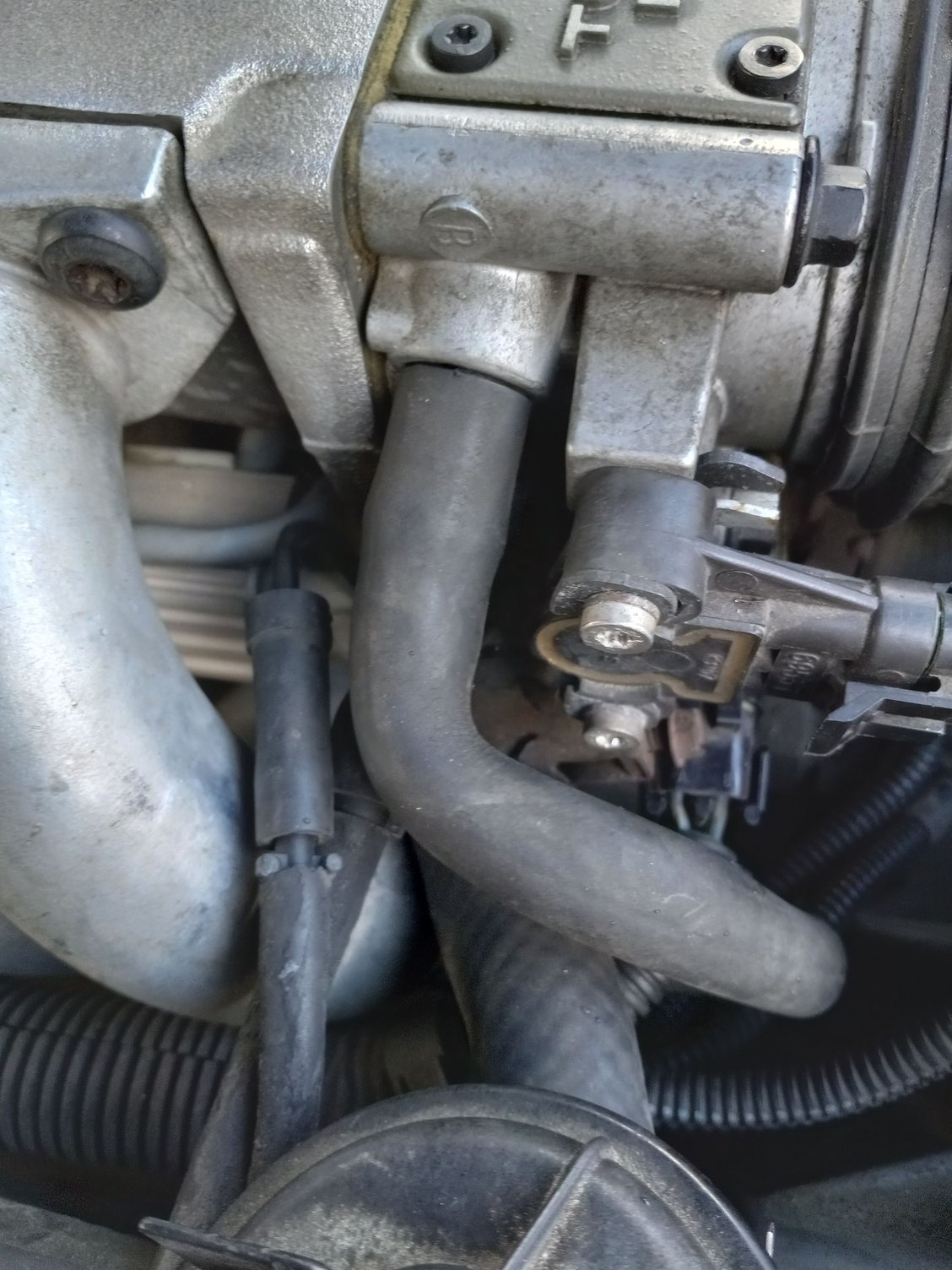

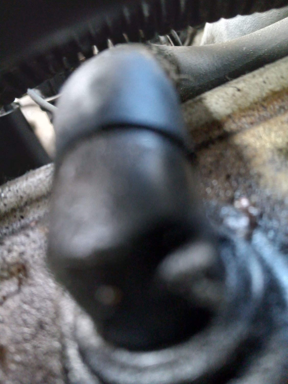

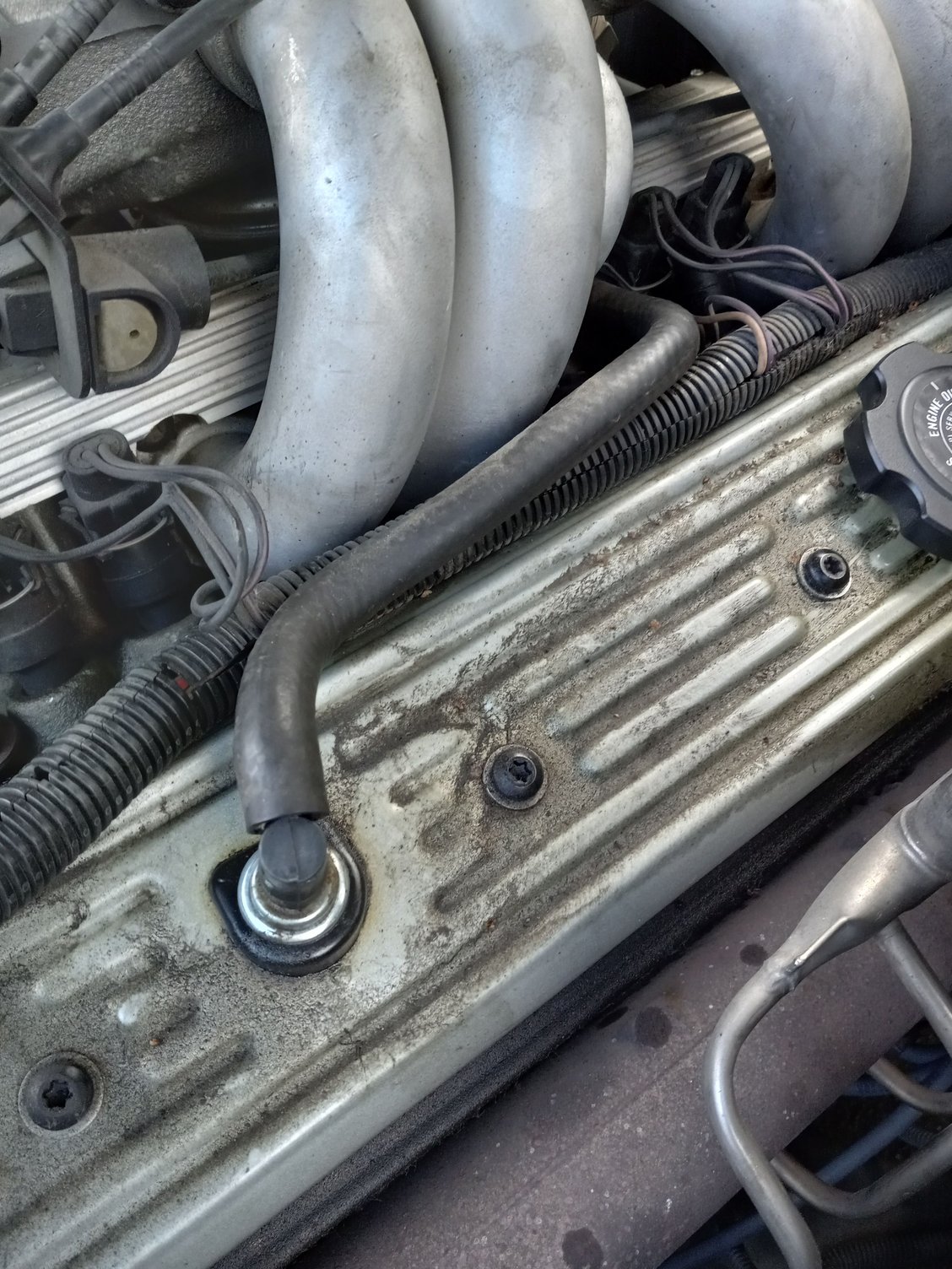

Sofakingdom, guess I was overthinking it. As far as the emissions hoses go, they're identical to the sticker on the hood. Photo 1 is the hose from PCV valve on the driver side valve cover leading to the intake manifold. Photographs 2 is the hose from the throttle body on the passenger side leading to the passenger side valve cover for air in. Photograph 3 is the location of the air in hose on the passenger side valve cover (coming in from the passenger side throttle body).

Passenger side hose from throttle body leading to passenger side valve cover (air in)
Close up of air in hose (coming in from passenger side throttle body)

OK, so looks like it's all still there.
Any rips/tears/splits/cracks in any of the parts that go to the pass side valve cover?
The hose that goes from the TB to the PCV valve all OK?

Re: 88 GTA standalone EFI and stock dashboard questions
The hose going to the PCV valve, as well as the hose going to the passenger side valve cover seem fine, with no visible tears or splits/cracks. I've already done a couple rounds of carb cleaner, especially focusing on those hoses, and nothing unfortunately.
