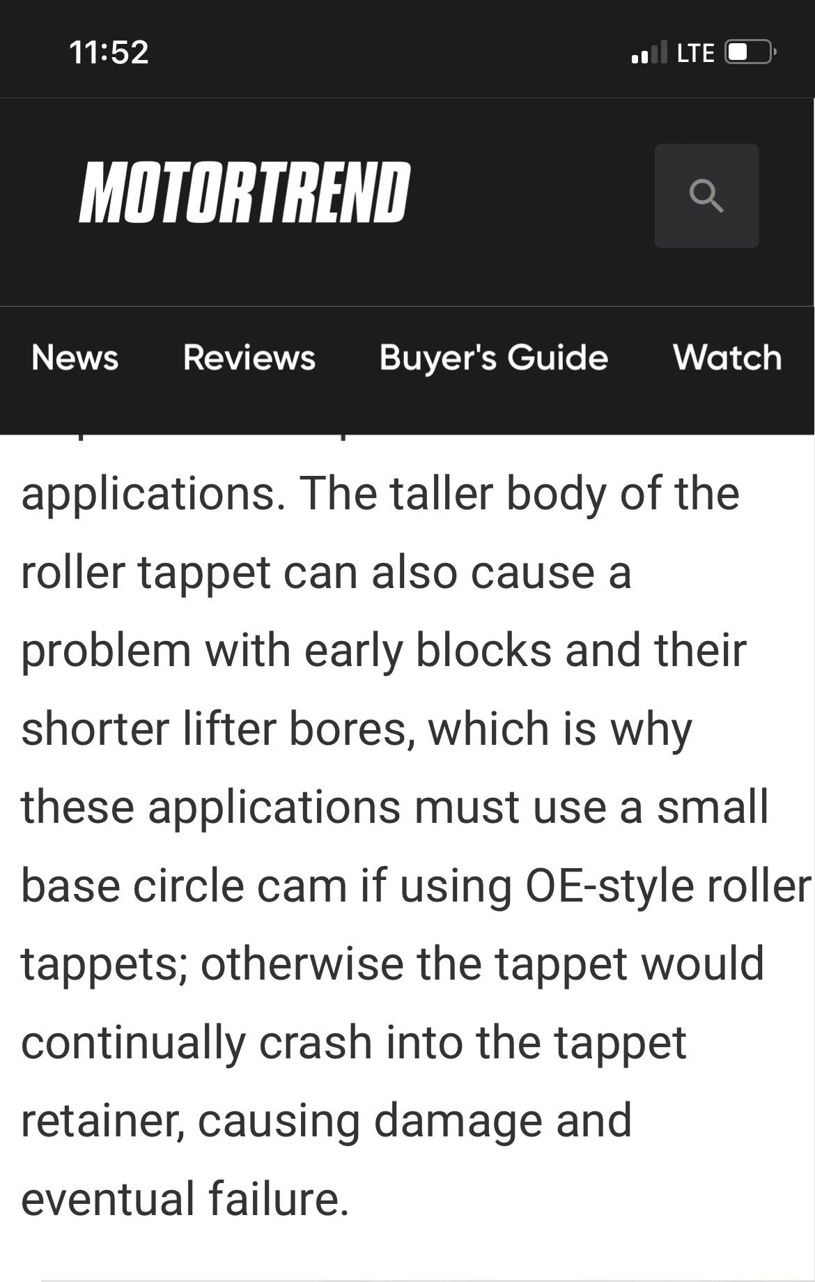

Old May 8, 2023 | 11:06 AM
Bills87IROC's Avatar

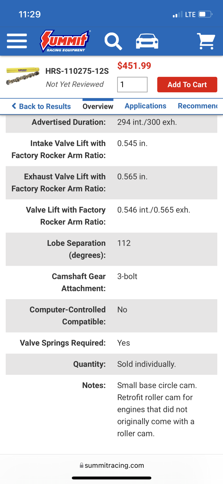

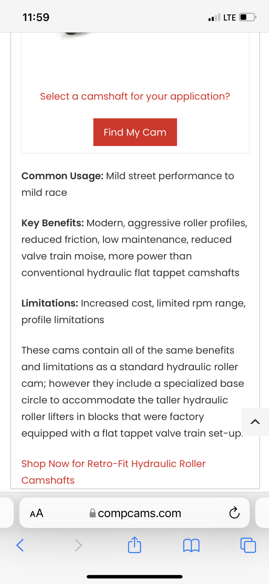

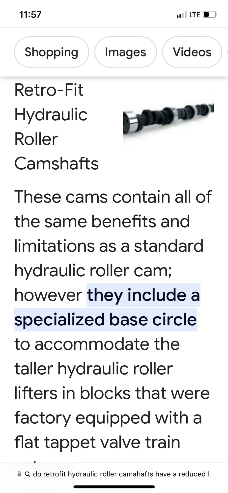

Old May 8, 2023 | 11:34 AM
Joined: Aug 2009
Posts: 62
Re: LS Firing Order in OE Roller SBC
Where are you seeing a spec that shows a different base circle?
I don't think that differences in the base circle would be enough to cause the lifters to slip out of the dog bones.
Every single retro fit camshaft I’ve ever bought from Comp or Howards had a reduced base circle. It says it right in the description.

Tom 400 CFI's Avatar
Joined: Oct 2000
Posts: 3,231
Likes: 806
From: Park City, UT
Engine: LT1, L400
Transmission: ZF6, T5
Axle/Gears: 3.45, 3.31
IDK. The link for the cam that you provided back in post #4 or so, doesn't say anything about the base circle.
On the one from your phone app, what is the "smaller base circle". The answer to your question is simply in the base circle spec for a stock cam, vs. the base circle on your proposed cam. What is the base circle on your proposed cam? :bigears

I thought the reduced base circle cams were offered for clearance purposes in stroker applications?

Since when? This is all news to me. But I've only been using retrofit rollers for around 30 years now; maybe I missed something?

They make small base circle cams for strokers, yes, but retro fit cams also have a reduced base circle.
Here it is straight from Comp Cams…

So....
"specialized base circle". What's the base circle dimension? :bigears

So you want to argue about it when even Comp and Howards both say they’ve got a reduced base circle?
