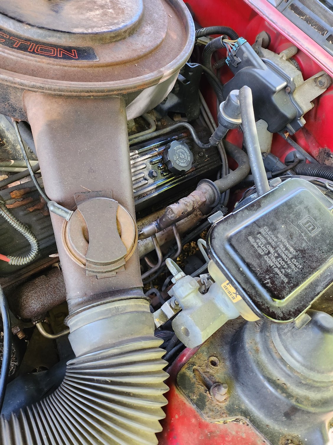

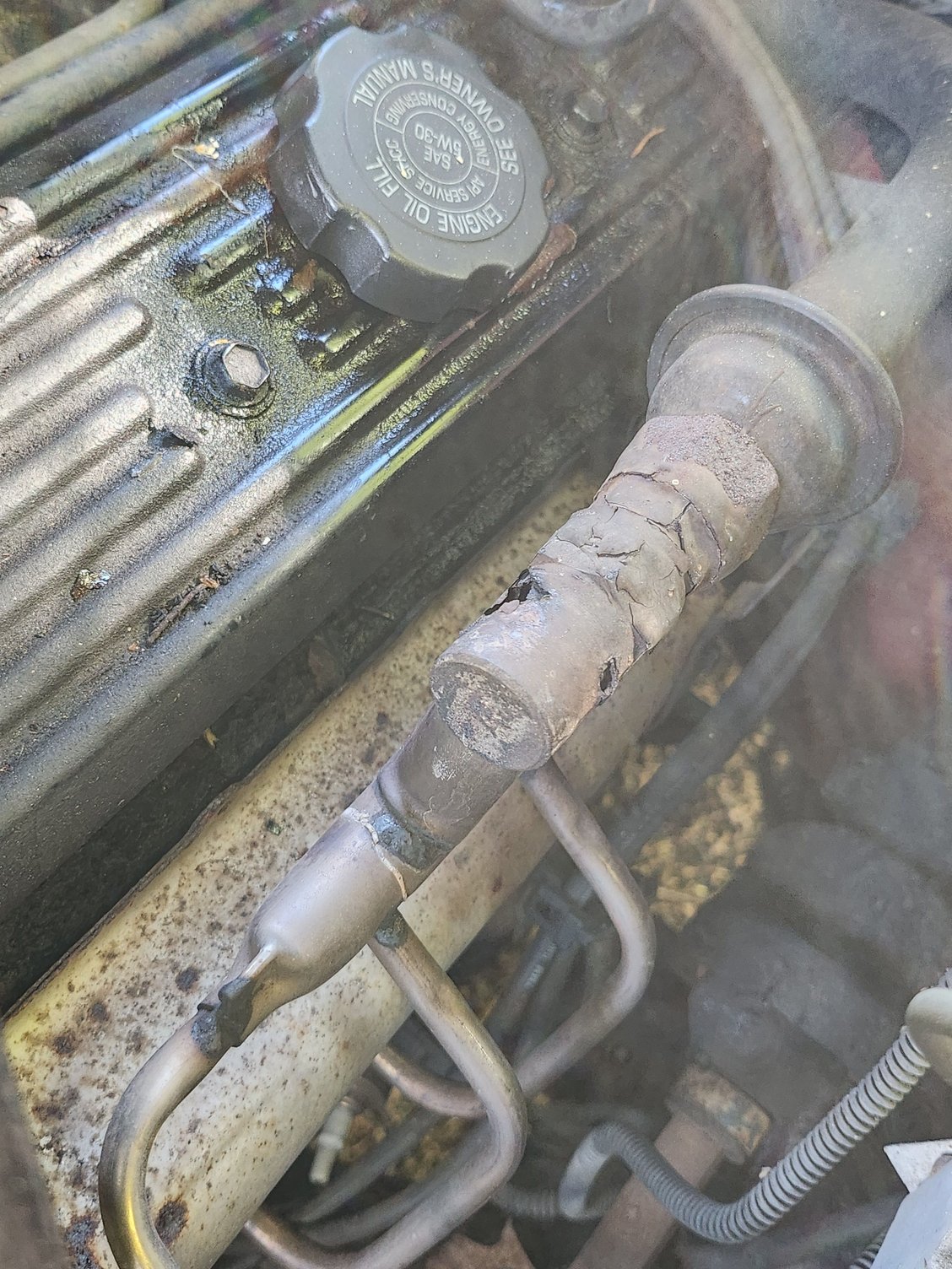

Hi guys this car probably needs more work than most people would consider doing to this rust bucket. However the car has sentimental value to me as it was a gift from my father who has recently passed. I'm going through the process of restoring her and I have a lot to look at without knowing a whole lot about cars. I basically just need help determining what this broken rusted through part is so I can get to replacing it, so long as it is that simple. I believe it is some sort of connecting fitment piece, and I'd assume air/fuel/liquid goes through it, but thats about all I could infer. Is it just a fitting that I can replace or is that going to be a bigger job than I anticipate?
ignore the spilt engine oil, whoops

Rockauto calls it an air injection pipe. Use flare nut wrenches on the tube nuts, I would also recommend penetrating oil and heat.

You'll need that check valve too. That's the piece that the rubber hose attaches to. It unscrews from the pipe, or at least, would unscrew, if the pipe was still intact and somebody hadn't put that exhaust dope stuff all over everything.

The tubes, check valve, rubber hose is all part of the emission air injection system (AIR) and is connected to the smog pump. The purpose of it is to blow air into the exhaust system from the smog pump when the engine is still cold to reduce emissions. Once the engine is warmed up to operating temperature, this air injection system does nothing.
I appreciate the information, I figured that piece was really ****ed up but I never would've figured somebody put that stuff on it. Is it some spray or goop to help reduce leaks or something to that effect?

https://www.autozone.com/emission-co...eld/710675_0_0
Kinda what Cletus and BillyBob would use under their shade tree when they blew out their cherry bombs... butt hay, sometimes it does what you need done

If you are going to remove it all, there's a good chance you won't be able to remove the tubes from the exhaust manifold.
Cut the tubes off about 1.5-2.0 inches long. Bend the ends over and crimp them off. That will be enough to prevent exhaust leaks.
