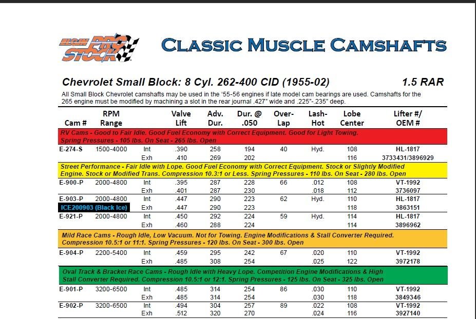

Current engine specs
350 bored .030 over flat top silven pistons
elgin cam kit ELGCL274K
which I believe is 1500-4000 rpm, INT lift .390 EXT .410 DUR @ .050 INT 194 EXT 202 Lobe center 108 116.
For just bolt ons would a set of aluminum heads and 1.6 RR add more HP?
The engine has 441 76cc chamber iron heads now, Edelbrock performer dual intake, Holley 625 street demon carb, Summit short headers, 2.5” exhaust all the way back.
I was looking to see if head swap and RR would benefit without having to pull engine?
If so what heads would you recommend?
I appreciates the advice of all you more seasoned engine builders.

That's a dupe of the stock cam. The legendary POS 929. If I was the least bit interested in "more HP", and was going to open up the motor to get it, it'd be the first thing that would go.
A "rebuilt" engine with those heads on it will have a compression ratio in the neighborhood of 7.8x. Which is probably partly why you're asking for more HP. I doubt it makes more than about 180 now. Would probably be 160 or so with stock exhaust.
What kind of budget are we working with? Why aluminum heads?
No need to pull the engine in any case if you don't want to.

From the cam specs it doesn't look like a lot of RPM will be involved.
Based on that, and from personal experience with a smaller cammed 350, the best bang for the buck will be probably be a set of Vortec heads.
With the low lift involved, the Vortec could be used right out of the box. Stock springs, pressed in studs and all. I did it with great success.
You'd benefit from the higher lift of a 1.6 ratio rocker as well. Even with the increased lift, you're still within the many times confirmed guidelines for maximum lift. You may find yourself having to enlarge the pushrod holes in the heads as the increased ratio will change the pushrod path somewhat and could bind. This would be with self guiding rockers as it was designed.
There are other routes but for an inexpensive upgrade with minimal work, this is a well worn path.
Besides the better flowing heads, you'll also get a needed bump in compression as the Vortec heads are 64cc.
If you want to get more involved you might have to provide more detail on the engine spec. Do you know how far the pistons are down below the deck? Is there a piston part number? Valve notch cc is handy to know. Have you timed the cam on installation so you know the intake centreline is confirmed? Speaking of cams, I couldn't find that part number. Maybe a typo?

The cam # is from the build sheet of machine shop. It’s a Elgin cam kit so I was just looking it up and trying to break out the cam itself from that part number. Pistons are silv-o-lite flat top 4valve relief.
I got this when we bought the engine. I only paid $1200 for engine. Hind sight always 20/20 and should’ve done more before dropping in but am in the learning process and for me it’s like tearing apart 6 or 7 times before it’s right.

Yep. Definitely a top of the page cam. It'll be up to you if want to upgrade that but as mentioned, it's pretty weak and the benefit of upgrading the heads won't be realized unless the cam is bumped up with it.
That said, the heads are certainly worth doing regardless. Even if only for the bump in compression.
And as in most hot rodding, tearing it apart 6 or 7 times until it's right is part of the process.

The "180 cc" has nothing whatsoever to do with compression. That's the intake port volume. Stock intake ports are in the 160 cc neighborhood; aftermarket ones for SBC go up to around 230 or so.
The numbers having to do with compression are the combustion chamber volume. They're generally in the 60 - 75 cc sort of range. 64 is a very common and usually appropriate number.
Those 2 numbers are completely unrelated. In fact, many of the head mfrs offer the same model of head in every possible permutation of port vol & chamber vol that they cast; for example, 180 cc ports w/ 64, 70, or 76 cc chambers, 200 cc ports w all 3 size chambers, etc.
Aluminum heads REQUIRE about a point higher compression than iron, ceteris paribus. To put the numbers you'd be needing to look at into perspective, a set of 64 cc heads on a typical rebuilt .030" over 350 with 6 cc valve-relief flat-top pistons with the usual stock .025" of deck clearance PLUS the added .020" that virtually all "rebuilder" pistons have, you'll come up with 9.2 - 9.3 compression ratio. Ceteris paribus, you'd need 10.2 CR with aluminum heads, more or less, which will require chamber volume around 54 cc. AFAIK there isn't any such thing.
Which is why I asked, why aluminum. Given the handicaps you're starting out with, not the best choice.
A typical "better" choice that will fit your intake would be something more like Dart Iron Eagles, such as these https://newdart.wpenginepowered.com/...-Sheet-H06.pdf in the 64 cc chamber size. Incidentally they make this series of heads in 165, 180, 200, 215, & 230 cc intake ports as-cast, with 64 or 72cc chambers. I'd recommend a Comp XE262 cam & matching lifters along with them. Buy the heads fully assembled, with the upgrade spring package (1.44" OD) included. If you really want roller rockers my suggestion would be Comp 1601.
I've never used Flotek heads. No idea whether they're any good or not. Dart however is a very long-time familiar mfr that I've used many times before over many decades, with good results. Probably not the cheeeeepest, let alone least expensive, but reliable, and they PHYSICALLY ANSWER THE PHONE when you call them. They're up in the Detroit area.

​​With 64 cc chambers, a piston waaaay down (see what I did there) at like .030" and an .026" head gasket will get you close to 10:1.
Something in or around how one of my 350's was built using Vortecs and a flat top Speed-Pro piston measured at .029-.033 below deck.

As for the cam, you owe it to yourself to think long and hard about that.
Whatever heads you decide on, I'll bet you're just not going to be happy with the outcome.
That cam is very limiting.
