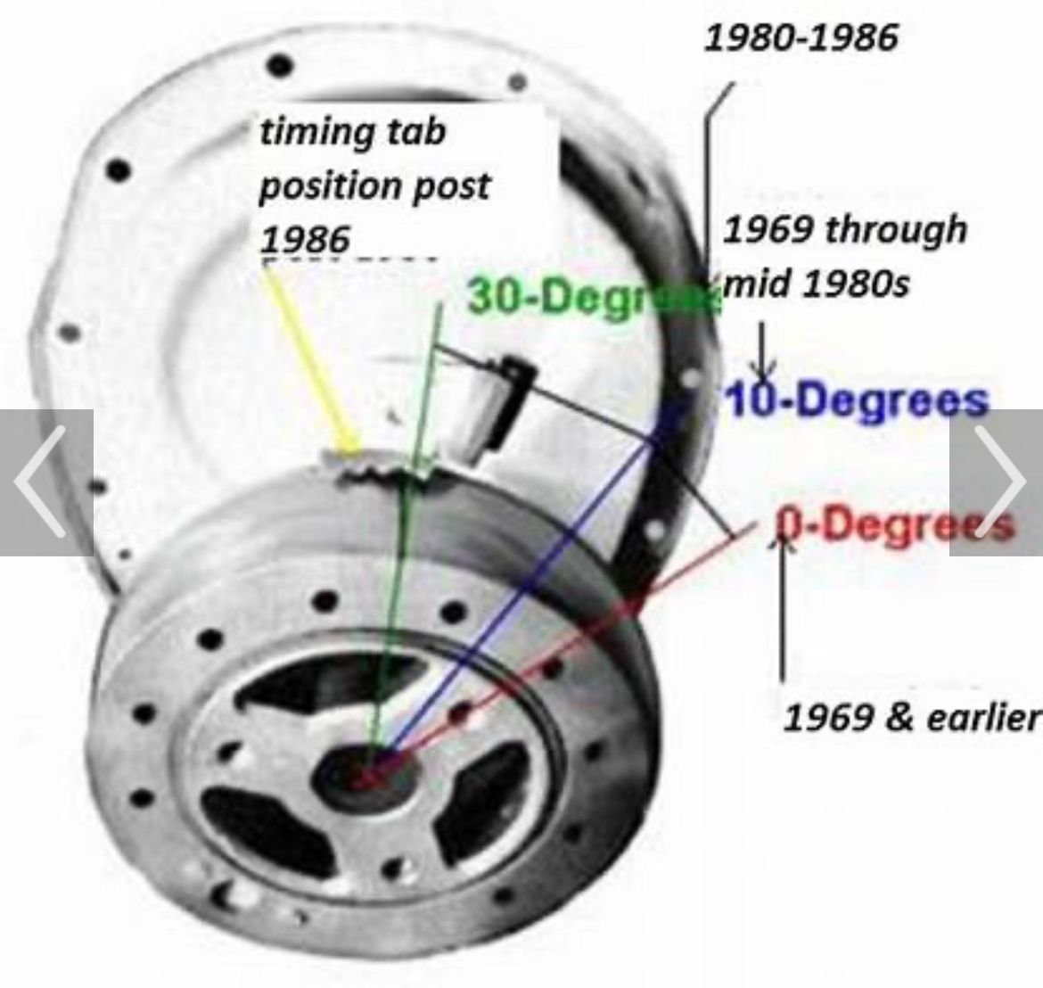

Might measure it 6 3/4 or if it’s a 8” . If the cover is off the 86 305 get a matching balancer in the size measured. Gm12551537 is a 6 3/4 I think timing cover had marks like picture. For 86

Right: you need the one that the mark lines up with the tab real close to 12:00. They put it there because the PS pump in a front-steer setup is RIGHT DRIECTLY IN THE WAY of the old location. You look down between the water pump and timing cover to see it.
