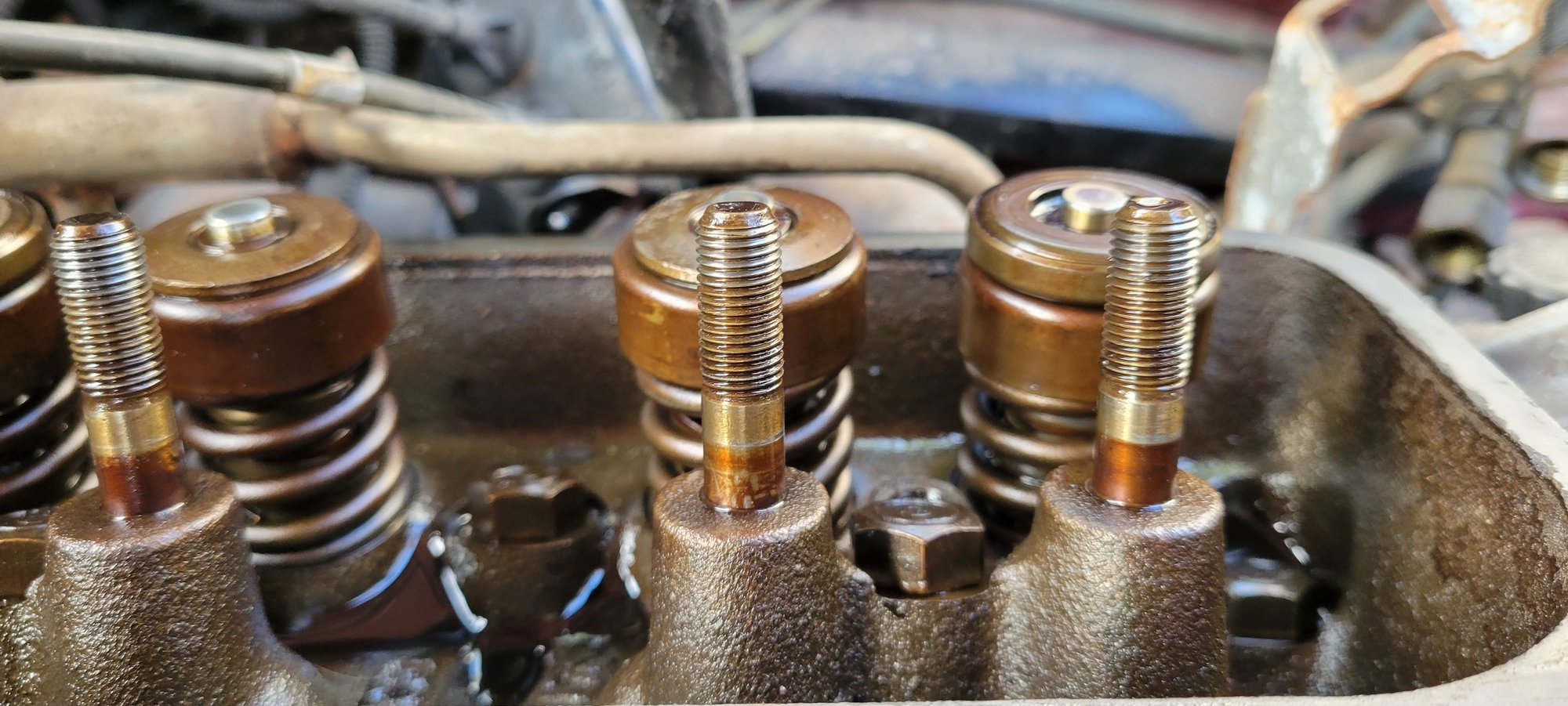

I don't think so. And all of the valve springs look correct except the very last one has a different type of top piece

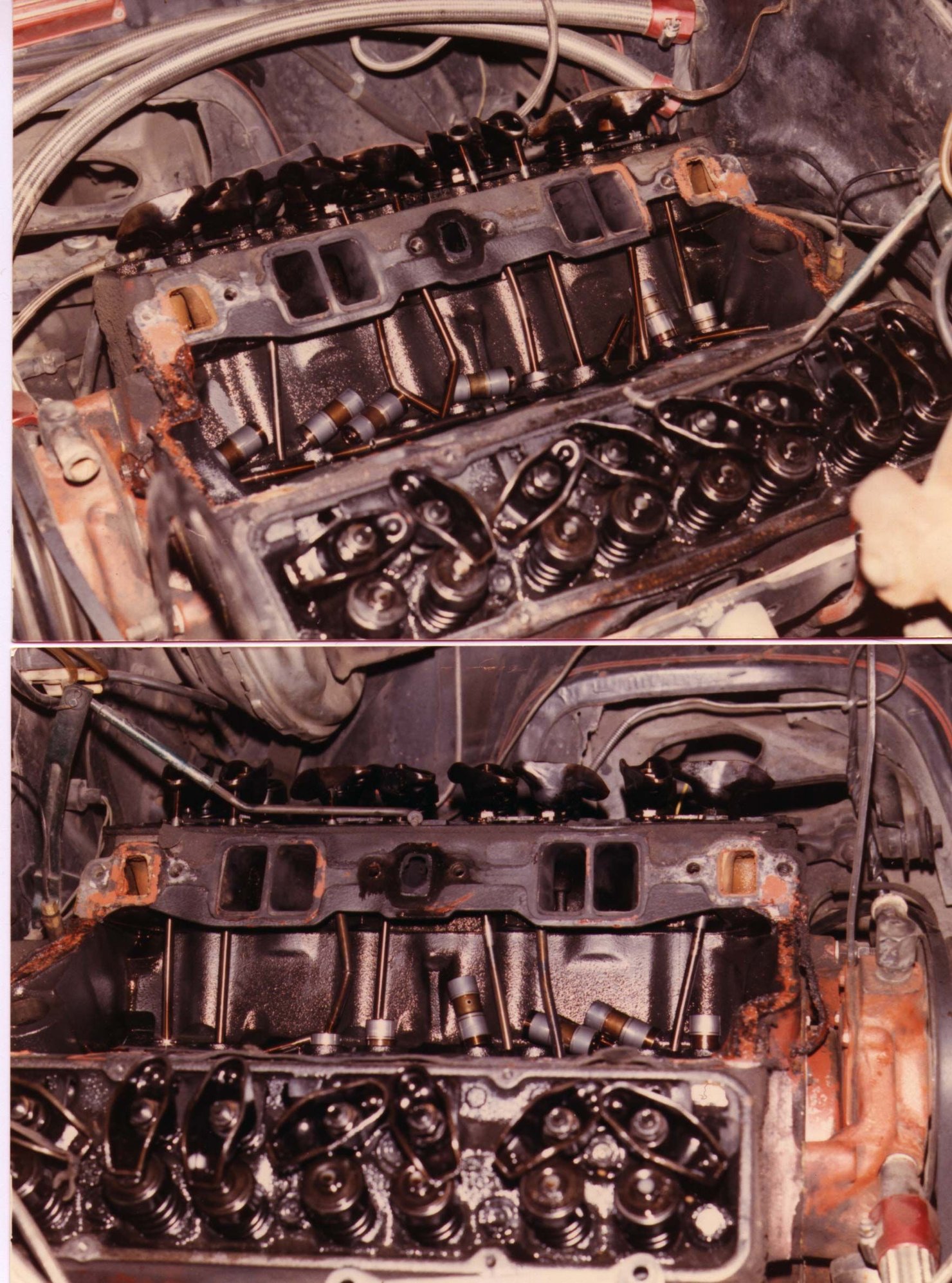

Those all look completely stock and all the same to me, except for the one exh valve at the end of the head that's missing the oil splash shield. Which is OK in and of itself; I always throw those away anyway, along with those stupid "rotators" on the exh valves. But it does point toward maybe somebody has been working on it: I don't think I've ever seen one missing from the factory although I suppose almost anything is possible like that.

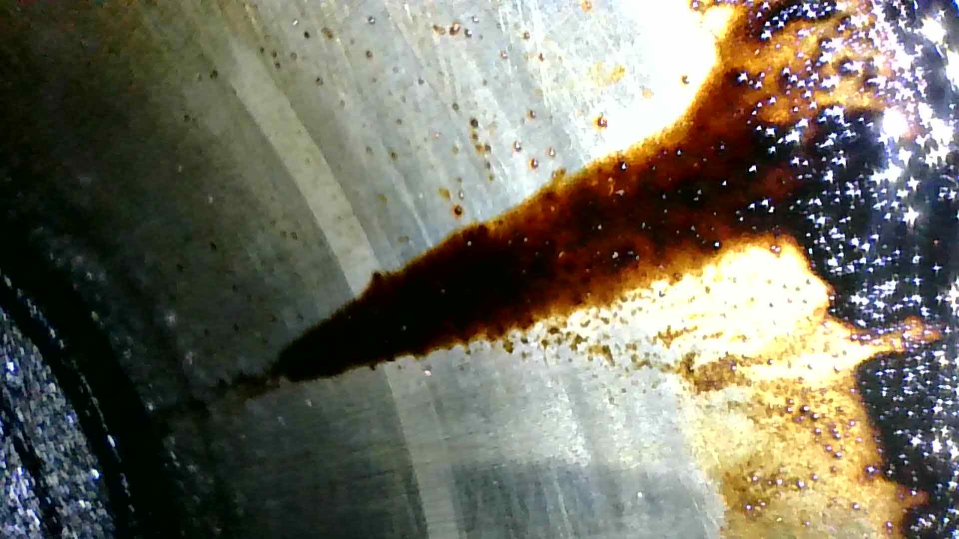

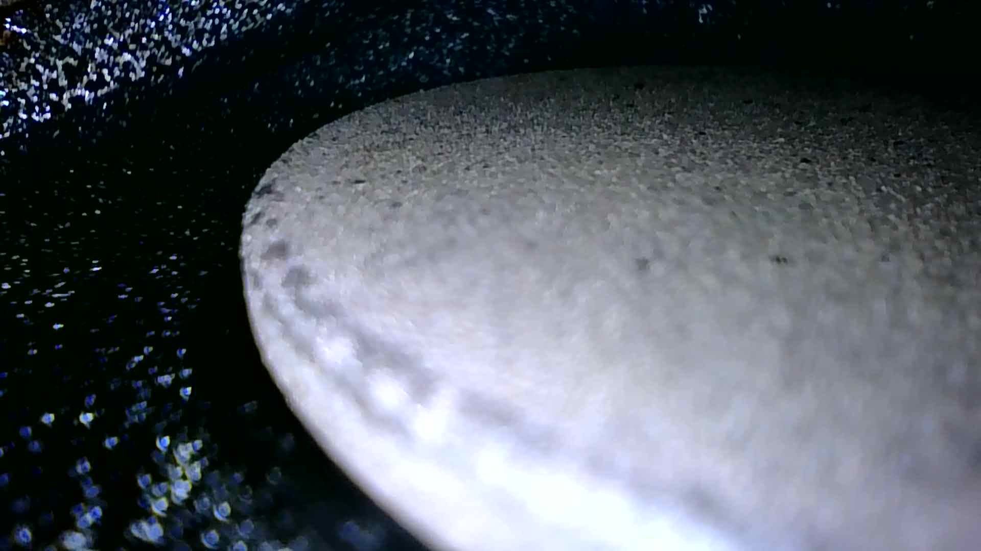

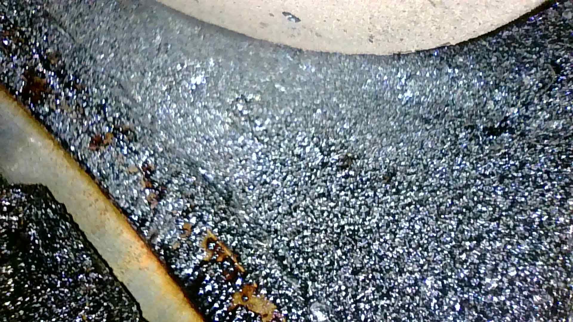

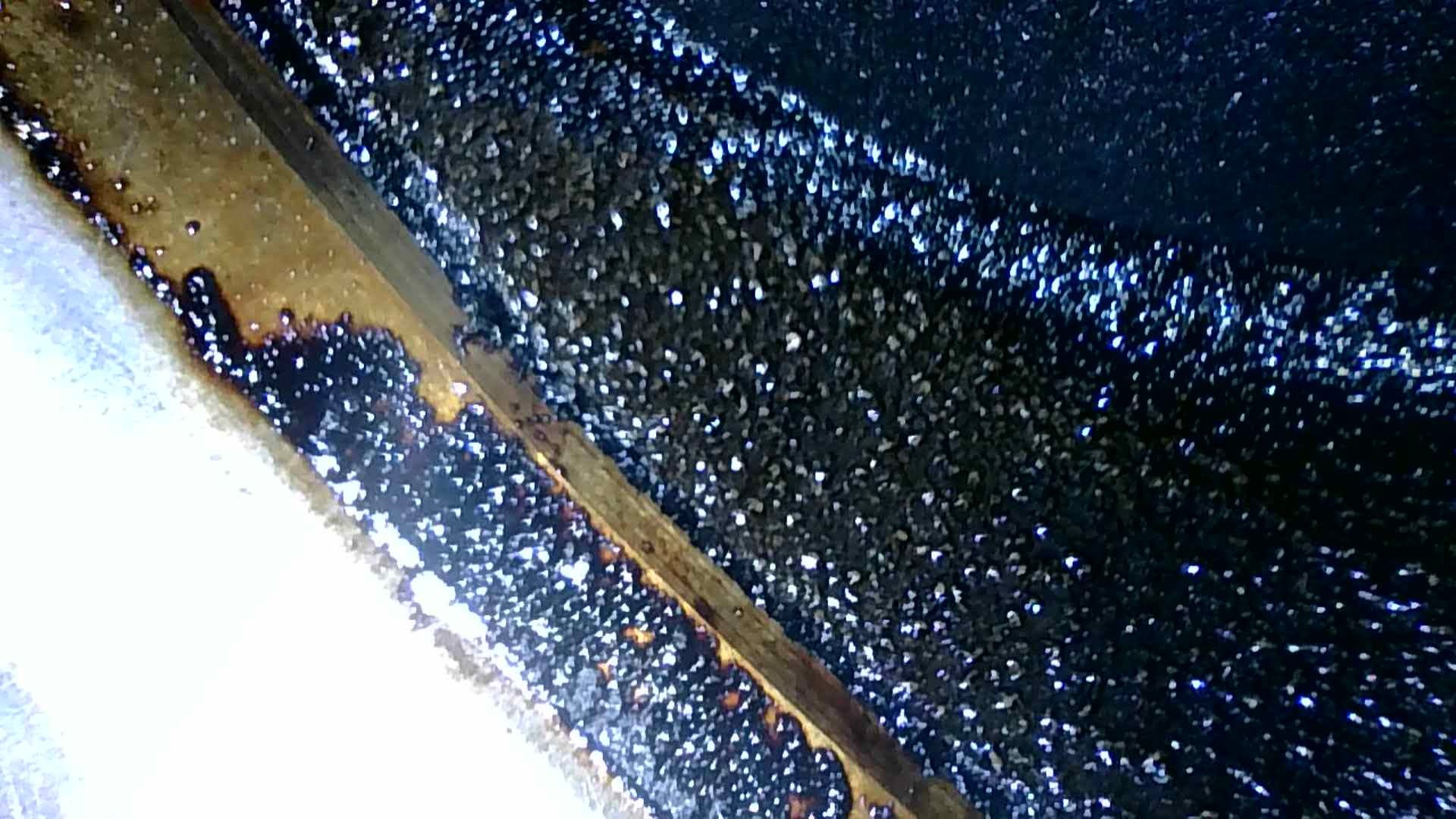

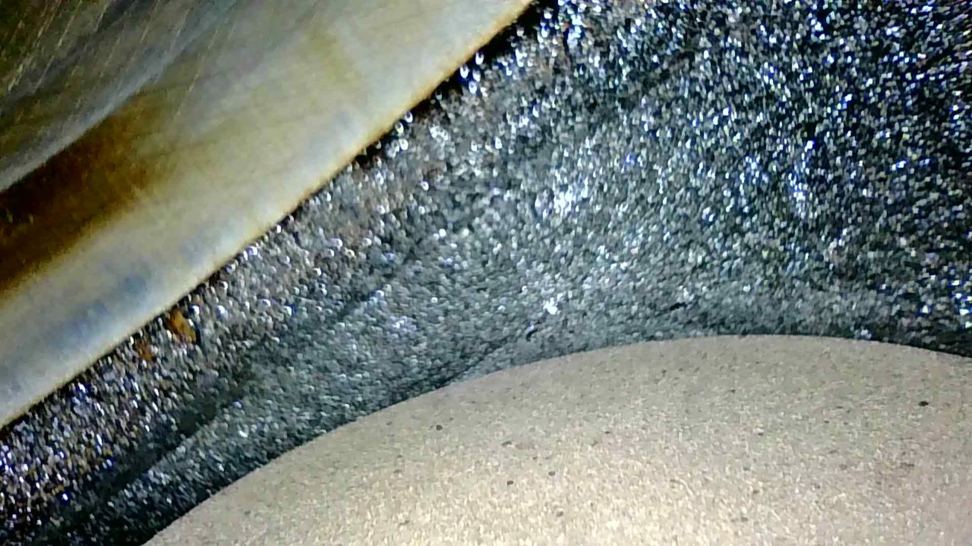

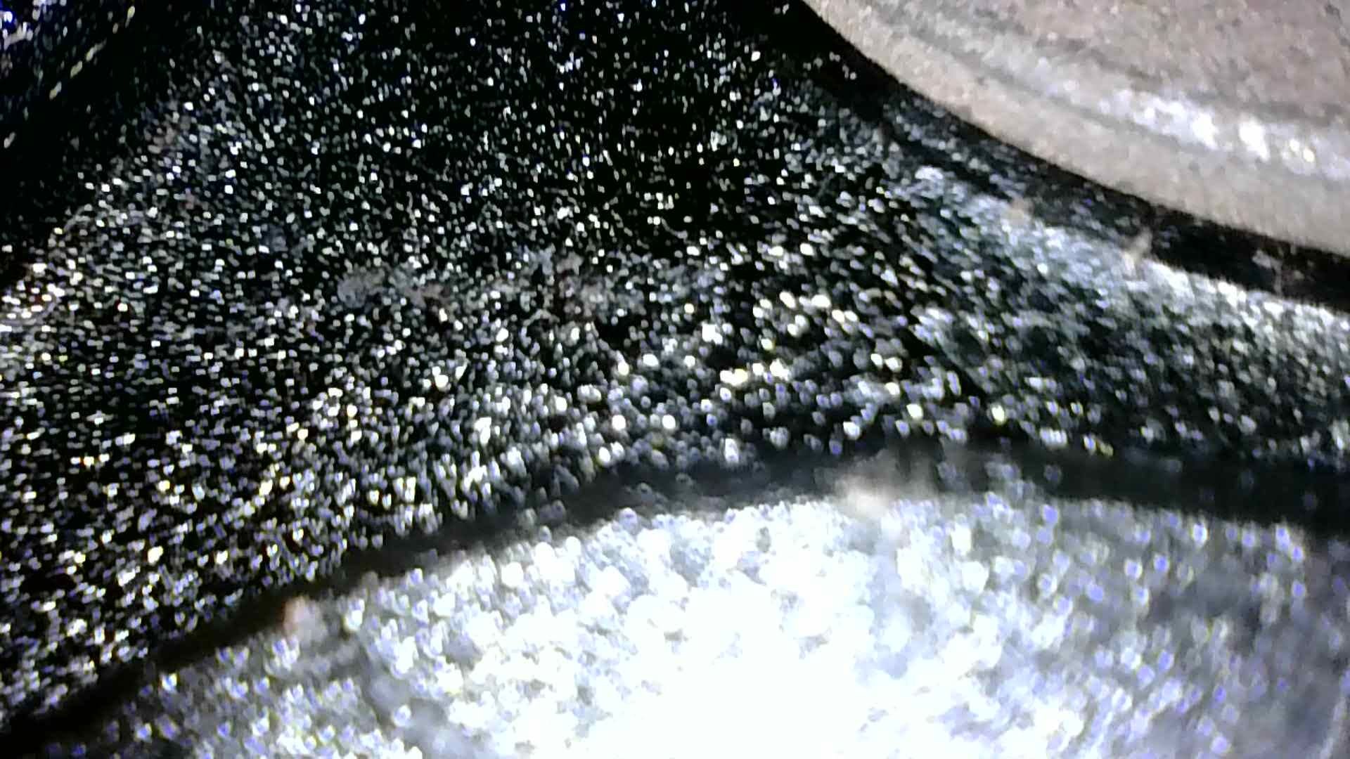

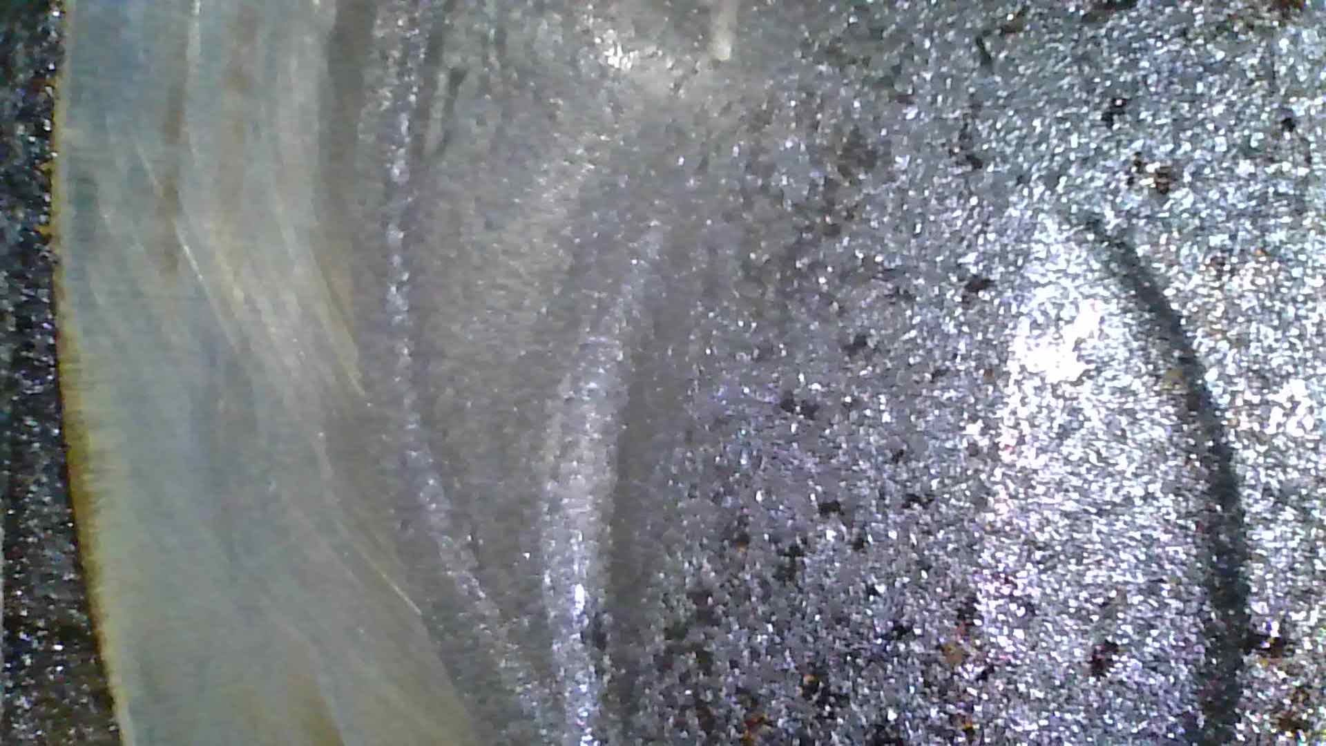

SO I can only get the first 2 plugs out on each bank. Not sure how anyone is supposed to get to the others lol. Here is a pic dump I just took with a scop camera. It's hard to get a good pics in there. The cyl walls and pistons look great to me and the valves appear to be super clean with one being clean and dry and the other wet with carbon. The pic of the puked oil running down the cyl wall I THINK is the offending cyl with the bent pushrod. When it cools down a bit I'll try to get more pics of that cyl. I think both valves are wet with oil though.

I'm not about to suggest anything for the root cause but I will ask that you put a break between pictures and a description of what it's a picture of. It makes it much easier to digest.
Can you spin the engine over with all of the rocker arms loosened off?

Yeah my apologies, I realized it would be jumbled. I tried to turn it over with 2 plugs on drivers side removed and only the 2 front rockers. No turn on the crank with a breaker bar. I'm going to remove everything on the pass side and try it again.
I'm working on a very sloped driveway and the car is really lowered so I don't have the luxury of a flywheel tool. I'm looking for a flat place to work on it now.

Thanks for the pictures.
I think that I see a partially stuck open exhaust valve. But it's really hard to tell with all that tar in the cylinder.

I went ahead and pulled the rest of the pushrods, rockers and lifters out. There was a loose rocker arm on the passenger side. Cyl #4 but the rest were tight/snug. I pulled the timing chain off and tried to spin the motor over via crank bolt. Nope. I'm beginning to wonder if the trans is coming out of gear. I need to get the car flat and get under it. If I can get the headers off, I will pull the heads.
