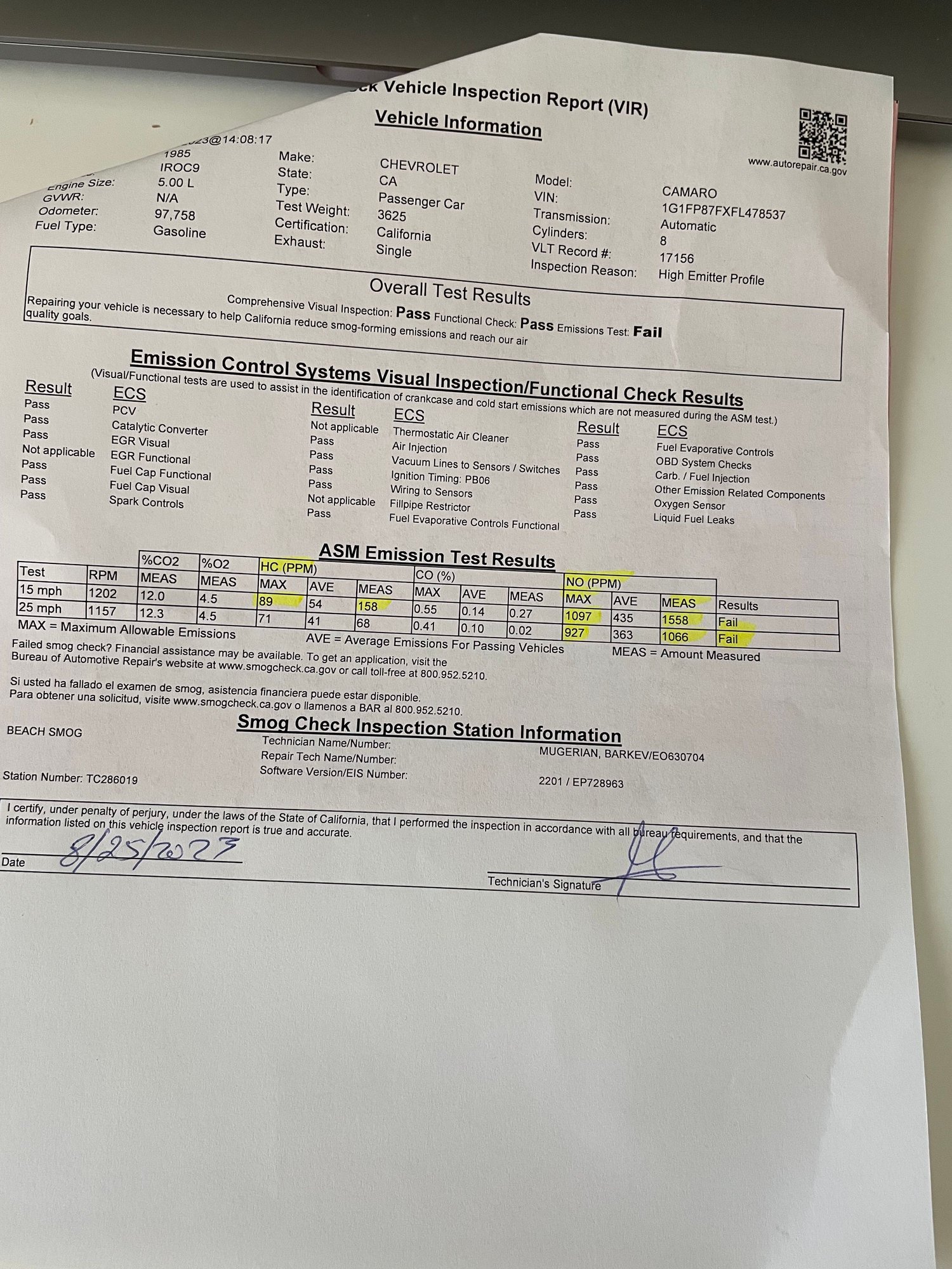

Failed CA Smog - high HC and NO
my 85 didn't pass smog this year, appreciate any help from those with recommendations to get it to comply

so my question is, the ave & max are those specific to your cars year, and engine? or is that what they require for all cars in '23?
I would look at your last smog test and see if or by how much it changed.

Should be based on the year the car was built. Those limits look pretty similar to the limits for the emissions test here in CT for my 1989 back when I had to test (it’s now exempt due to age).
If all of the emissions equipment is in place and working, tune up parts are good (plugs, wires, cap/rotor, etc), timing adjusted to spec and the motor is healthy, no reason it won’t pass.
So, need to start narrowing it down. Make sure it’s in good tune, everything adjusted properly. Does it have a catalytic converter installed (and not hollowed out)?

Looks like it needs a new catalytic converter. Either it's gutted, or blown out the tailpipe, or just removed and replaced with a piece of pipe. That's where I'd start.

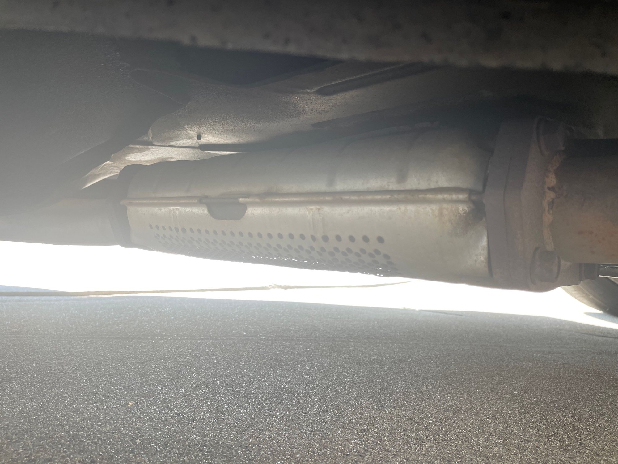

The cat on this thing in 100% original and no one has modified it as I dropped the exhaust and it looked good 2 years ago when I did the fuel pump. A couple of things that I know need attention are the temp gauge is pegged past H and there isn't any melted wire on the sending unit. So I don't know if the gauge is shot or I have a ground short?

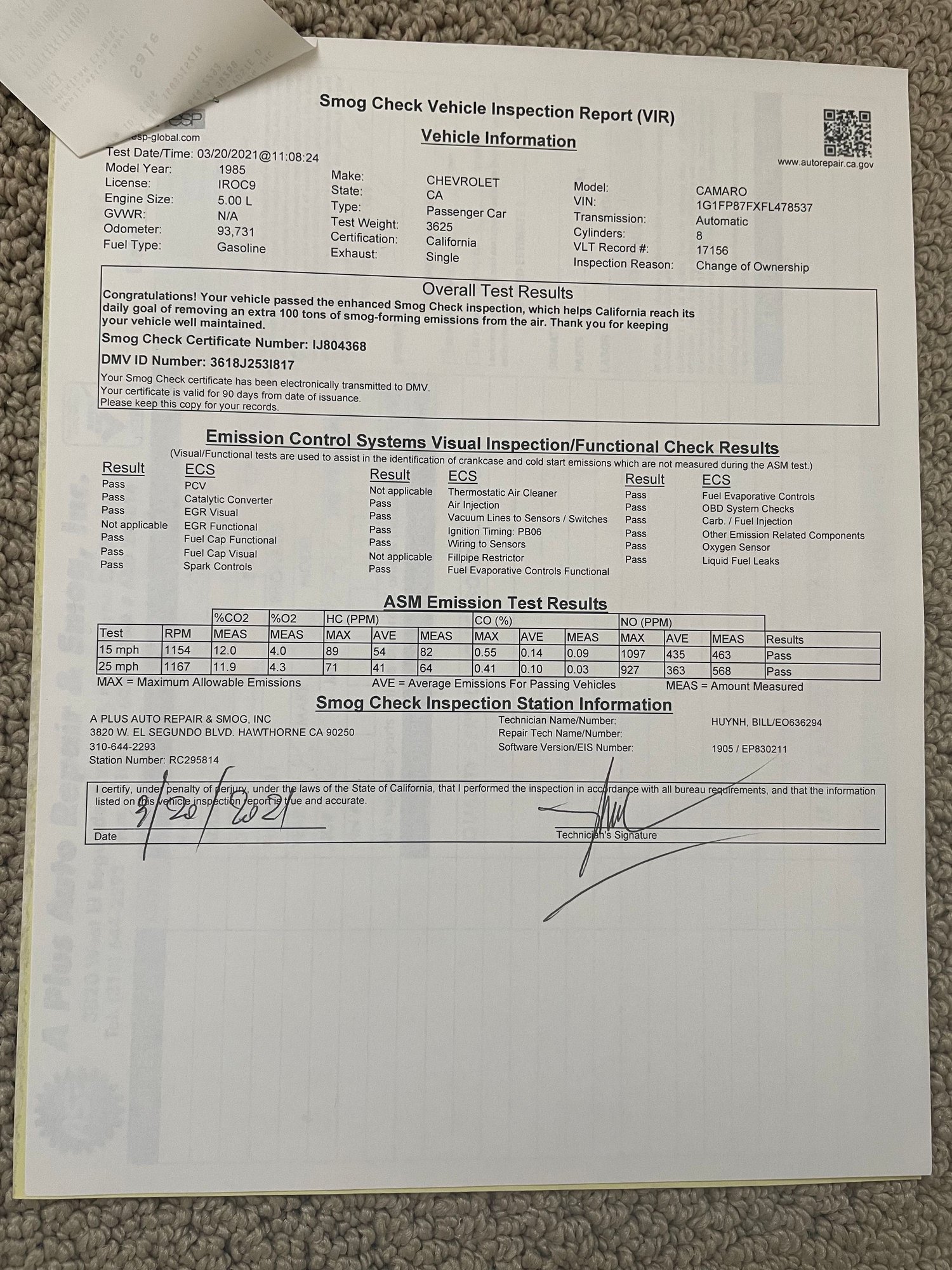

Here is last smog too as requested two years/4000 miles earlier

The fact that it passed the smog test 2 years ago is promising. Still would be looking at the cat. Might have been fine 2 years ago, but did it disintegrate since then? May be worth disconnecting the intermediate pipe and having a look to see if the honeycomb is still there. Even if the honeycomb is there, it just might be spent and needs replacement.

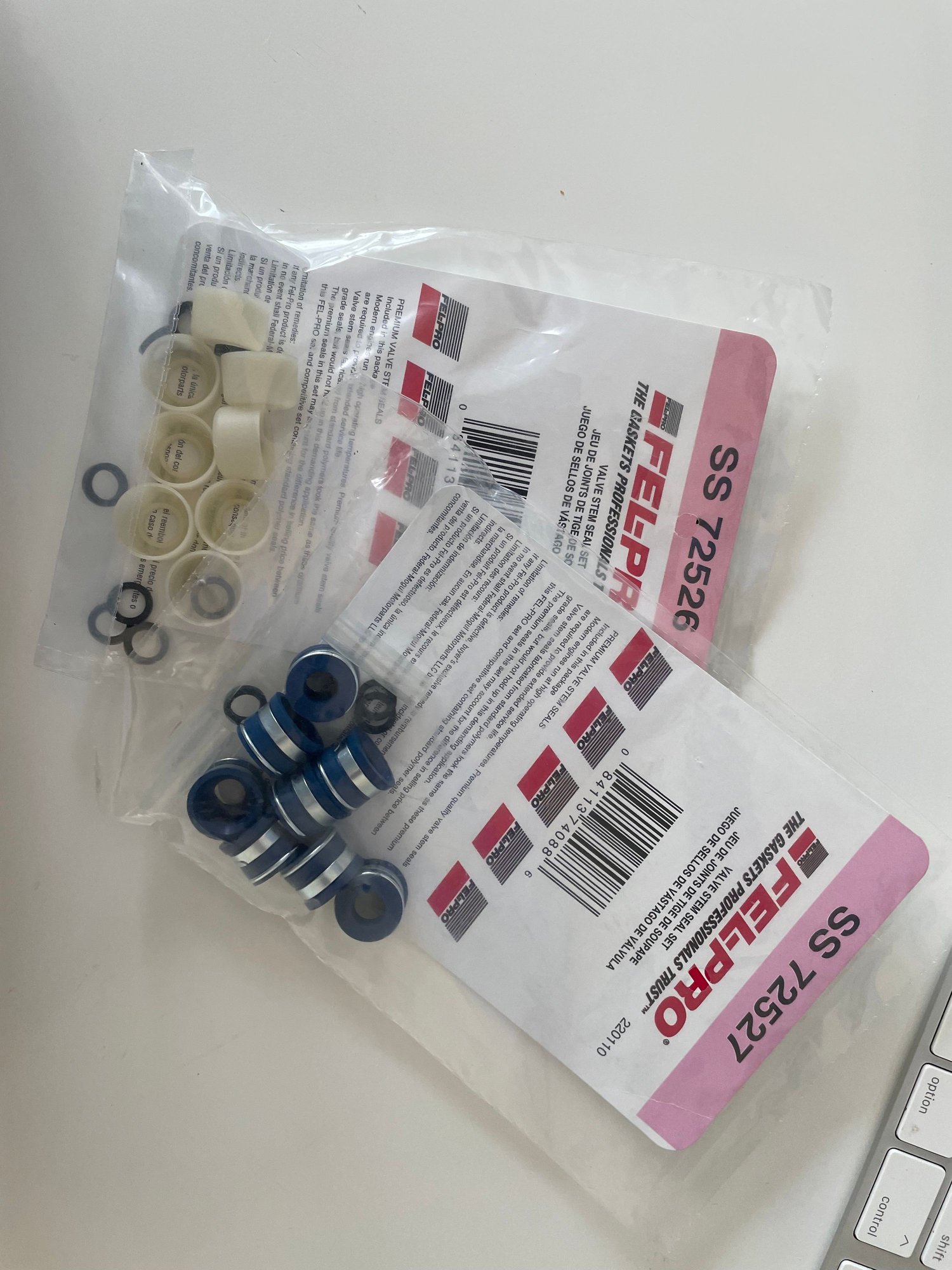

What kind of valve stem seals did you get?
If they're not the "positive" type, they will be a complete waste of time. They need to look something like these. https://www.autozone.com/external-en...418/134325_0_0 They're available from several vendors including FelPro and Victor-Reinz, and you can get them from just about anywhere. Use them on both intake and exhaust. Don't waste time and money on the O-rings, or on the "shedder" or "umbrella" type. Once the valve guides get a bunch of wear, as always happens over many tens of thousands of miles, they are totally ineffective.

Those look like the FelPro ones as this is what I bought back in January -
Old Sep 2, 2023 | 10:43 AM
Posts: 27,899
Likes: 2,437
Re: Failed CA Smog - high HC and NO
Yes indeed: the ones at the bottom of the pic are the type I'm referring to; the ones in the top half are "umbrellas" and O-rings, and therefore useless.
The makers of these things base their int/exh listings on 2 things: (1) what the factory did on certain later engines WHEN THEY WERE NEW, and (2) what works and is effective on LIKE NEW engines. A motor that has valve-guide-seal smoke is NO LONGER a "like new" motor. "Like new" no longer applies. Use "positive" seals on all 16 valves. There's vacuum in the exh ports over various parts of the engine cycle, therefore oil can be drawn into those ports, and cause smoke, like the int valves, once the guides get worn enough.
All that the O-rings do is to keep oil from running down the valve stems off of the top of the retainer. Umbrellas are better at shedding oil off of the stems but do NOTHING about vacuum on the other side of the casting, sucking oil around them and into the guides. That condition doesn't occur in a "like new" motor.

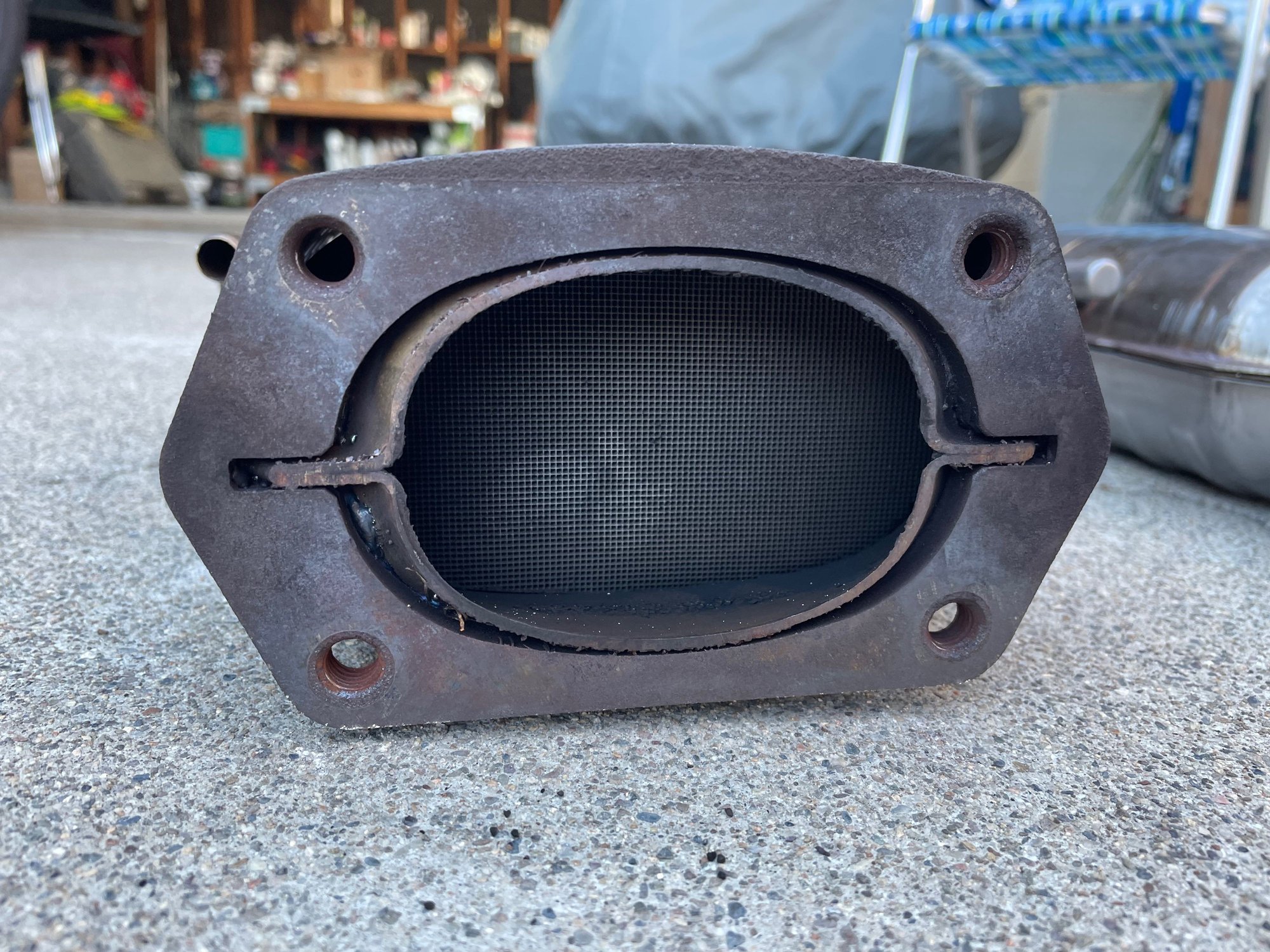

It is probably a blown cat as exhaust sounds more throaty and I can smell lots of fumes, I ordered a new cat from Rock Auto, comes next week for $500

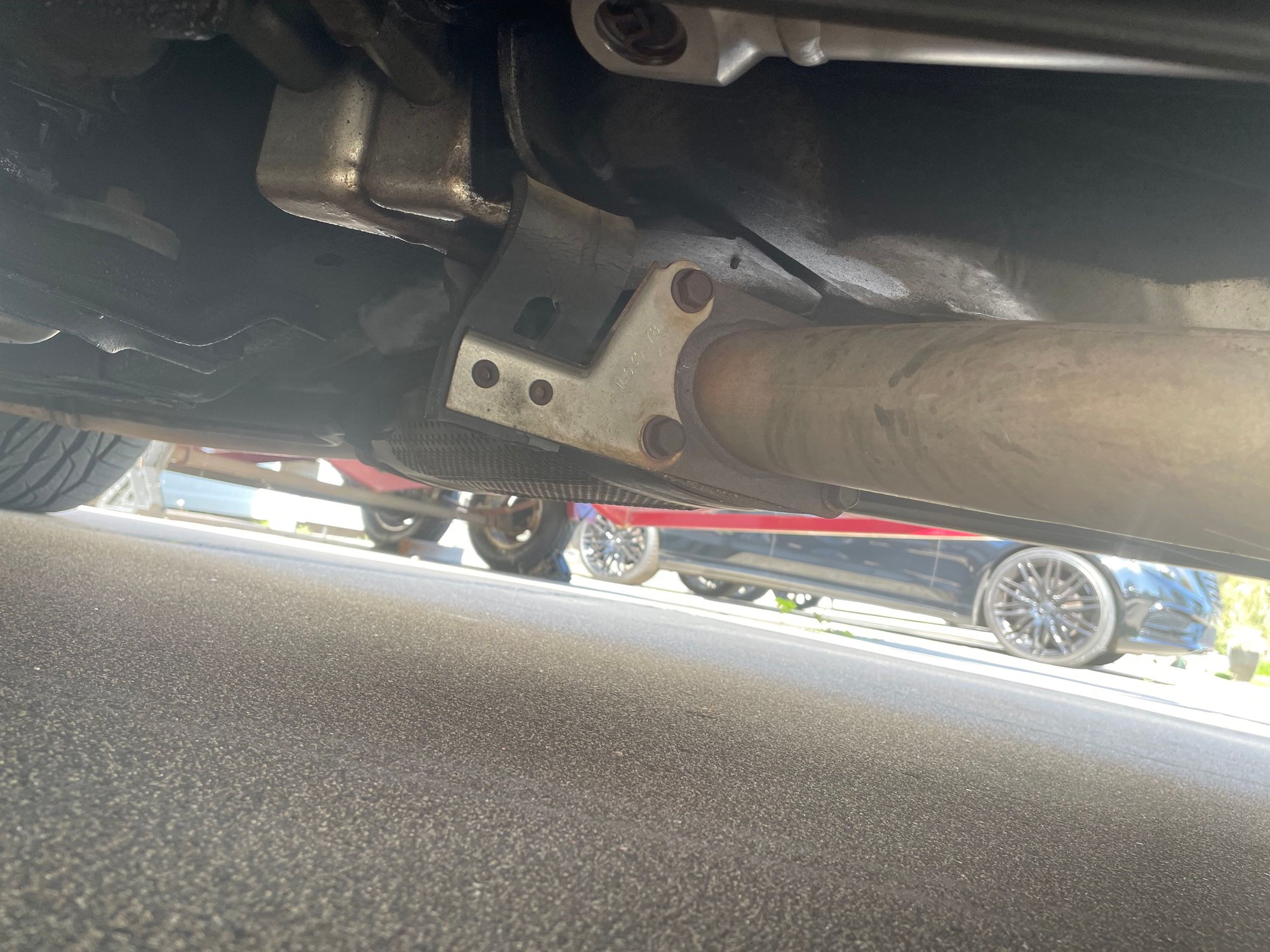

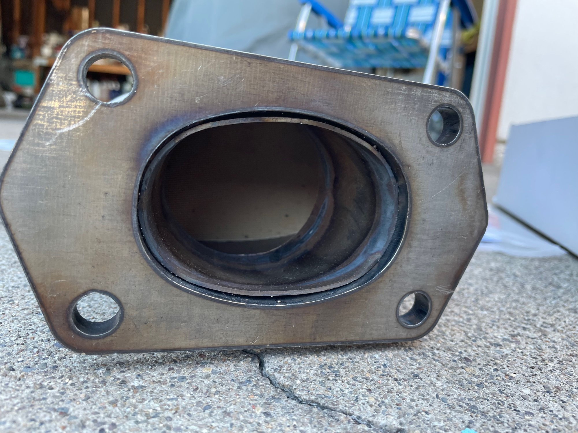

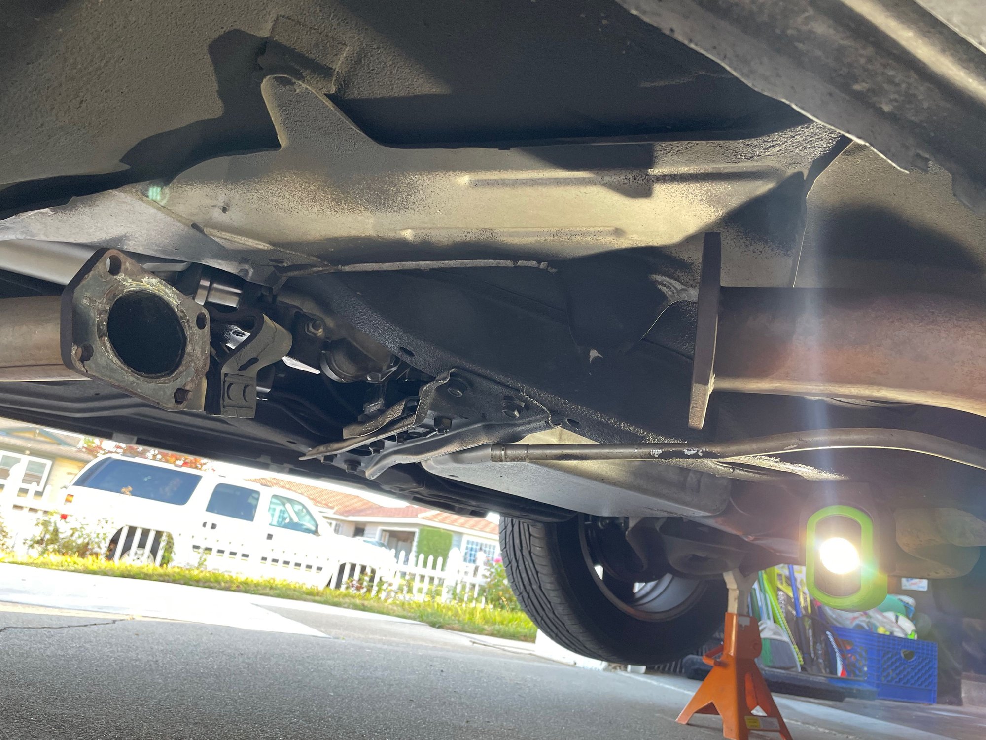

Guess I should have done some more research and stuck my head under the car, I have a early model cat design and this isn't anywhere near that for a F 305-215 (LB9) with those flanges. So the RockAuto one is going back ugh, shipping cost loss on my part. I did some digging too on old posts and saw your recommendation from Summit @sofakingdom for a Magnaflow bolt on and some graduate level fab and welding skills - https://www.thirdgen.org/forums/exha...aders-nos.html
However looks like the only one available that is bolt on from Summit is like $1400 - https://www.summitracing.com/parts/m...maro/year/1985
https://www.magnaflow.com/products/3...verter-3322440

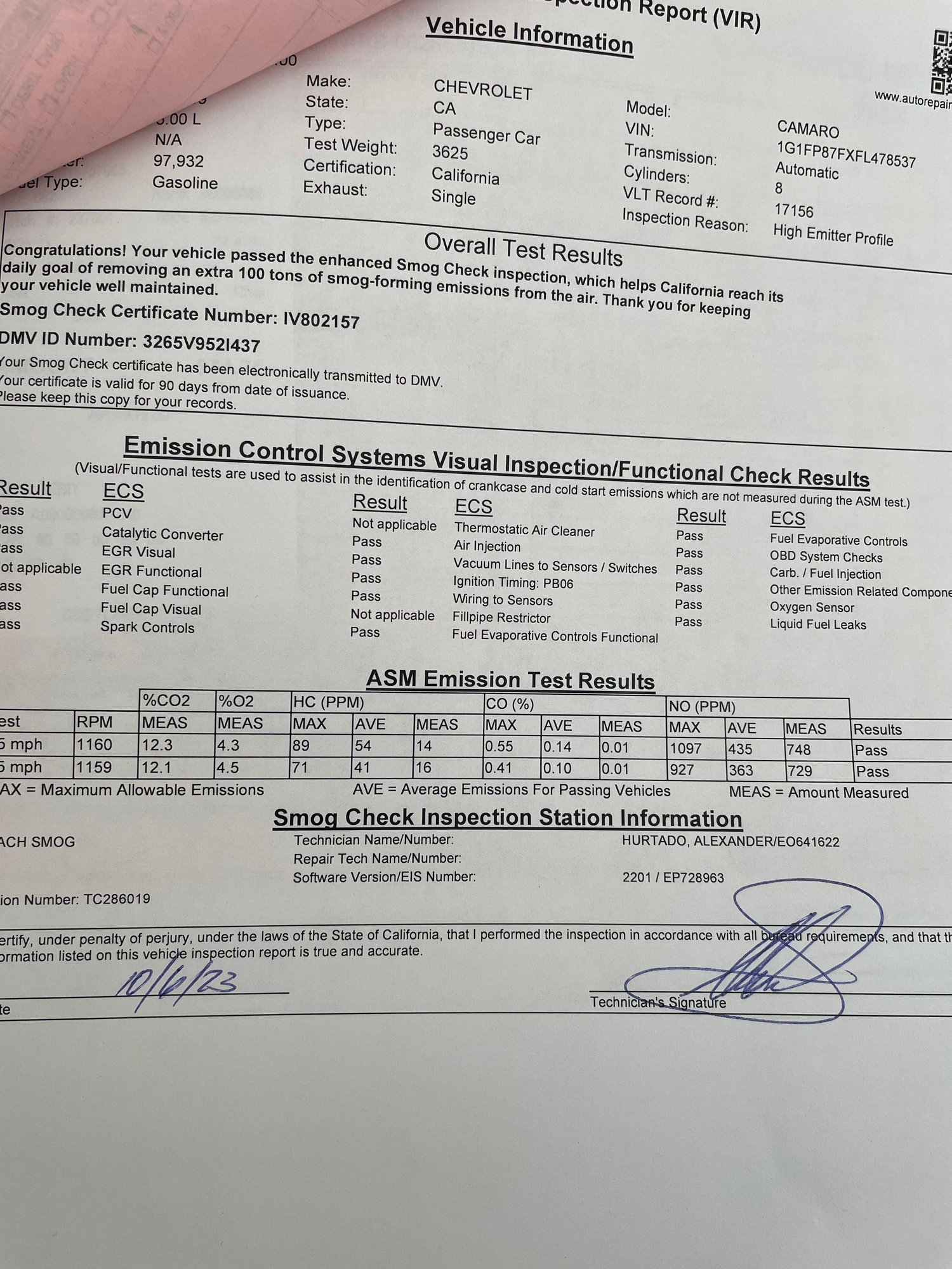

PASSED!
Runs smoother and has a bit of a performance uplift, more throaty sound and don't smell fumes like previous so guess it's doing the job.

The NO content seems a bit high since 2021 -
15mph
2023 - 748ppm
2021 - 463ppm
25mph
2023 - 729ppm
2021 - 568ppm
Would assume this is EGR performance?
Good deal you got it to pass. The original catalytic converter was just spent.
NOX in the 700's is where mine would test, when I had to still test it. Maybe the EGR system isn't working 100%, but I wouldn't worry too much about it. Check to make sure all of the EGR-related vacuum lines are intact, solonoid electrical connector plugged in, but that's as far as I would go for now. If you have another reason to take the upper intake plenum off, then replace the EGR valve at that time. I wouldn't tear it apart now just to change the EGR valve.
