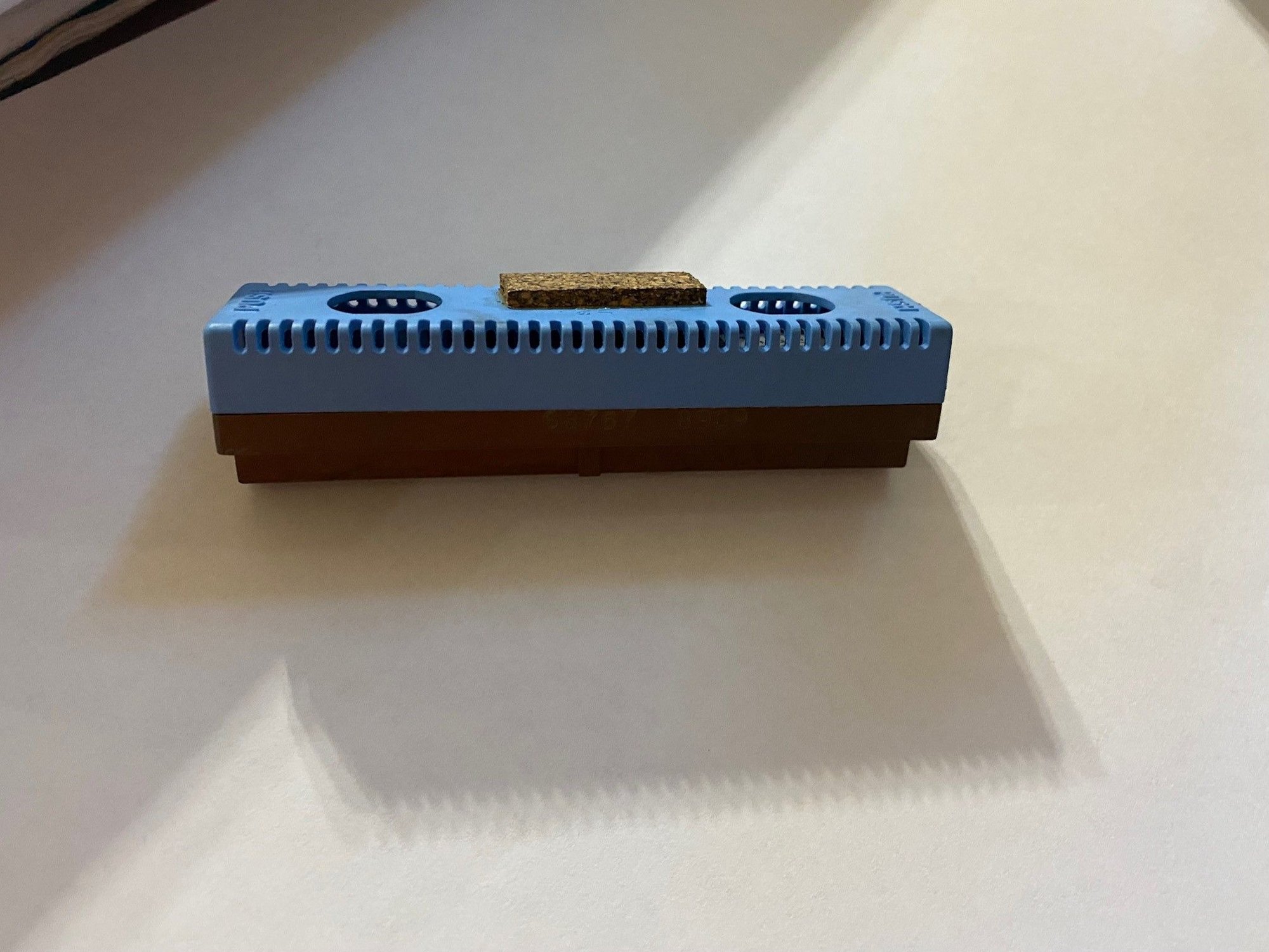

I'm reading conflicting information about replacing the ECM and PROM. Mines a 89 Firebird GTA w/ 5.7L TPI so if I'm understanding it correctly, the ECM is not vehicle specific. As I understand it this vehicle has a specifically programmed MEMCAL, PROM and CALPAK? Where is the best place to order these? Thanks
K?
K?
how did the spark plugs look ? What kv was the coil able to produce for spark ?
if around 40 that’s not your issue. The 1227165 ecm was used on corvette and f body the memcal is the difference and they rarely go bad. You have spark and injector pulse the ecm doesn’t sound like it’s the no start cause. And possibly stuck injectors as mentioned.
