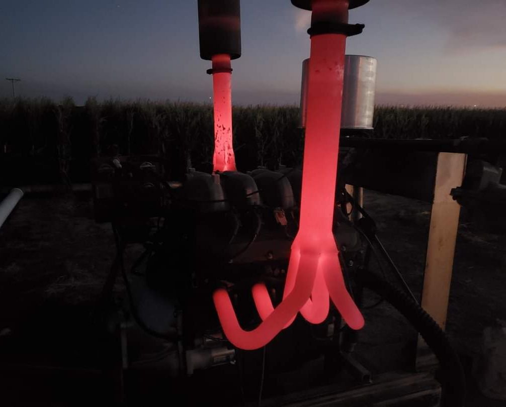

Why a generator is relevant. No surprise, like this unit it has a small block under the cowling. My whole point was the GM L31 R used in that unit built in ~2018 still ate its rockers quickly and it runs 1,800 rpm. I find it odd this one has a Blueprint engine in it, but GM has priced themselves nearly completely out of the L31 350 market.

I also find the generator rockers wearing out interesting to say the least. Generators only run when utility power fails. They start instantly, rev to 1,800 rpm instantly and run as long as the utility power is out. That could be 15-30 minutes or 4-5 days depending on how quickly power is restored. Thus they do not have nearly as many cold starts as a vehicle, once they are running the rockers are being oiled well and the engines typically run long enough to prevent any kind of moisture buildup in the oil. The second part of that is running on CNG or LPG, the fuel itself is completely vaporized prior to entering the combustion chamber. There is zero fuel dilution in used oil, unlike engines run on gasoline. The synthetic oils in use do not break down or lose viscosity from fuel contamination. A generator runs constant speed as well, once it starts and achieves 1,800 rpm the governor controls the throttle to maintain RPM from no load to full load the whole time it is running. As such the rockers should not see damage from galling during excessive high rpm runs like GM engineers found happening during the LT4 design and testing causing their swap to the 1.6 roller rockers. It all leads back to my belief, the soft stamped steel just being inadequate for the ZDDP deleted oil. Since the engine calls for and used a specified API oil which had lower ZDDP values, that means the rockers are to blame. That generator has scorpion self aligning 1.5 rollers on it now for durability reasons. That engine specifically belong to my aunt and uncle, powers their 30 unit RV park, the office and tornado shelter basement at their park right in tornado alley a couple hours north of where I live. The 8.1L irrigation engine I work on also has Scorpion 1.7s on it and has for for 20K hours. The heads, cam and lifters have been swapped about every 10K hours on it. Bottom end had over 30K hours on it last summer when I drove out to west to Floydada, TX and spent a day putting remanufactured heads with Incol seats, Incol faced sodium filled valves, and a new cam and lifters on it. My great uncle pays me well for that job to keep his irragation pump engine going. Thing has tractor puller style headers and even with mufflers you can hear it 2 miles away. What an 8.1L looks like pumping water at ~2,000 rpm, 3/4 load with the air/fuel properly dialed in on Propane. It has ~40 ft of copper tubing for each the engine coolant and oil coiled into the discharge pond sitting in the 50F water and both systems have thermostats. It gets run HARD and for long durations without getting shut down. I find the roller rockers more durable on both, real world durability. So say I am wrong if you want, they work great for me. That 8.1L is the reason I now own 2 vehicles with 8.1L swaps. The bottem end has the equivalent of a 3500 truck towing a medium sized trailer at 70 mph for 2,100,000 miles and it still carries 30 psi oil pressure at hot idle and 50 psi at ~2,000 and zero taps or knocks. Bores also looked and measured like new.

Same. I can't help but wonder how my SBC's have gone 200, 300,000 miles, with this rocker epidemic that we've got going on! Wow!
That's a cool picture of a corn field.
Amazing! That 8.1 is longer lasting than a CAT, Cummins, Mercedes, Mack/Volvo.....30,000 hours and it's run HARD, huh? Pretty incredible. The two OE's should start putting 8.1's in snow cats! They'd double the engine life!....if only it weren't for the stamped rocker epidemic that they're subject to.
I see your corn field, and I raise you one, equally irrelevant, Snow cat with a short-life, non-roller rocker'd, C9.3....
