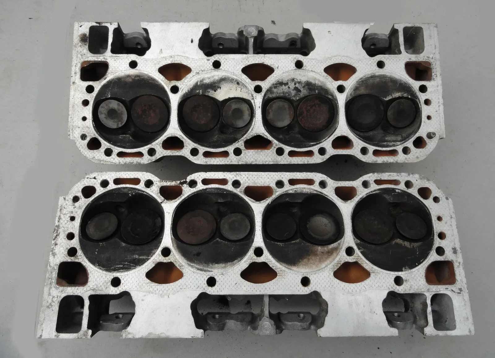

A pic from ebay with vette aluminum heads.
You can see the intake mounting is open
God d*mmit you're a champ. Fingers crossed it isn't my problem
