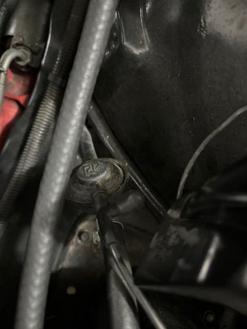

I never disconnected the EVAP system. At least mostly. I do have a question, though.
See the attached pictures. Specifically the 2nd one. There is a capped line - you can see the little rubber plug I used. It's been so long ago, I don't remember what originally is supposed to be attached there. Can someone help?

Looks like you're in luck because that appears to be vacuum control rather than ECM control. There should be a diagram on the hood showing how it's all connected. The gist of it is there should be a tee screwed into the intake that opens when the coolant is up to temp and that allows system vacuum to open the purge solenoid (the round hat looking thing). There should also be a big hose that tees into the brake booster or pcv port on the carb, that's how the can and subsequently the tank gets evacuated.
