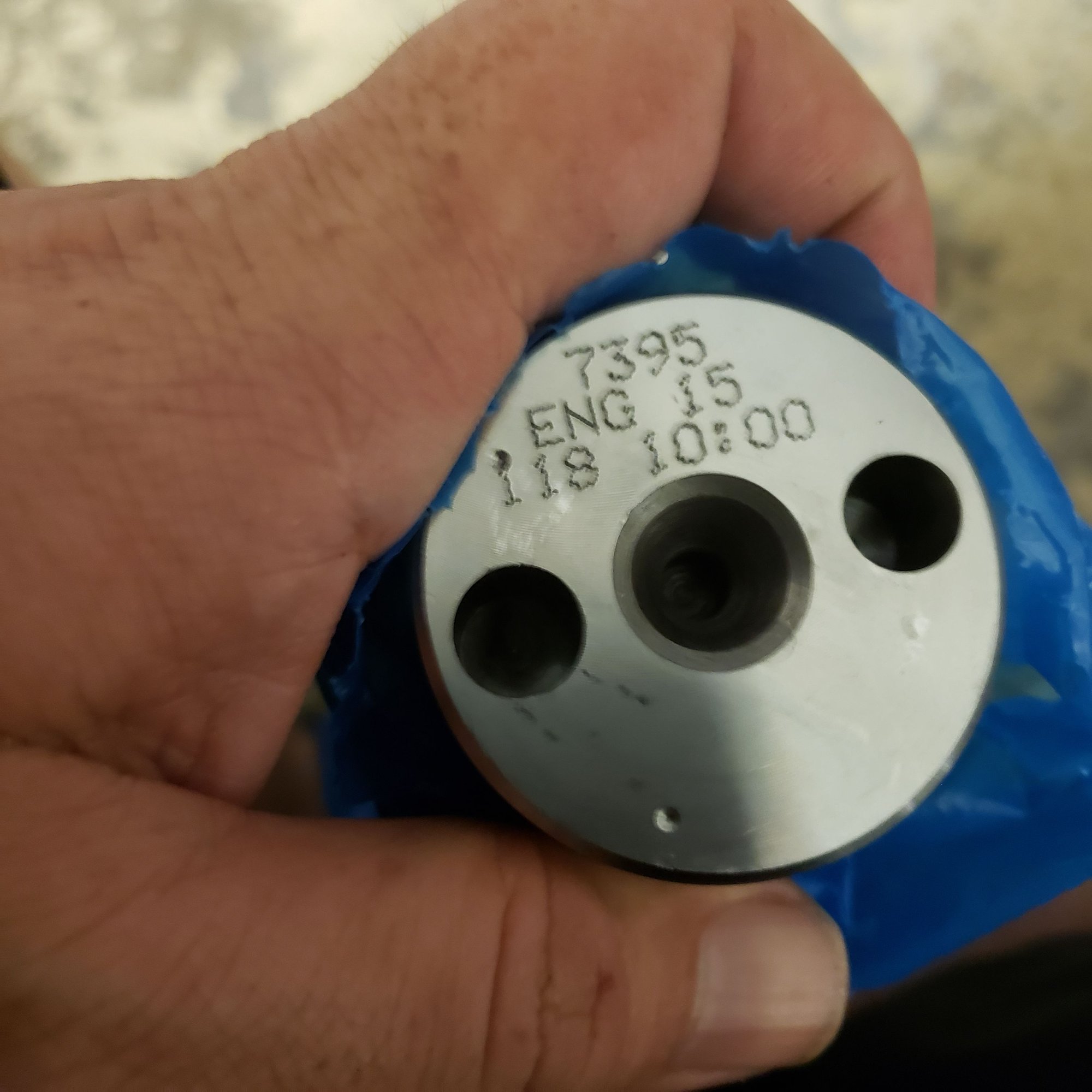

The last 4 digits of the part number will be stamped on the rear end of the camshaft. The SP383 has a GM supplier clone of the old Crane made GM 846 cam.
12370846 Hydraulic Roller Design
This hydraulic roller design contains eccentric for mechanical fuel pump. It is for off-road use only. The duration at .050" tappet lift (intake/exhaust) is 222/230; and maximum lift with 1.5:1 rocker ratio (intake/exhaust) is 509/528. Valve lash is zero/zero and lobe centerline is 112 degrees.

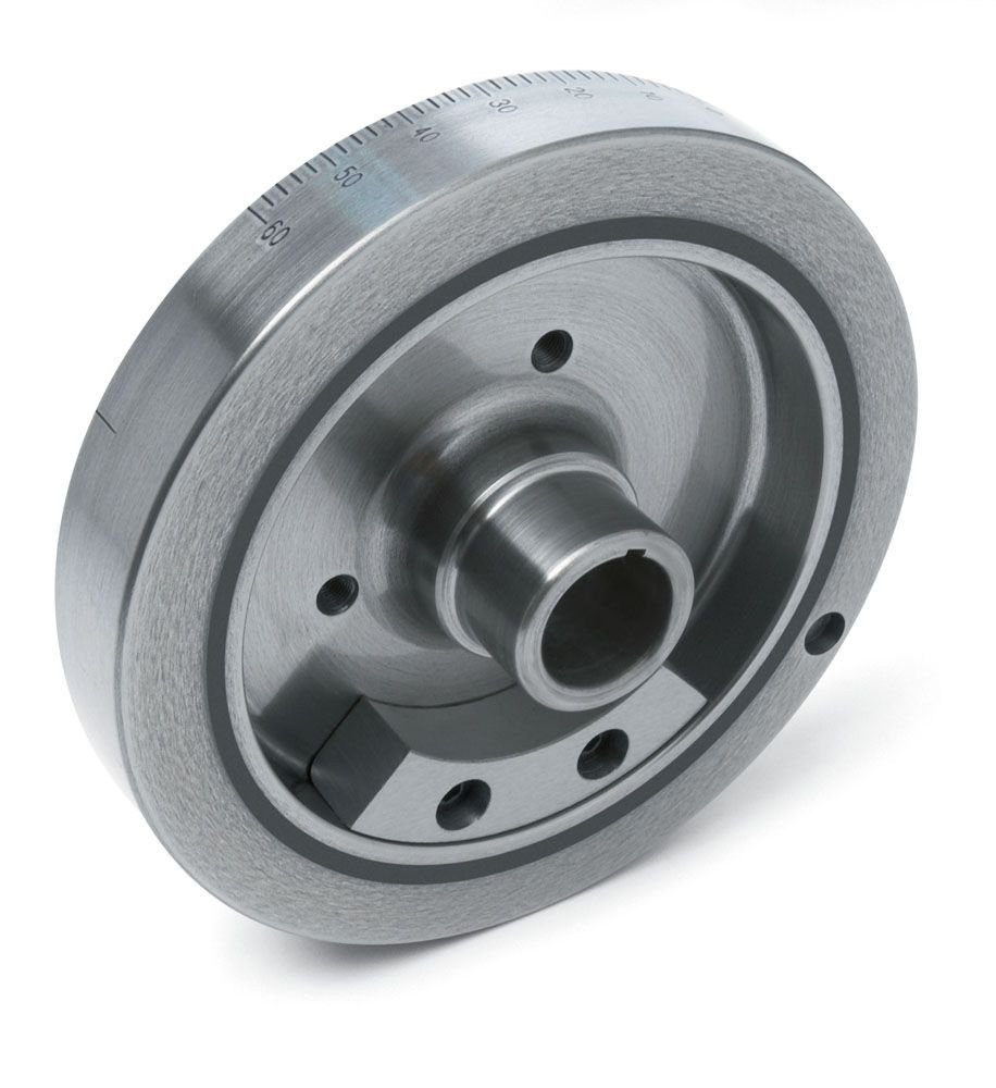

I have the HT383 short block.
On the back of the engine in the bellhousing area, it has this ID tag...(picture 1 below)
It also came with the SP383 cam. There was no p/n on the cam oddly enough, but Scoggin Dickey Chevrolet (where it came from) said it was the SP383 cam, and I also verified it against the specs on that cam with the degree wheel. The only markings on the cam were V119 216 (picture 2 below)
Also, the only 383 that GM ever built was crate engine that uses the mid-90's Vortec blocks with the composite timing cover. If its not a Vortec block, it is not a GM 383.
But you can also measure the stroke... it should be 3.800 (not 3.750). That 3.800 crank is a unique GM crankshaft.

I have never seen a GM cam that did not have numbers somewhere on it. Most of the GM performance cams are marked on the rear of the cam. Some are between the fuel pump eccentric lobe and #1 exhaust lobe.

Literally googled the cam in question. Found a picture with the last 4 of the part number right on it.
