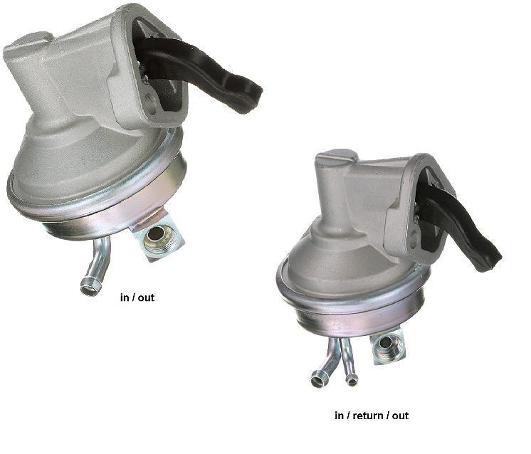

Replacing hoses and mechanical fuel pump on my 1985 v8 5.0 trans am 305. And noticed in one of the hoses, there’s a metal ball inside, what is it for? Is it supposed to be in there? Is there a specific place on the hose it should be?

That's a new one on me. Looks kinda like it could be a check ball.
Which hose is this? What fuel system & engine did the car originally have?

it’s a 1985 v8 5.0 trans am 305, carbureted. It’s one of the two hoses connected to the mechanical fuel pump

My guess is that somebody put that in the return line in an attempt to get more fuel to the carb.

Probably had the wrong 2 port fuel pump on there at one time (in/out) and they plugged the return.
It should have a 3 port pump on there (in, out. & return.)

No, not a good idea.
These cars typically run hot causing vapor lock in the fuel line. This is made even worse if you run ethanol containing fuel. GM provided a return line is to prevent / reduce this problem.
Of course you'll need to verify that this is indeed the fuel tank return line before connecting it to anything.
Your pictures don't show where it was originally connected to or the new or old fuel pumps that are in question.

If that's what it is, just a ball of some sort jammed into the return line (the smaller rubber one at the fuel pump), and that line doesn't have a hookup at the pump, then it's some form of alternate socio-economic engineering, and needs to be done away with.
Put the right pump on the car as described and replace that little short section of rubber hose with good quality 5/16" or 8mm fuel hose. Make sure it's REALLY "fuel hose".

Absolutely. That return fuel line was intended to keep liquid fuel moving through the system and reduce the heat buildup in the supply line. It will work without the return line, but certainly not as intended. The Powertrain boys and girls didn't change the design just because they had a lot of surplus steel tubing lying around.
