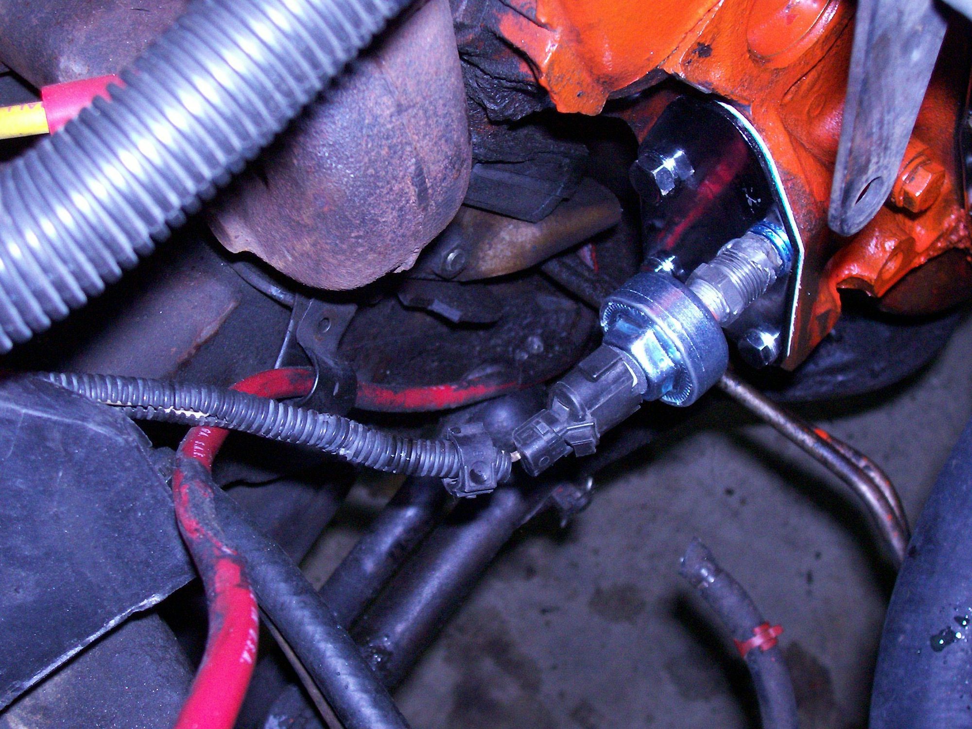

So quick question and trying to sift through all the posts over the last 20 years and couldn't find the answer...
Have 400 SBC running Hooker long tubes, not enough room for the knock sensor on the passenger side... other option is to move above the oil filter on drivers side... are the two locations the same thread size? Currently on mine, above the oil filter, its a blind hole/boss with threads but the knock sensor I got does not thread in.
TIA for any help!

I kinda don't think so.
The knock sensor is ¼" pipe. You can go to the parts store and check an oil pressure sending unit that's for that hole and see if it's that size. Butt I think it's something larger; 3/8" pipe maybe. You could probably use a bushing if it is.
That hole is not "blind". It's the end of an oil passage that the factory drilled and then used that plug to seal off.

I'm no expert on 400 SBC blocks. I know there are 2 and 4 bolt main versions and 3 core plug and 2 core plug blocks. I know on the SBC engines that came in our cars that the knock sensor screws into the passenger side lower block drain and on the driver side of the block is the same lower block drain with a plug screwed into it.
IDK if the 400 SBC block also has a driver side block drain too. IDK how the headers you have are routed on the driver side. If you have a driver side block drain and the headers provide enough clearance on the driver's side maybe you can relocate it there.

https://www.jegs.com/i/Ron-Francis-W...tent=Evergreen
It mos def does. The 400 is the same as any other block, SBC or any other, in that regard. How else would it be possible to drain it?
I'm having a real hard time imagining how headers can interfere with the pass side drain plug location. Can't see how that would be possible, and still clear the starter and engine mount.

Not sure what the interference might be, but the 01-07 L31 350 powered trucks built on the GMT800 platform used 4 bolt LS mounts on the block and the engine mount interfered with the knock sensor connector. GM put a knock sensor on those trucks that has a connector on a length of wire away from the sensor. The L31 knock sensor is the same sensor as a mass air TPI.

So this was my issue also. I ended up screwing a fitting into the block that did a 90. Then screwed the knock sensor into the fitting. Some say this slightly reduces the sensitivity of the sensor. I've never had any issues.

That's one FUNKY header primary routing.
If the OP's situation is similar then the same solution should work fine.

Hooker 2210's. Besides the knock sensor I had no other issues with them which was nice.

Yeah just looks like it could have been routed outward so that it was more tucked in together with the others. Butt as we all know there's often more to the story than can be seen in one pic.

Thanks for the responses. Running the same headers as well so you see my concern. Drivers side would be a great option but I am not using the drivers side drain plug because it is seized.
Since you have had luck with adding a 90 in there, that may be the way to go for now and if there is an issue later down the road then I can turn back and look at the passenger side again.

Heat it....it will come out. I'd get that thing out while you have access to it; need it to come out to drain/fluch coolant, anyway, as Sofa mentioned.
