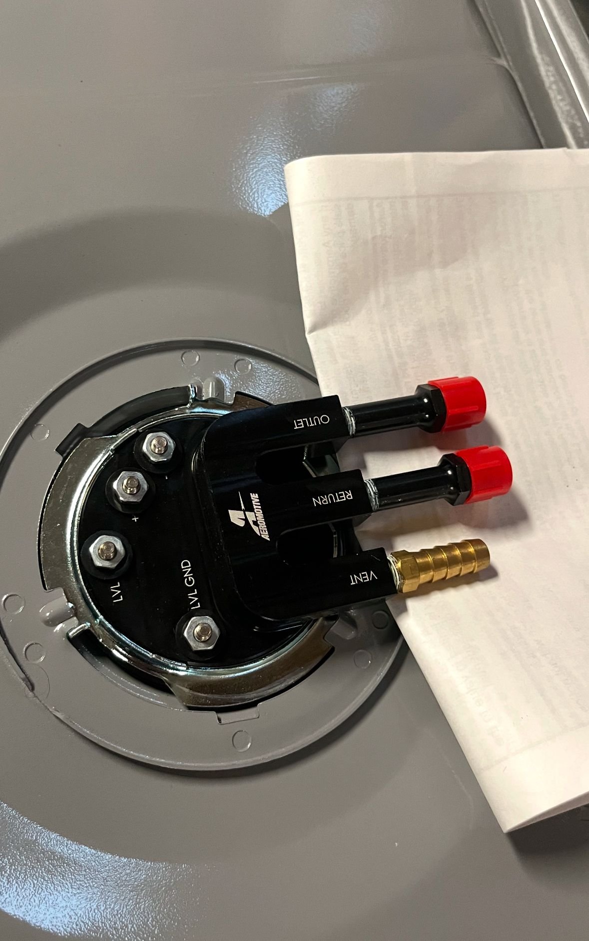

6an for the feed and return will be fine. When I did my fuel system I used an aeromotive stealth setup. Aeromotive said 6an was sufficient up to 650 hp w forced induction and higher without. Just make sure you have sufficient return. Otherwise you'll have fuel pressure issues and potentially fuel pump issues.

Did you keep the stock sending unit lines then adapt it to 6an? If so did it work good?

Nope, I used a full aeromotive stealth unit

Is that the entire fuel tank kit or just the pump and sending unit assembly?

I used the tank+sender combo. I figured my original 82 tank was gonna be a mess. It was totally fine inside and out so I could have gotten away w just the sender. In the end I'm glad I did both. Just one less thing to replace later. Dropping the tanks sucks. I'd rather do an engine than the tank.

Yea I understand completely, more than likely what Ill be doing. Do you happen to know how much total 6an line you used? Like how many feet around about?

Odd timing for this thread, I just finished putting in a new tank, sender, and converted it to AN fittings this morning. I used the metric O ring to AN adapter for the send line and then flared the rest of the sender lines. I then used flare nut to AN adapters for them. I'm keeping most of the hardline, I just wanted to get rid of the nasty rubber hoses and crusty lines at the back of the car. It's a pretty miserable endeavor, ended up dropping the rear end on my finger early on in the battle so I've been doing it handicapped lol

I bought 2 oem style 3/8 feed lines but trying to adapt that to work to my aeromotive sending unit and holley FI system has me really considering throwing all that in the garbage and just doing one continuous run of AN line.
Old Mar 17, 2025 | 04:49 PM
