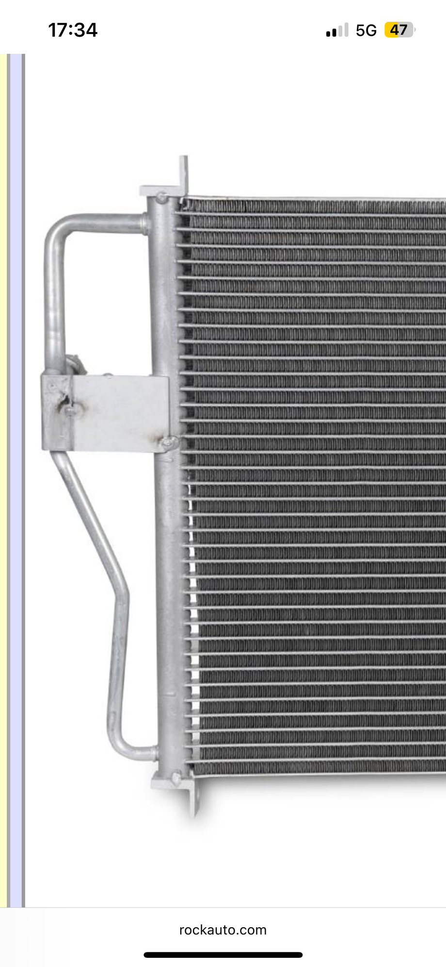

Probably 6mm pico design based off their stock photos rather than parallel flow but still an upgrade from the OE tube and fin. I ran into the same issue on that 1987 G20 finding a good replacement condenser. Not exactly rocket science to build a condenser that will actually mount correctly and is parallel flow but it seems beyond the grasp of the manufacturers and retailers of replacement condensers. Ideally they should be building subcooling parallel flow condensers with a vapor/liquid seperator on one tank and a subcooling row.
Not sure what your seeing but to the two I looked at on Rock state parallel flow and from the picture it looks correct and not a piccolo tube design.

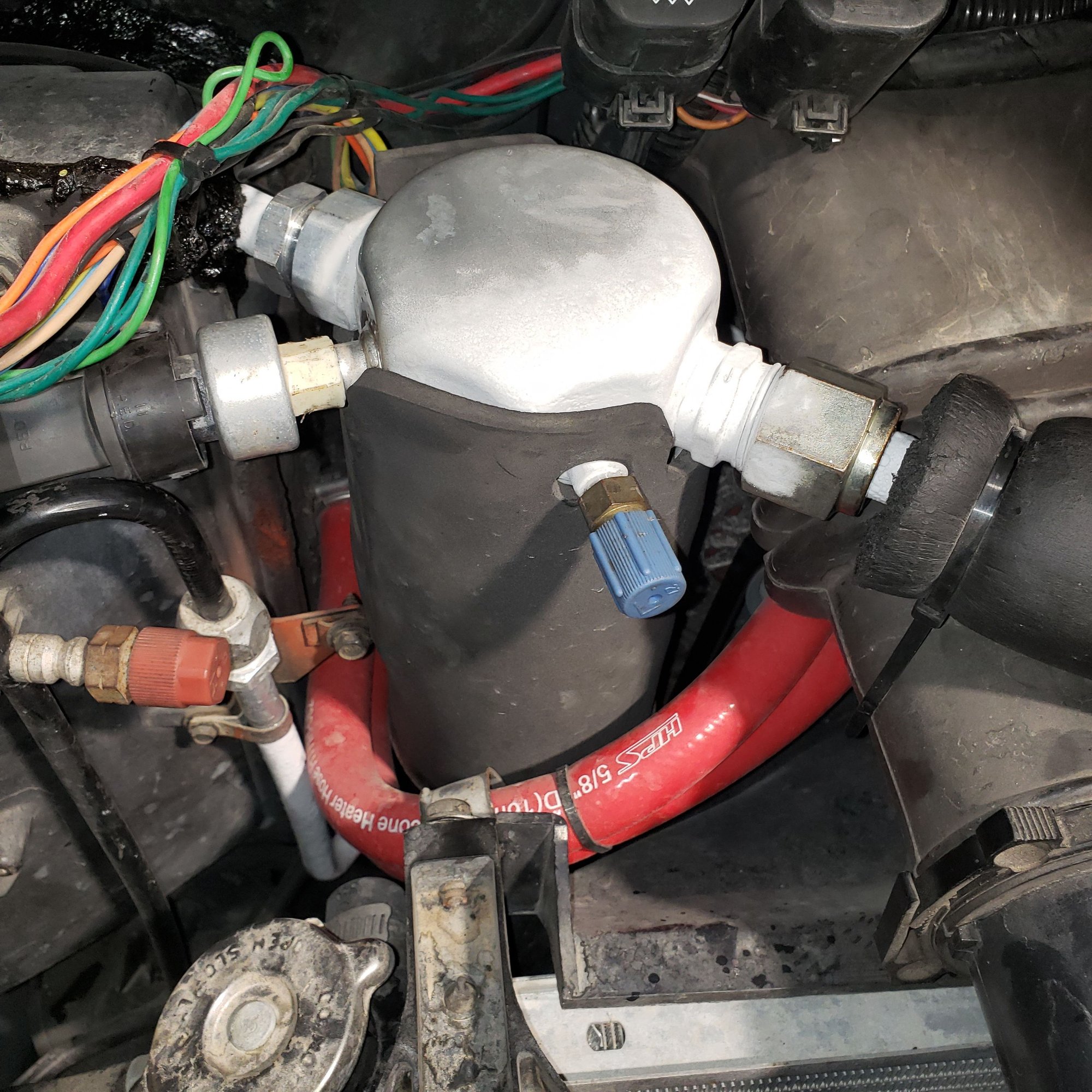

I agree with you that a subcooling parallel flow condenser is best, this is why when building a custom setup I like to use a Toyota or Honda condenser that fits the rad support opening some even have the separator built on, my GTA is a complete custom setup with a moster flow parallel with a receiver drier on the liquid (vapor/liquid separator) into a adjustable txv to set the superheat across the stock evaporator, txv so obviously no accumulator anymore, sanden sd8.
I looked at the only 2 listings for a 1984 Camaro with a 305 on RockAuto. I am not 100% sure if other years interchange, but I was able to get a parallel flow about 5 years ago for an 87 Firebird V8 car.

Okay so good for people to know, I put in 91 5.7 and two are parallel flow replacements, these should work on all years if my memory serves me correct the lines/hoses are the same at the condenser side.
