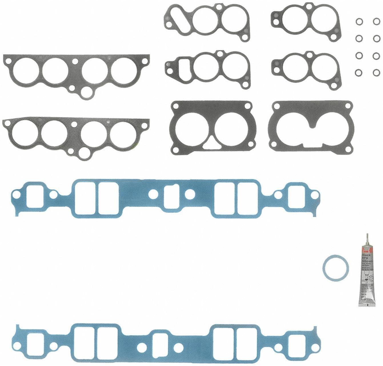

There are two throttle body to plenum gaskets. One for 1988 and earlier TPI systems and one for 1989 later TPI systems. I've always wondered what would happen if you used the wrong style gasket on the other style throttle body & upper plenum. I know you can use one style throttle body on the other style plenum and it's OK I hear, but the other way around and it isn't OK and you have to machine a hole into the face of the plenum for it to work.
Most the gasket kits today have only one style of the TB to plenum gasket in them.
This very well isn't your problem though. Most people use the kit without the lower intake manifold gaskets with just the one style TB gasket when working on their TPI system and I've not heard any complaints about it.
The two different style gaskets are in the middle upper right. Lesser gaskets kits without the lower intake manifold gaskets only have the gasket thats in the middle of the picture. You can buy either of the two styles TB gaskets by themselves.
Gasket kit for a 1985 to 1992 F-Body. The two different style TB gaskets are in the middle upper right. Lesser gaskets kits without the lower intake manifold gaskets only have the gasket that's in the middle of the picture. You can buy either of the two styles TB gaskets by themselves.
Only has one style TB gasket. So if might not matter at all. IDK

I use the triangle 🔺️ actually didn't know there were others as the triangle matches the throttle body opening

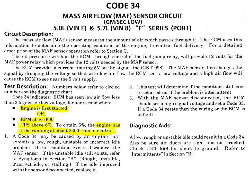

So I just unplugged the maf to see if that was my issue. Didn't get a SEL, should that of come on immediately ? If I recall correctly it immediately illuminates.

Depends. There's two scenarios. If its unplugged with the ignition switch off and upon startup it should send the fault immediately. The second one is a little tricky. States RPM above 600 but not sure if thats the only criteria or if its above 600 rpm with the TPS above 6%.
Would like to know as I run TBI
Old Apr 29, 2025 | 06:15 PM
george88gta's Avatar
Posts: 464
Likes: 23
From: Long Island N.Y
Car: 1988 Pontiac GTA
Engine: 5.7 l98
Axle/Gears: BW 9bolt with torsen carrier
Re: Runs only WITH vaccuum leak
Thanks that's Interesting, also say in netural which is odd. I can barely get it to run now but did give it a rev when it did. Now that makes me think I may have a ECM issue. Hmmmm

This is worth reviewing too.

Yes, and that diagram makes me think it would set with sel, with key on not running as it administers a pre test. Thanks.
