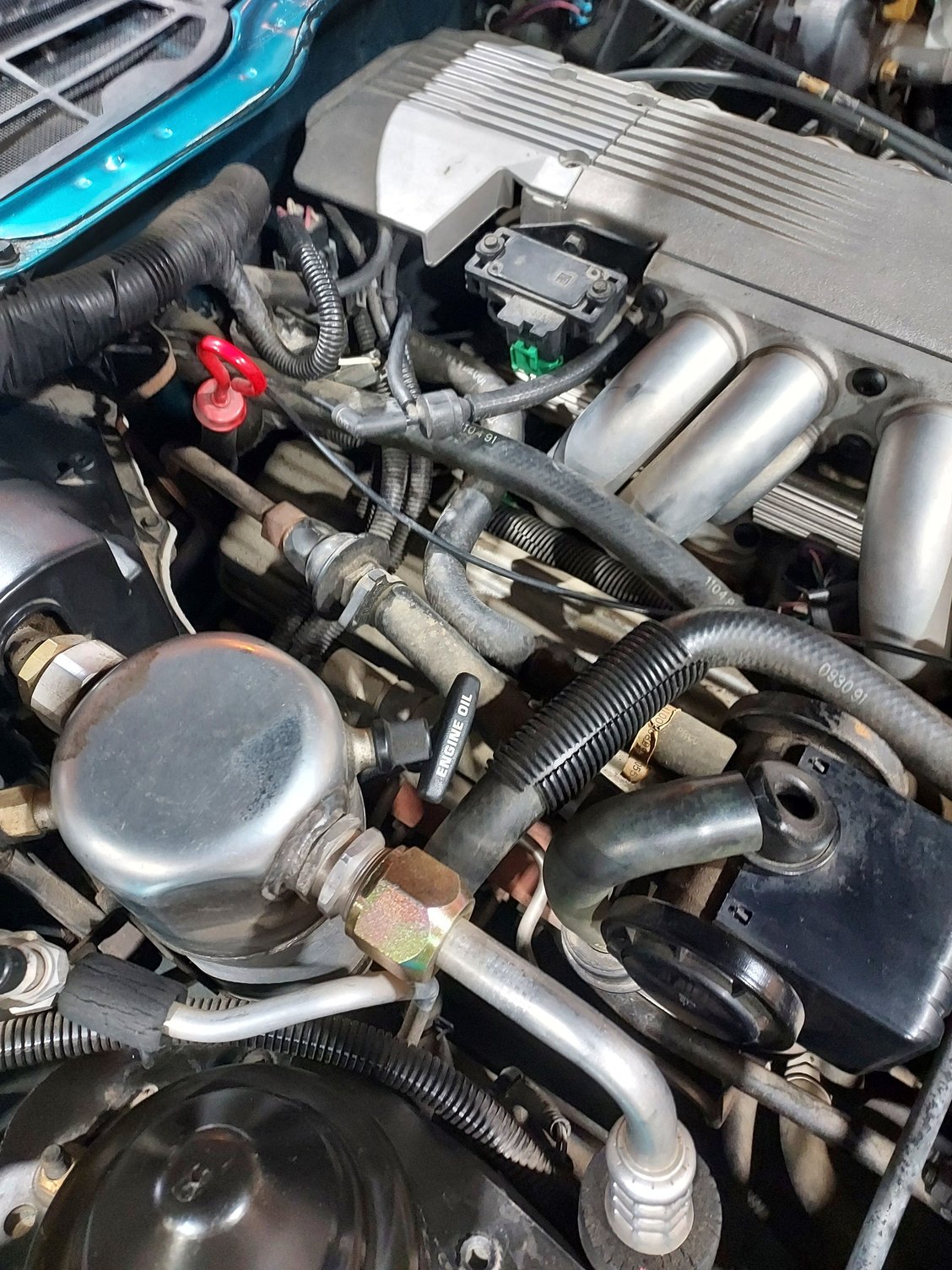

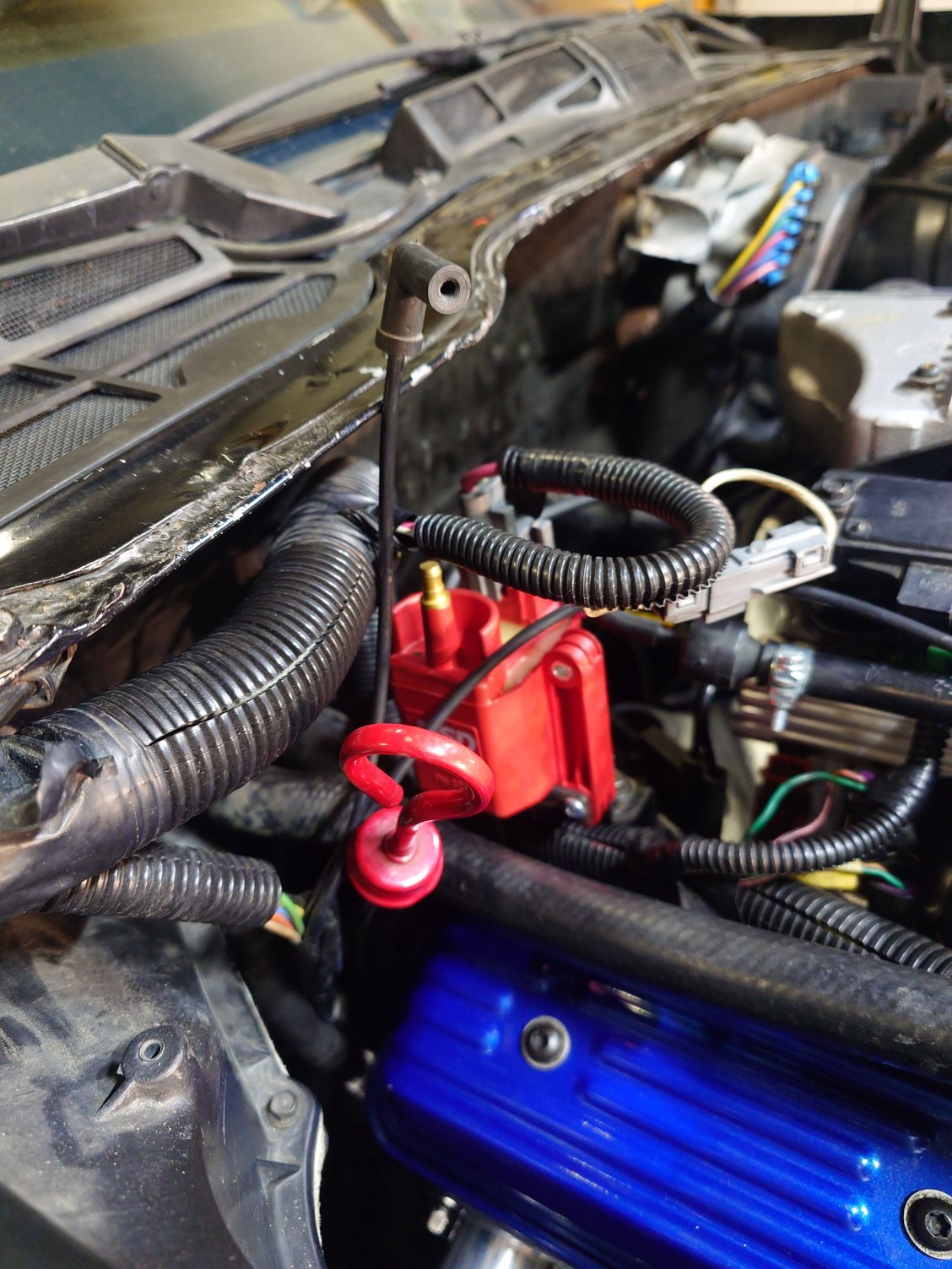

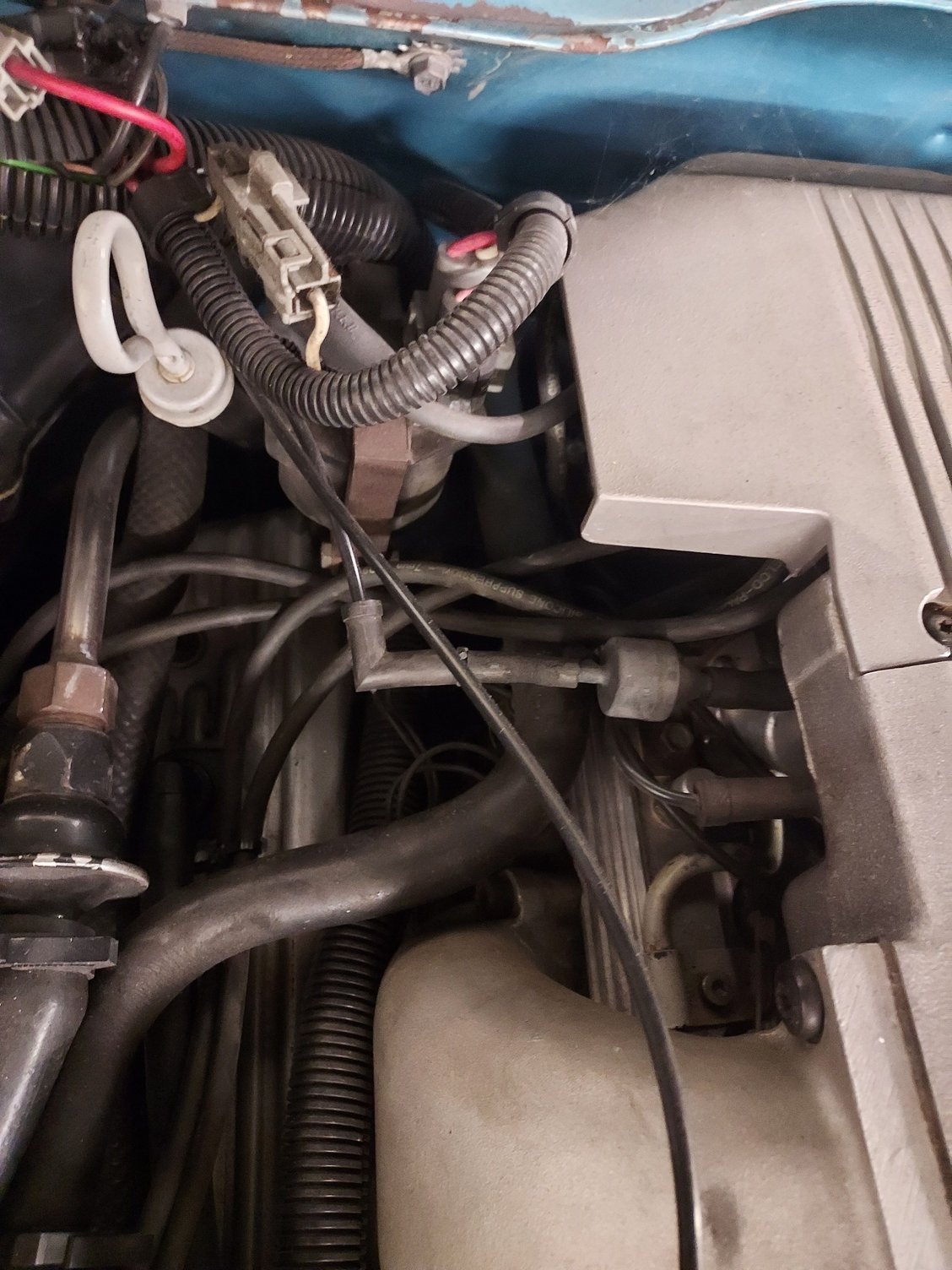

See the vacuum line going to top of round heater control behind the A/c compressor?
My 92 formula 350 during the repair it faze.
