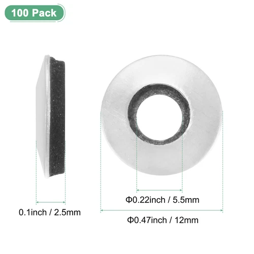

What about using something like this?
EPDM Neoprene Rubber Bonded Sealing Washers
They come in stainless also.
Interestingly, I saw those on another brands bolt offering. They didn't appear to be available separately though.
I'd say that would be the way to go. The bonded part of the rubber to steel is the ticket here. They remind me of the washers used in assembled steel buildings. They'd be underneath every teck screw used.
Thanks for that Mr. No. I'll look into those for sure. I just have to find the appropriate size. Which would be 1/2" O.D with a .250" I.D.

Home Depot carries a size close enough that could, I think, easily be modified to work. 1/2" O.D. although only a .125" hole. Corrected with a drill bit and some finesse.
$3.97 for ten!

We need the under the hood pic.
I did some searching for you: (304 SS)
100-Pack Bonded Sealing Rubber Washers, #12x1/2" OD Neoprene Washer Gasket | eBay
100-Pack Bonded Sealing Rubber Washers, #12x1/2 OD Neoprene Washer Gasket - Picture 3 of 7
You've certainly put me on the trail to getting something that should do the job.
I went online locally and found these about 15 minutes from where I work!
I just have to determine if 5/8" O.D. will fit in the bolt pocket in the valve cover.
