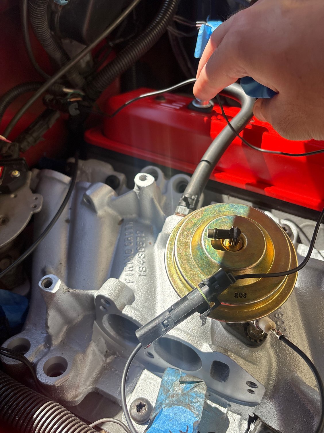

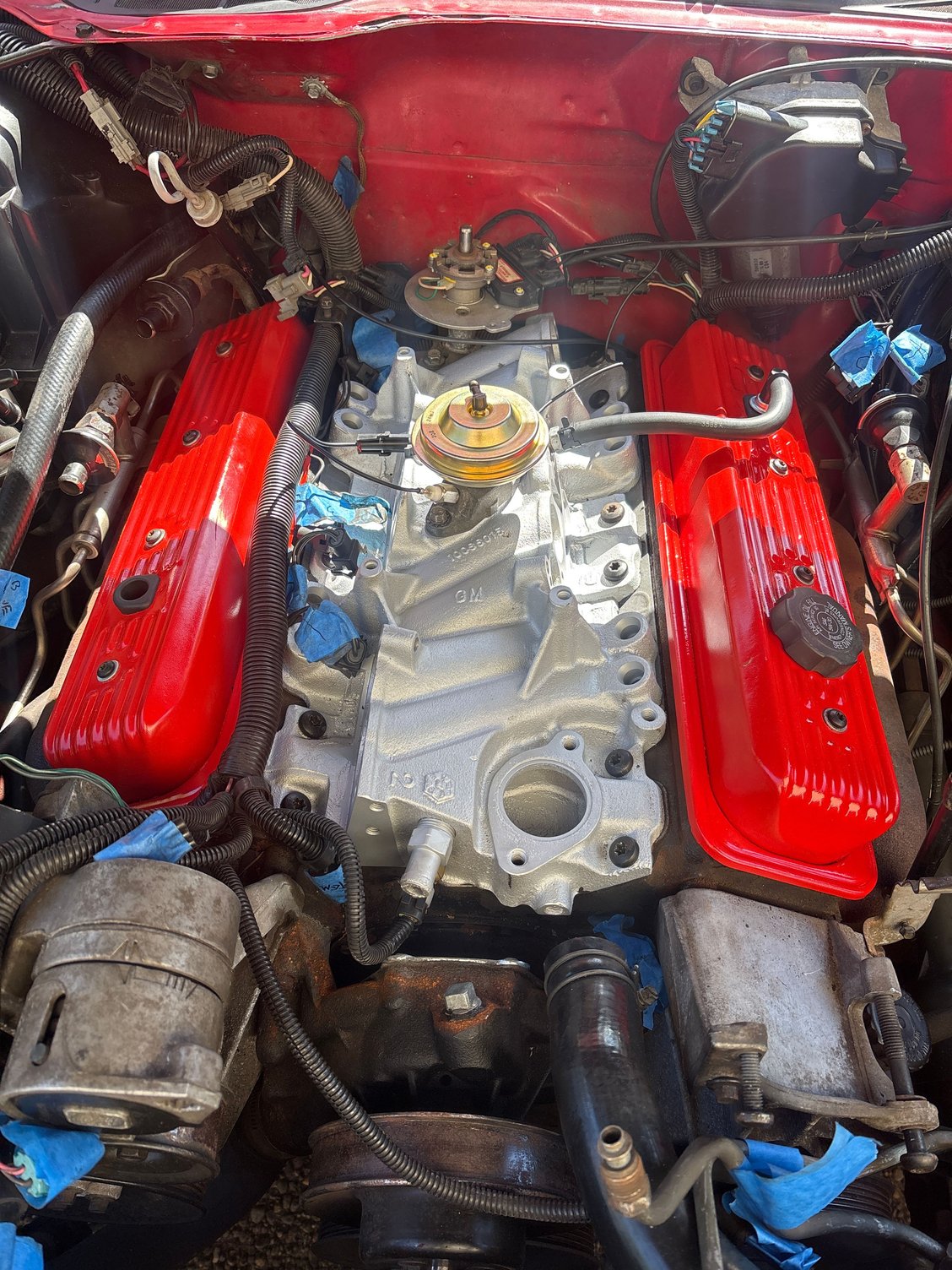

Just wanted to share progress. We started with having to replace the fuel injectors and due to a seized bolt in the TPI to intake manifold here we are, having gone down a “might as well” rabbit hole. Basically everything above the intake maninfold, including all sensors will be new/rebuilt.
New valve covers, clean/resurfaced intake manifold, all new gaskets (obviously), new PVC valve and hose run, new temp sensor in front of intake manifold.
New EGR valve, valve sensor, and extension pigtail.
Took the time to replace the ‘89 valve covers with the inverted early 90’s model and painted them while we were at it.
in order to make the erg sensor wire reach, because the original longer one is discontinued, I built an extension so that I don’t cut the original connector.
So far happy with the results.

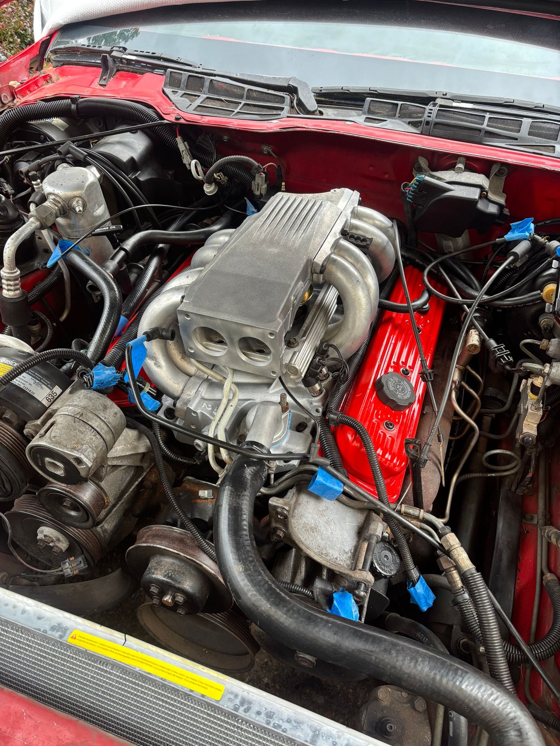

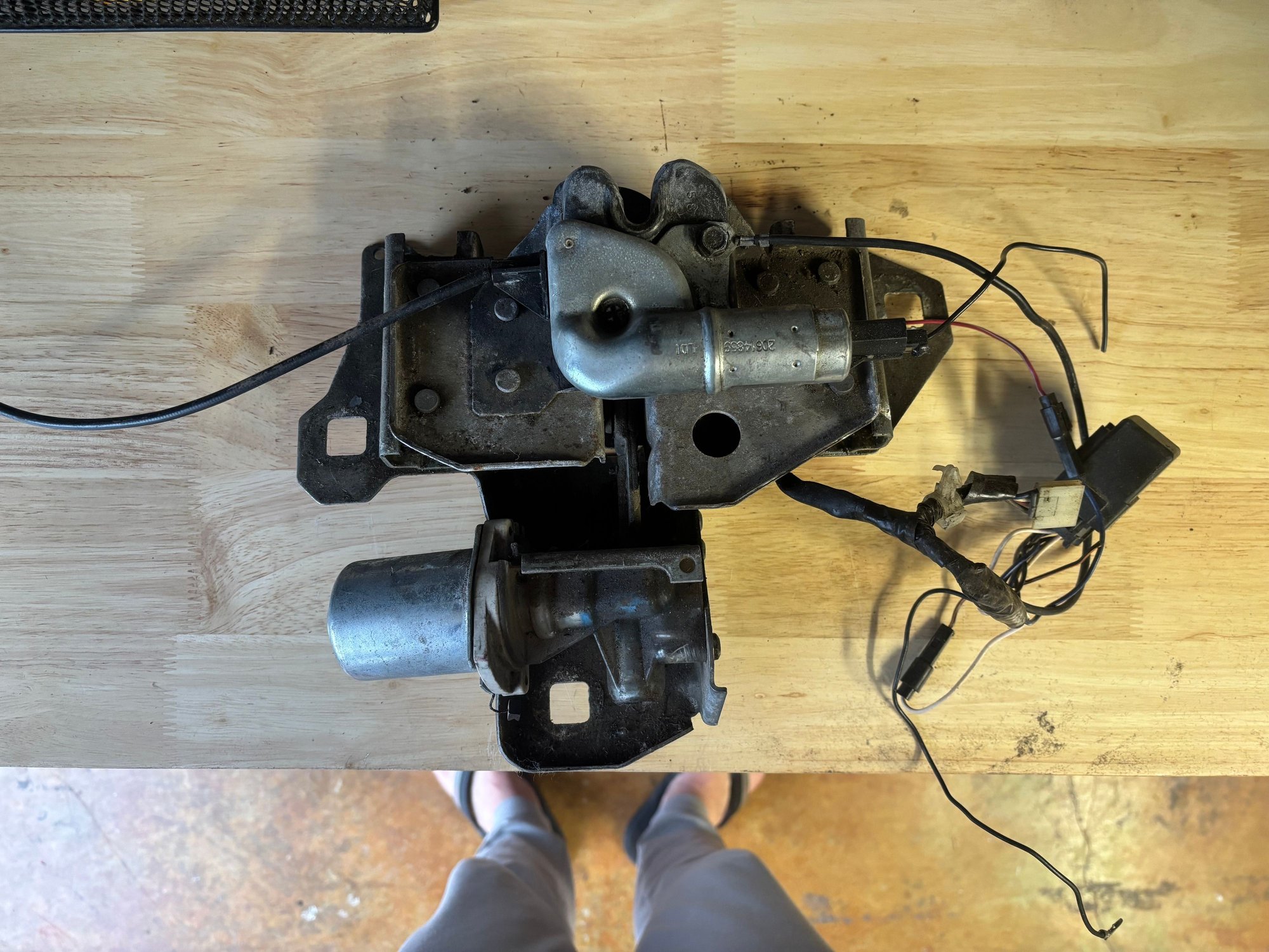

Ok, new fuel injectors, thermostat, and TPI back on. All of the engine sensors aside from TPS and MAF have beep replaced while I’m at it. I will test those last two at the end to see if they need to be replaced.
I was going to change the fuel pump as well, and as we were tearing out the interior to my surprise, I found that someone had already cut a fuel pump access, so we replaced the sender, fuel pump and connector hoses while we were at it. The original hole was cut like ****, and whoever did it just left the flap of sheet metal folded over it. I cut it off, and once I get the car running I’ll clean up the hole and actually install an access panel.
I didn’t take before pictures of that sender, but holy crap it was bad. The hoses were cut way too short, frayed, and I don’t think they were rated for fuel injection. They were gummy to the touch, and I’m surprised they weren’t leaking. The original pigtail had been badly spliced and was hanging by a thread.

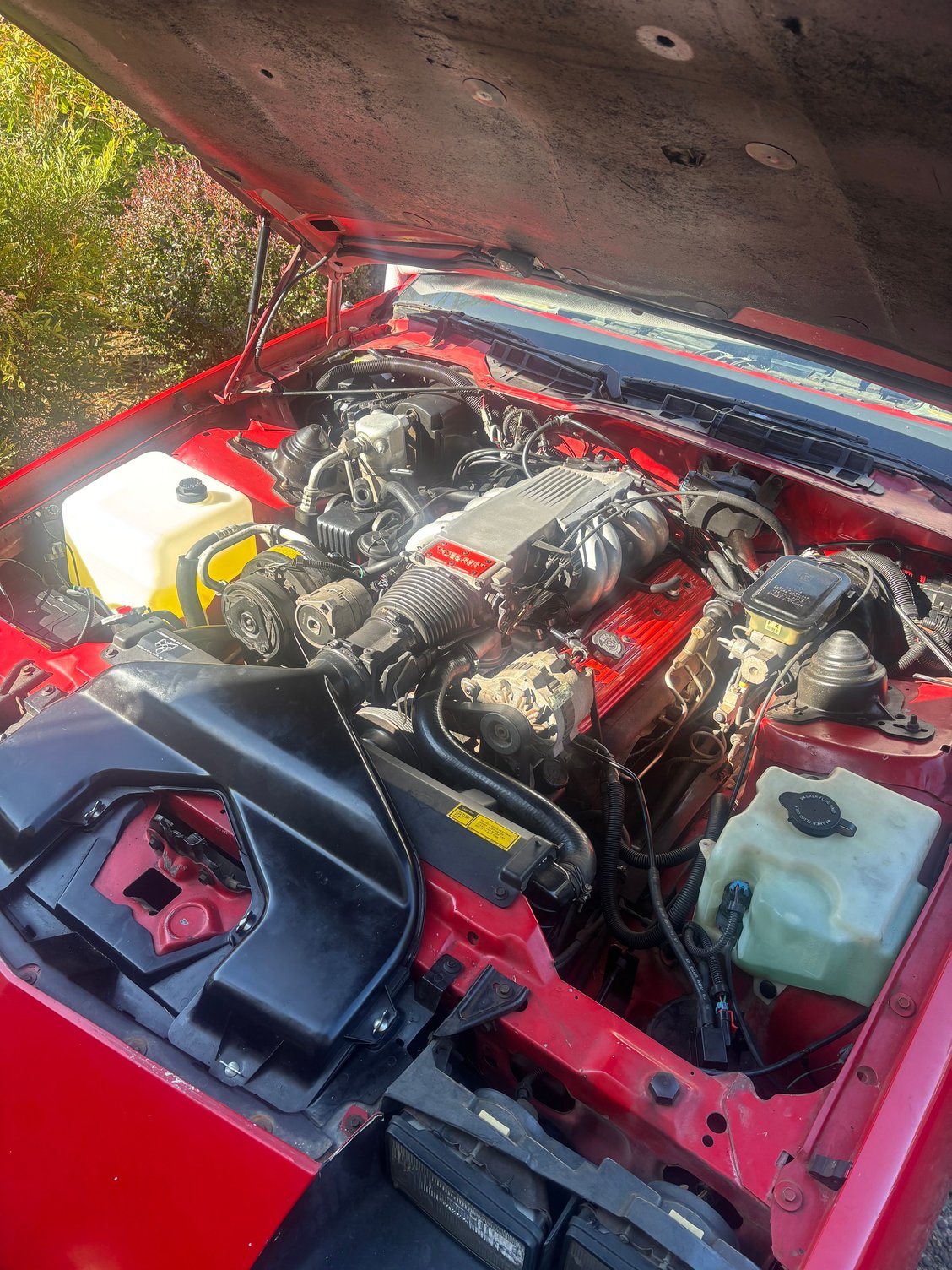

All right, the engine is all back up and running. I did run into a snag; apparently one of the o-rings in the fuel regulator got pinched when I rebuilt it so it had a small drip leak once at full pressure. Pain in the *** to take it out and do it again, but lesson learned.
Also, the thermostat housing gasket was leaking even with proper torque, but it was one of those cheap paper ones, so I replaced it with a higher quality rubberized one and it fixed the problem.
I did replace most of the vacuum lines that were dry rotted, along with reinstalling the HCV and stock heater hoses which had been replaced with some homemade, jerry rigged setup.
I also replaced the coolant reservoir, the cooling fans’ motors, and rewired the cooling fan harness which was a homemade mess.
Completed an oil change, transmission and differential service, and a coolant system flush.
I think this completes what I would say is phase 1, which is just getting the car running properly. This is what I spent so far:
The movie file is the car starting up.

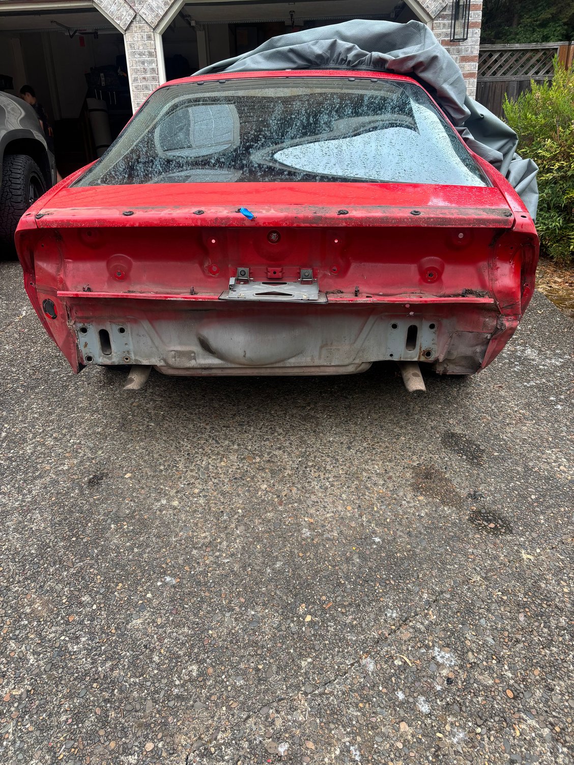

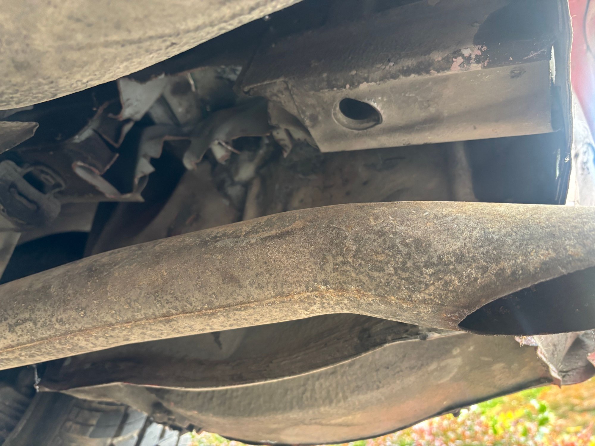

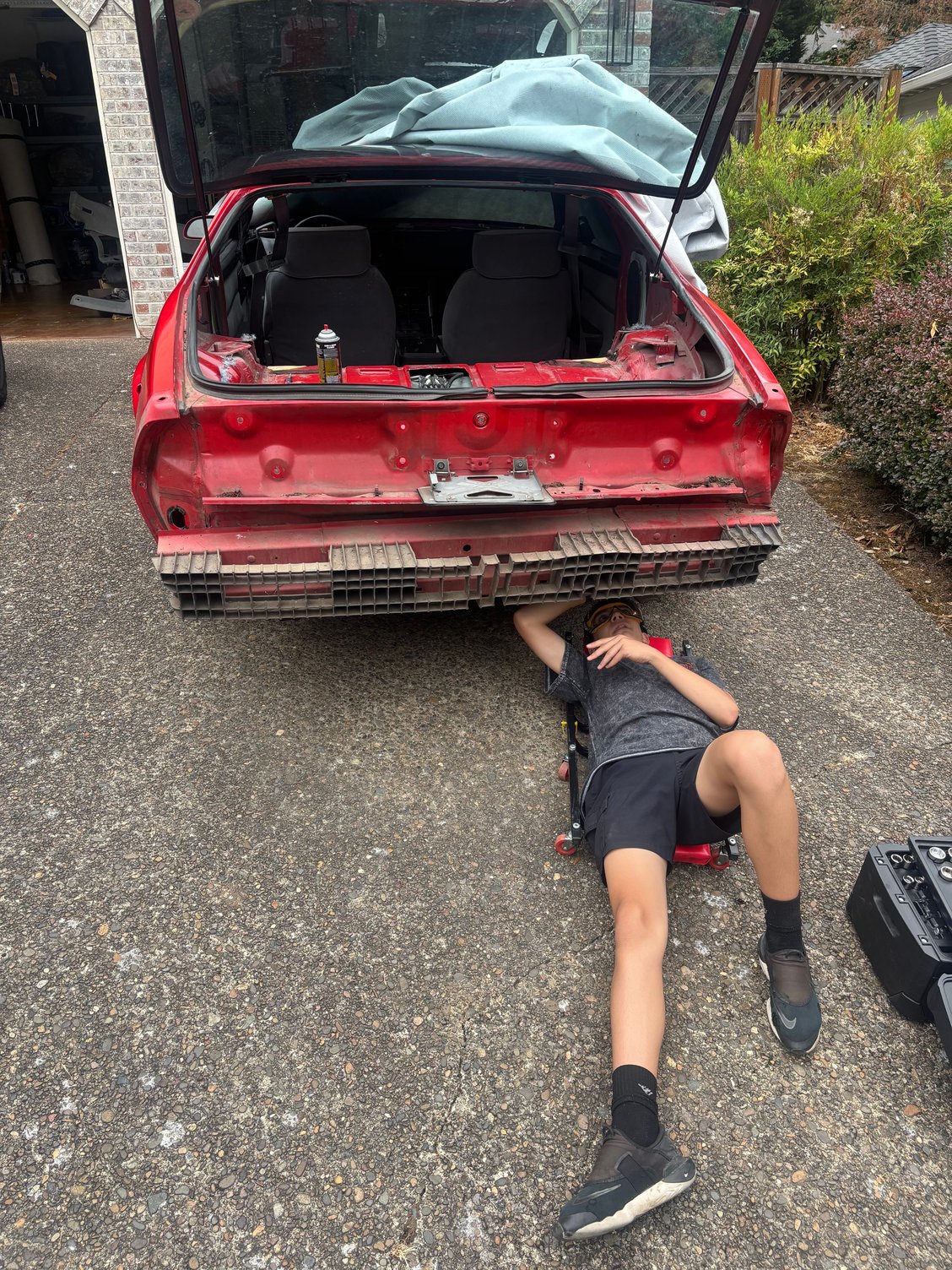

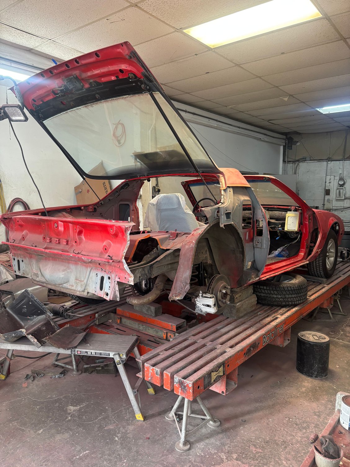

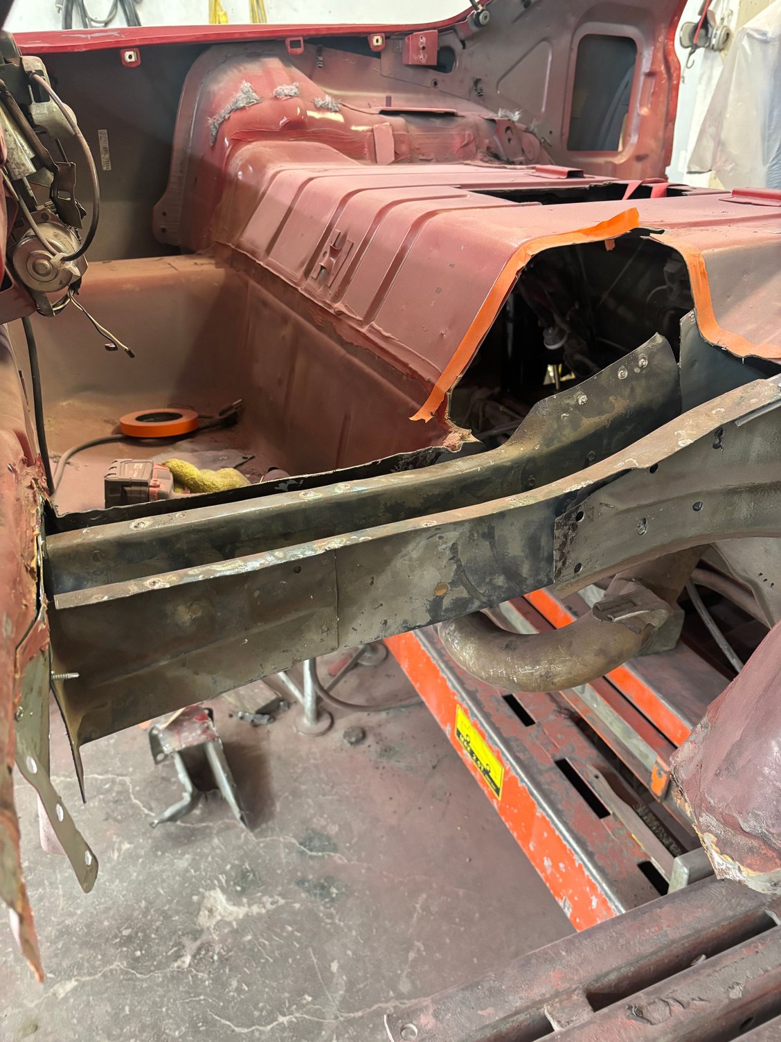

Urgh, today sucked. We started dissembling the body, and I knew the car was in an accident back in the day, which is fine, what I didn’t know is that whoever fixed did a **** poor job underneath. Turns out they hacked the end piece of the frame to straighten it back out.
That’s the only bad news. The good news is that it’s at the very end of the frame toward the rear passenger corner right at the bumper, so it doesn’t affect the main integrity of the car. Also, we’ll be able to fix it by having a sleeve welded around it. More work than I was expecting but doable.

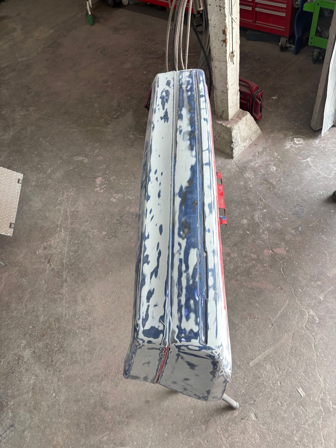

this is my son removing the bumper bar. Turns out that due to the accident they sliced the middle of it, most likely to straighten it back out. Will replace it to make it safe and restore durability.
So far we have stripped the rear of the interior/ body to work on it. I'm planning to replace the carpet, headliner and other components. All seats are actually in good shape, aside from being dusty/dirty. We will strip the front next.

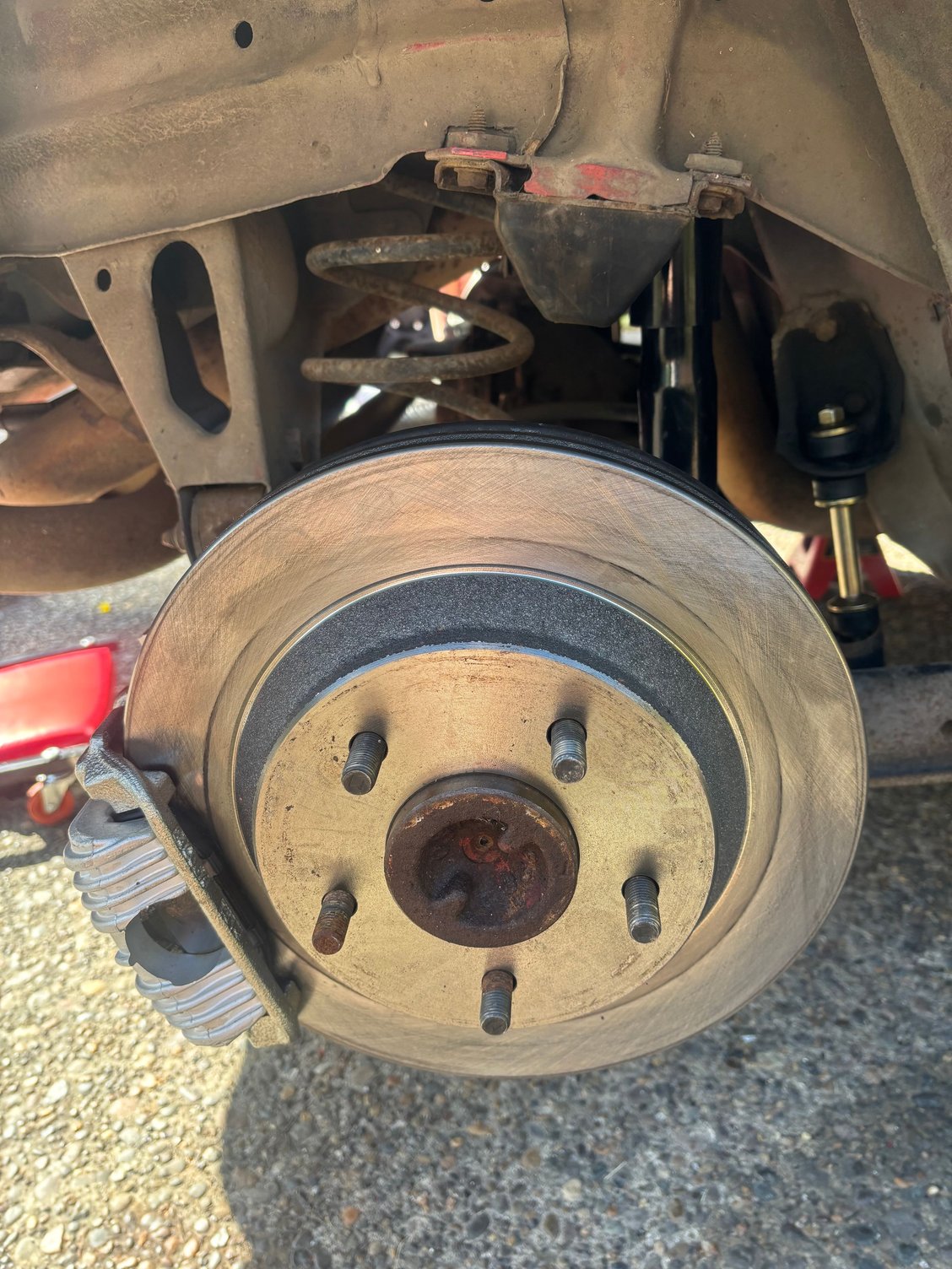

New rear shocks, calipers, rotors, pads, sway bar links and (although you can’t see them) bushings.

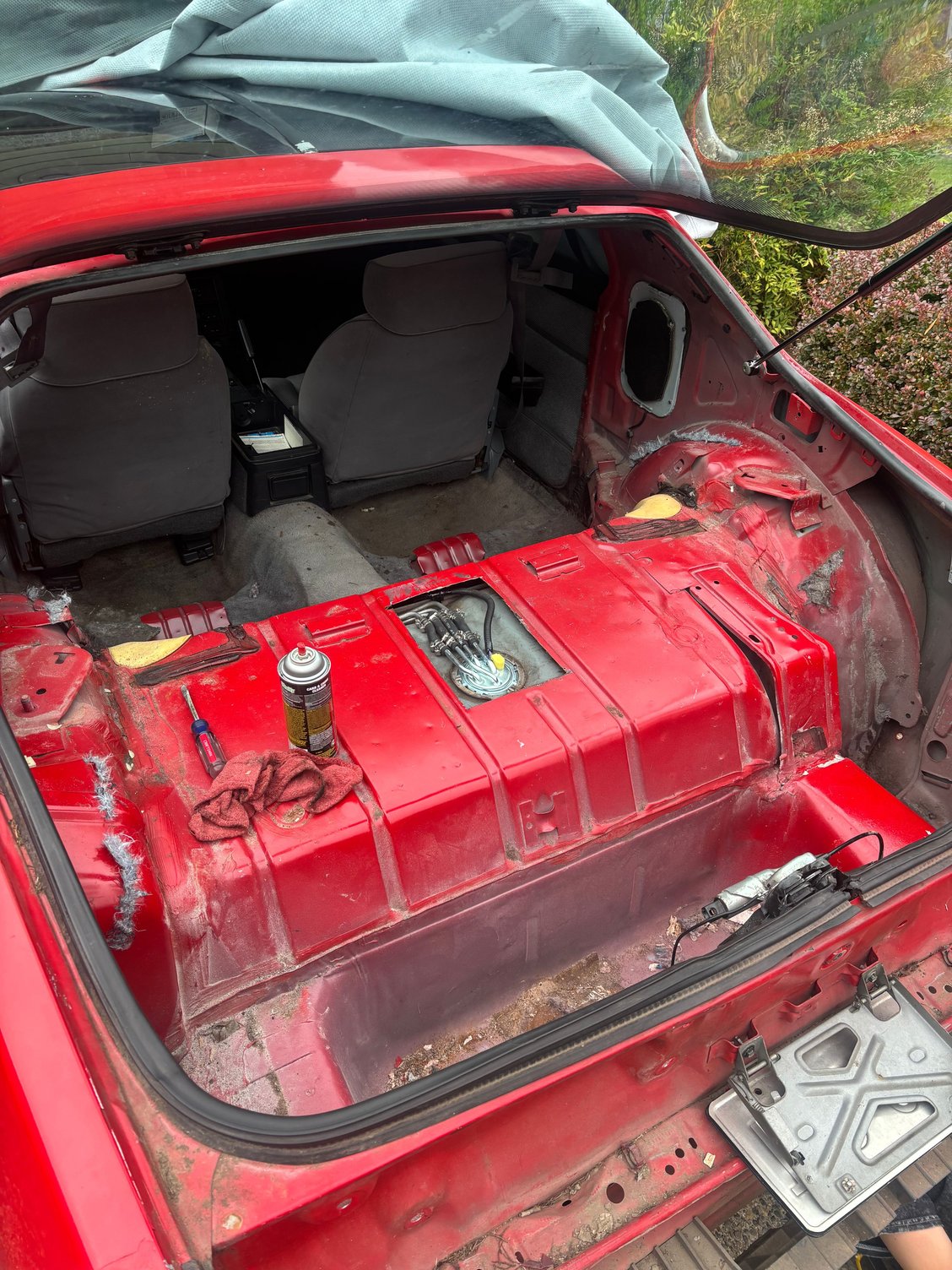

Ok, and we're back! The rain season in the PNW made us take a break, but it's slowing down now, so time to get back into it. We were able to completely retrofit the front brakes, calipers, rotors, wheel hubs, and struts, but totally forgot to take any pictures. In addition, we also replaced a bunch of emission components/hoses because they were a mix of bad shape, or dry rotted.
Bad news is, during the winter the gas tank developed a small leak, along with the upper radiator hose. I have both parts on order, and will replace once they get here. Because the rear springs and muffler would need to come out for the gas tank to be replaced, I have those on order as well, so new ones will go back in once reassembled.
The car will go into the body shop in the next couple of weeks to fix the quarter panel, and getting it ready for paint. We have a donor car where we cut out the rear quarter panel and will replace mine in it's entirety. I'll post pictures once I have them.

One good aspect of dropping the axle and exhaust to access the fuel tank is that provides an opportunity to make the pump access hole a little more clean, straight/square, and an opportunity to properly coat and seal any metalwork to keep it from rotting away.
Old Mar 7, 2026 | 11:22 PM
armyvman's Avatar

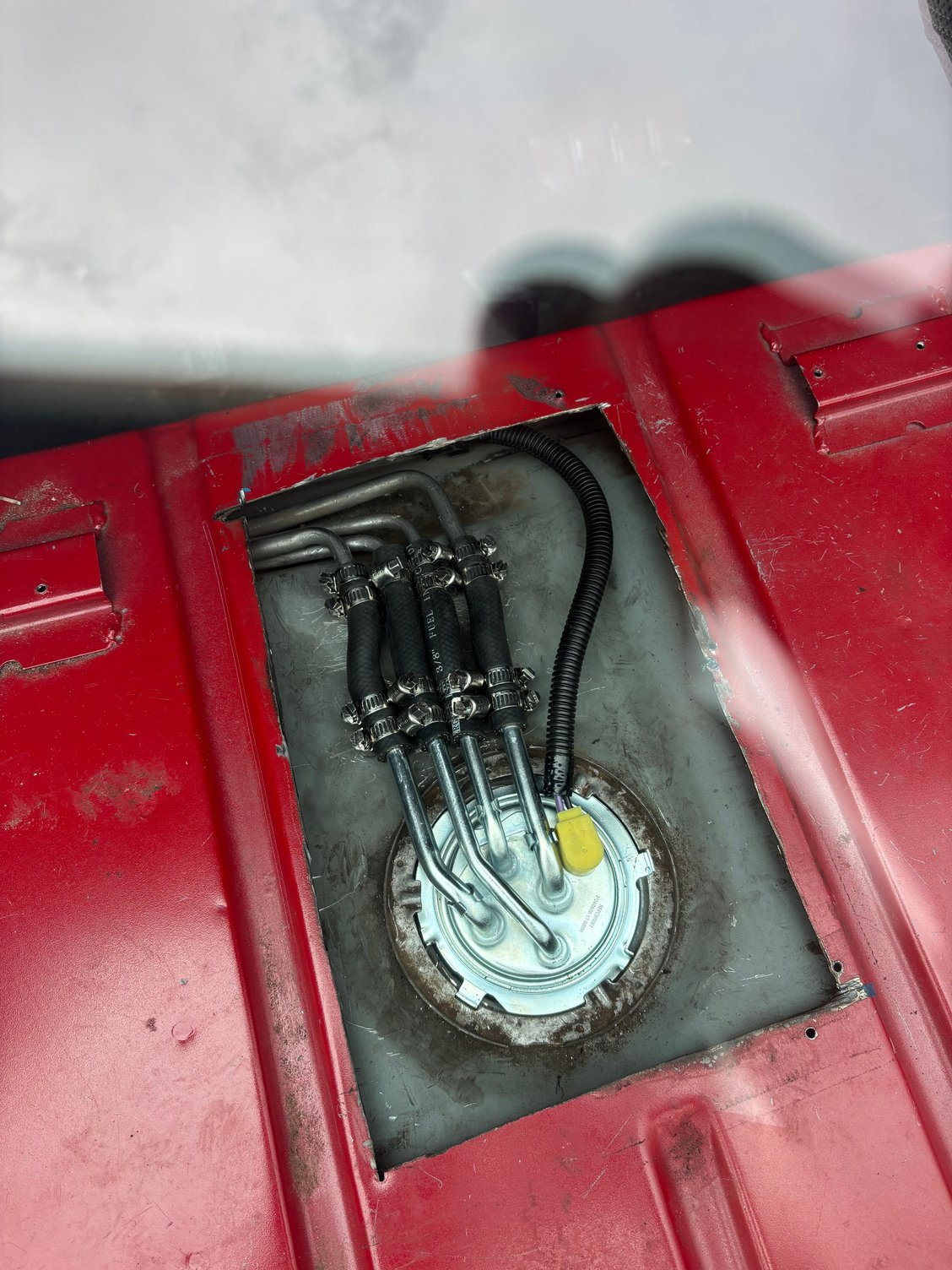

When I drop the tank I will take the opportunity of to also replace the muffler and tips, the real coil springs, and the tank straps at the same time.
When the car gets the quarter panel fixed, I’ll have the body shop weld the fuel pump access door as well. Right now it’s just a
hole. I bought a 9 x 9 access panel from summit racing.

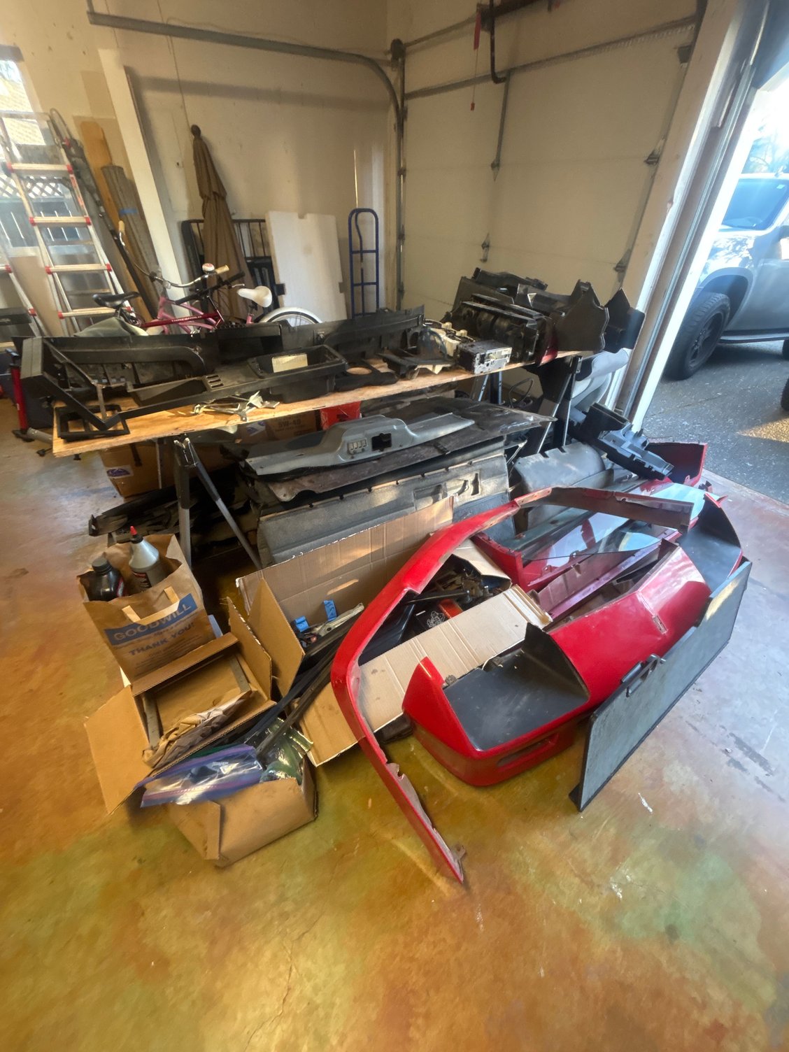

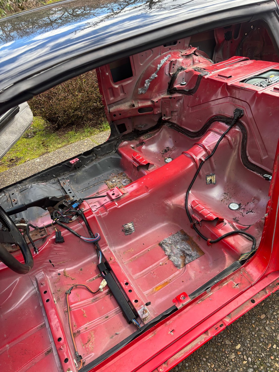

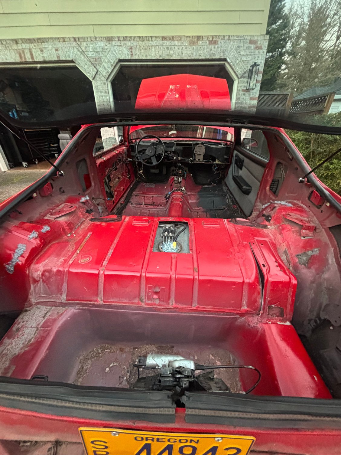

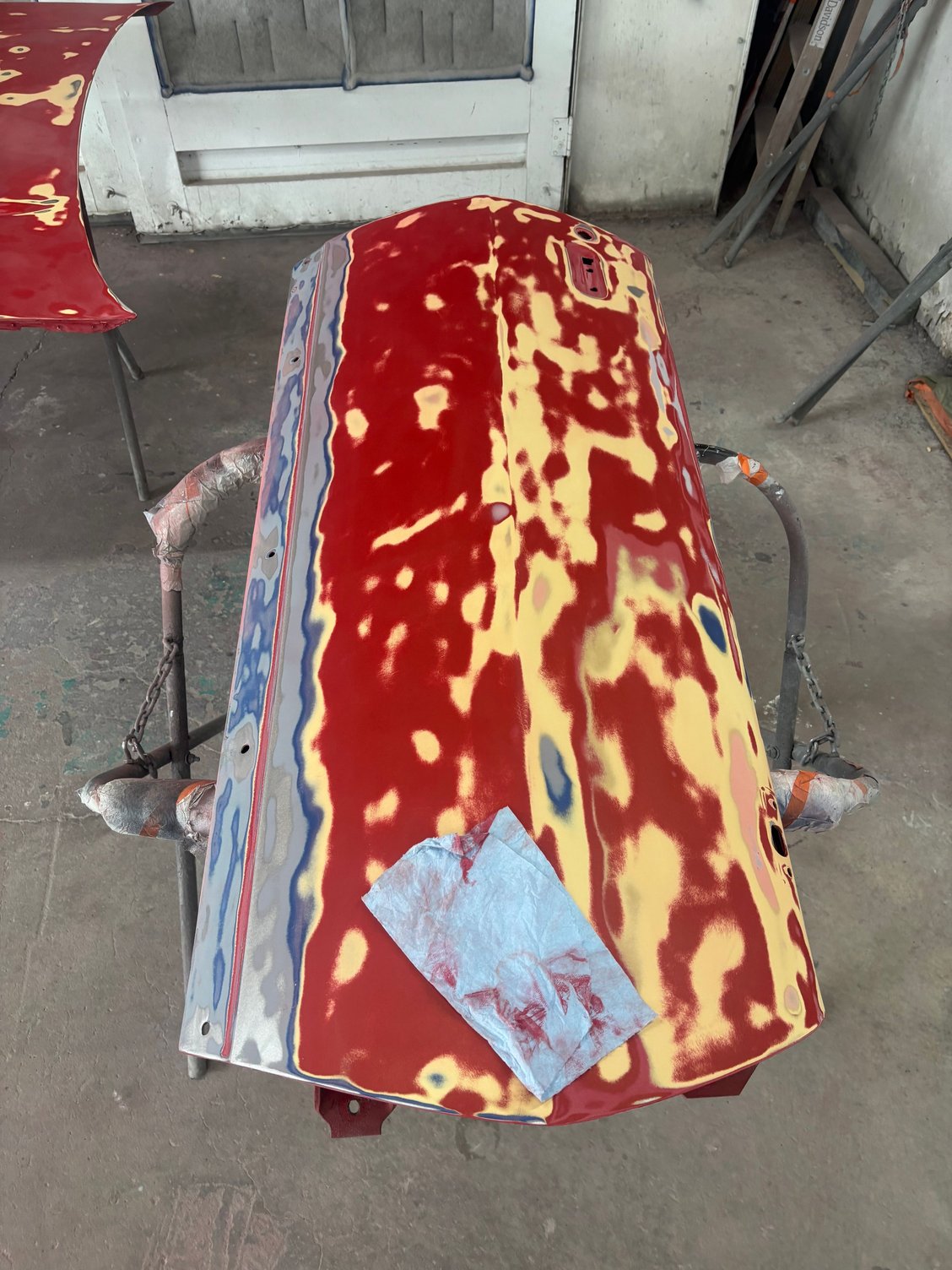

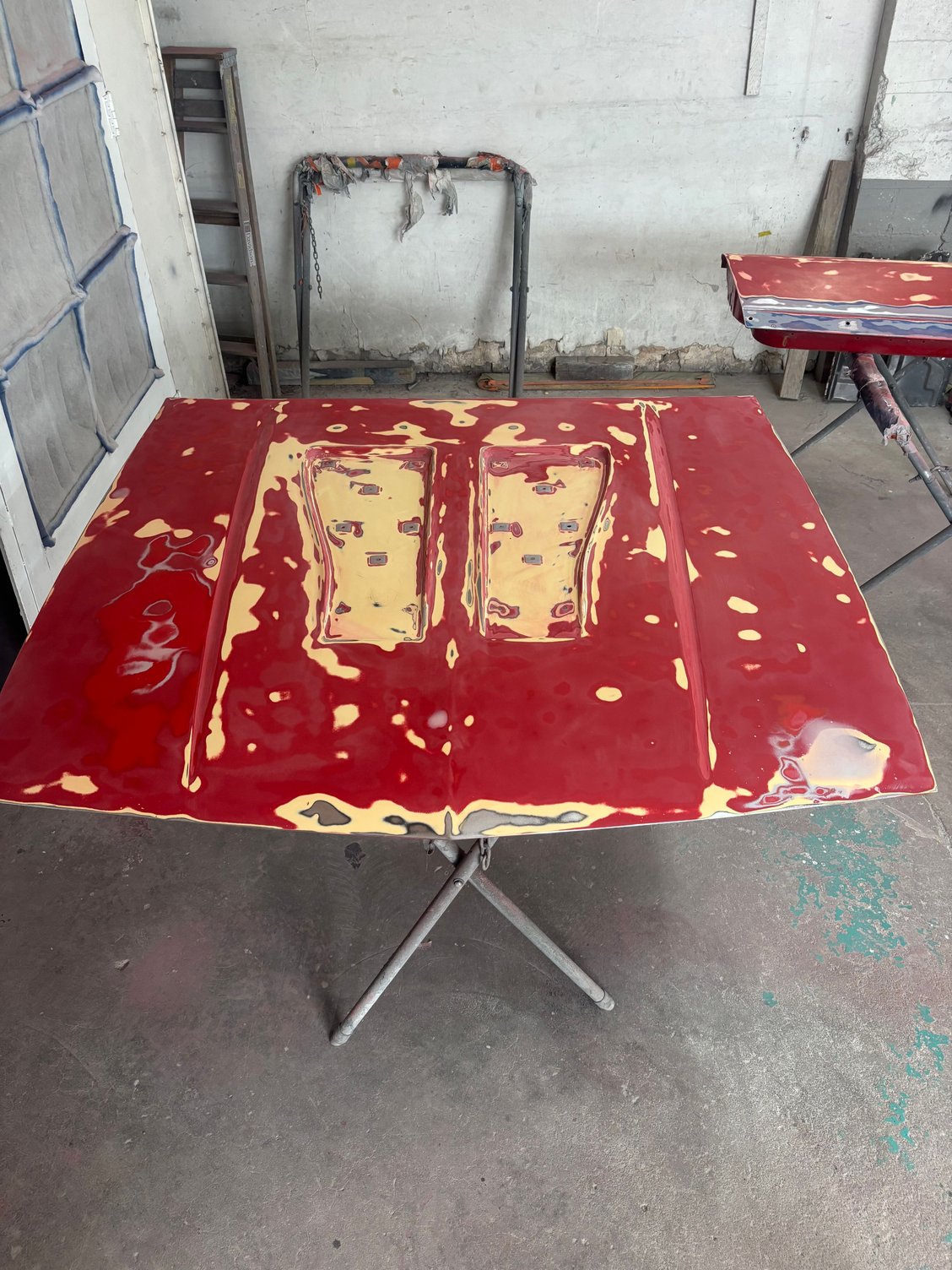

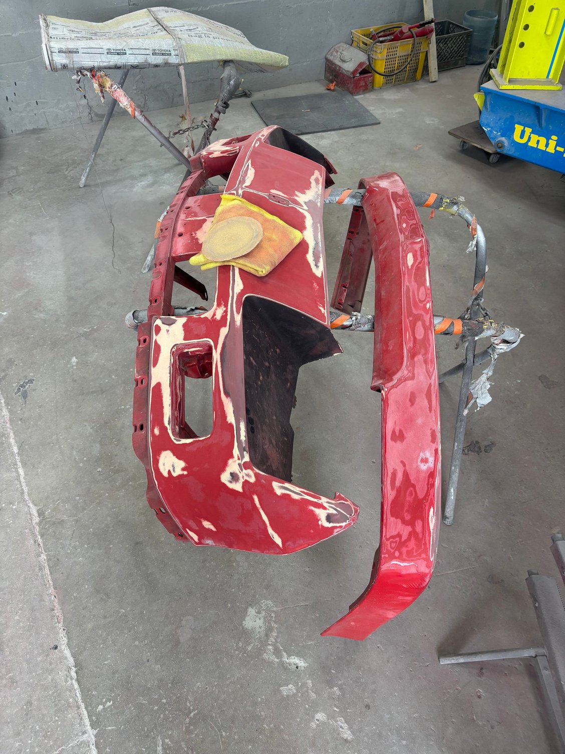

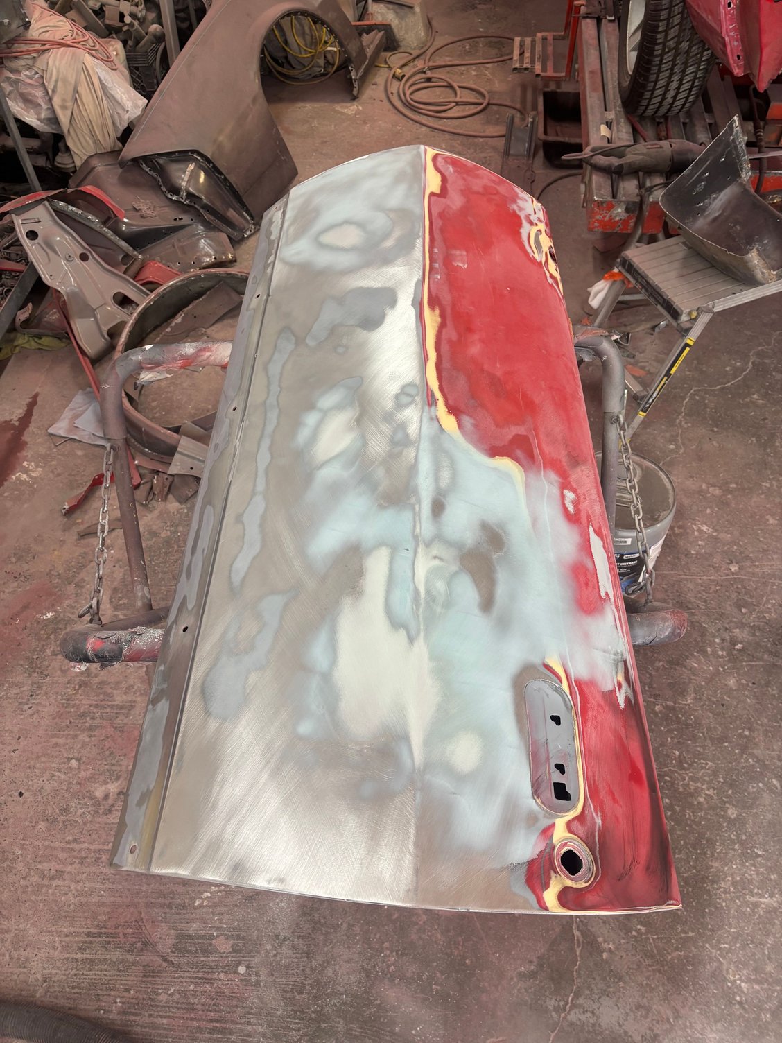

Today I stripped the car to get it ready for body and paint. I just gotta do one more door and the driver side seals tomorrow.

That floor and tub appear to actually be in really good condition, likely worth the effort. It should be a nice, solid platform once you've finished the project.

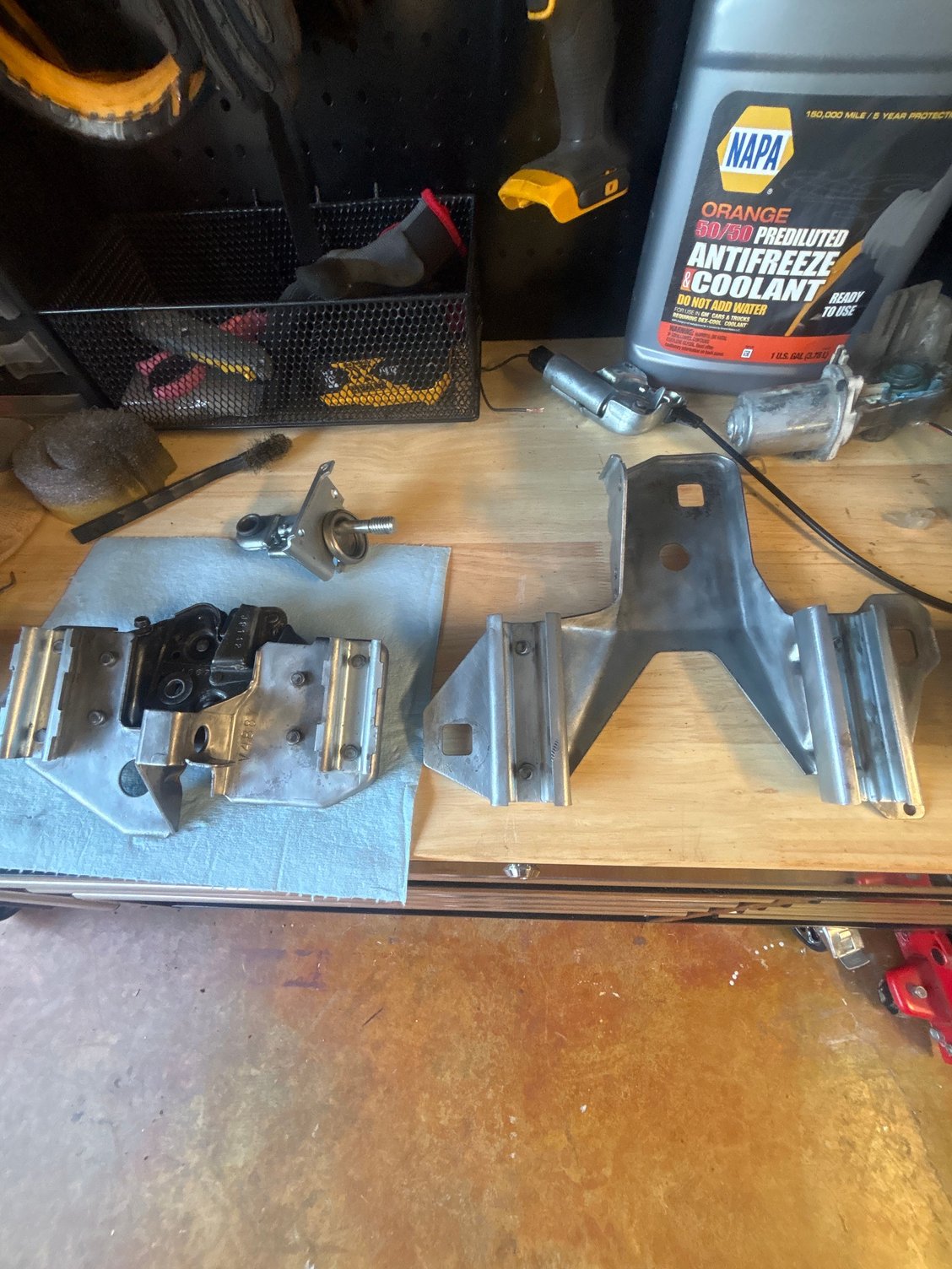

I was just informed by my body/paint guy, that I have to take the windows out. I've been looking for documentation on how to do this, but I'm falling short. Does any one have any instructions/documentation on the topic, or know where I could find it? For context, I'm planning to replace also the door latches, door lock actuators, and window motors at the same time, if that makes the process easier.

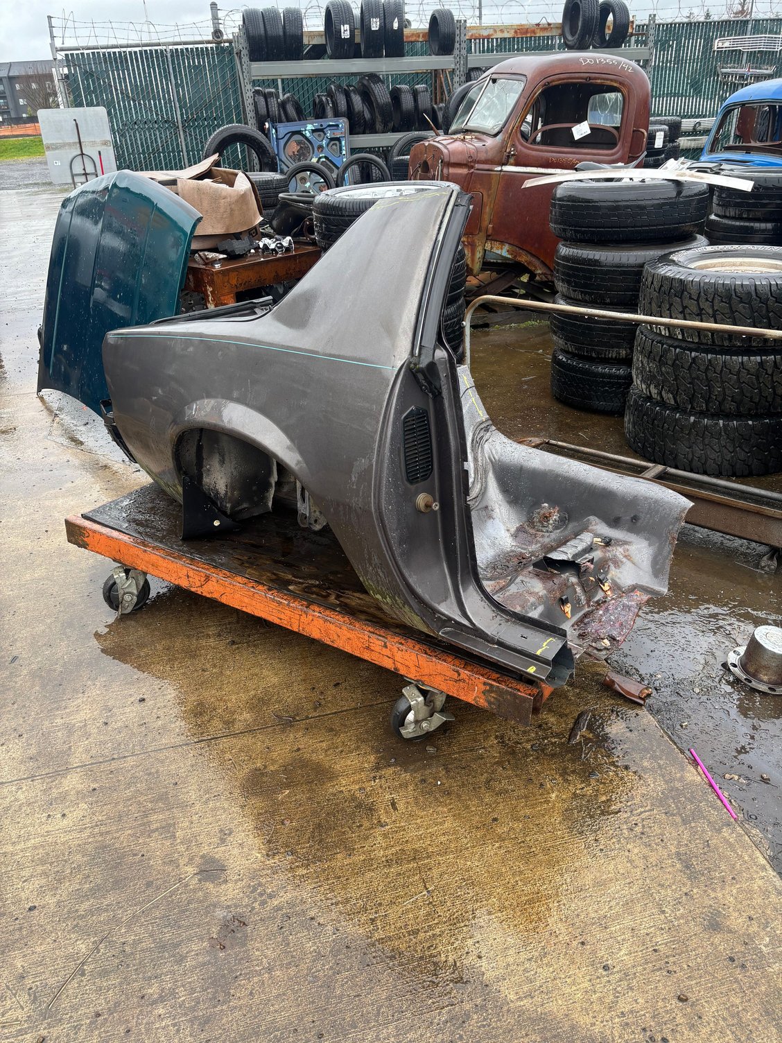

My donor quarter panel. The car will go in the body shop in a couple of weeks, once I have the time and the weather to empty out the door windows and mechanisms.

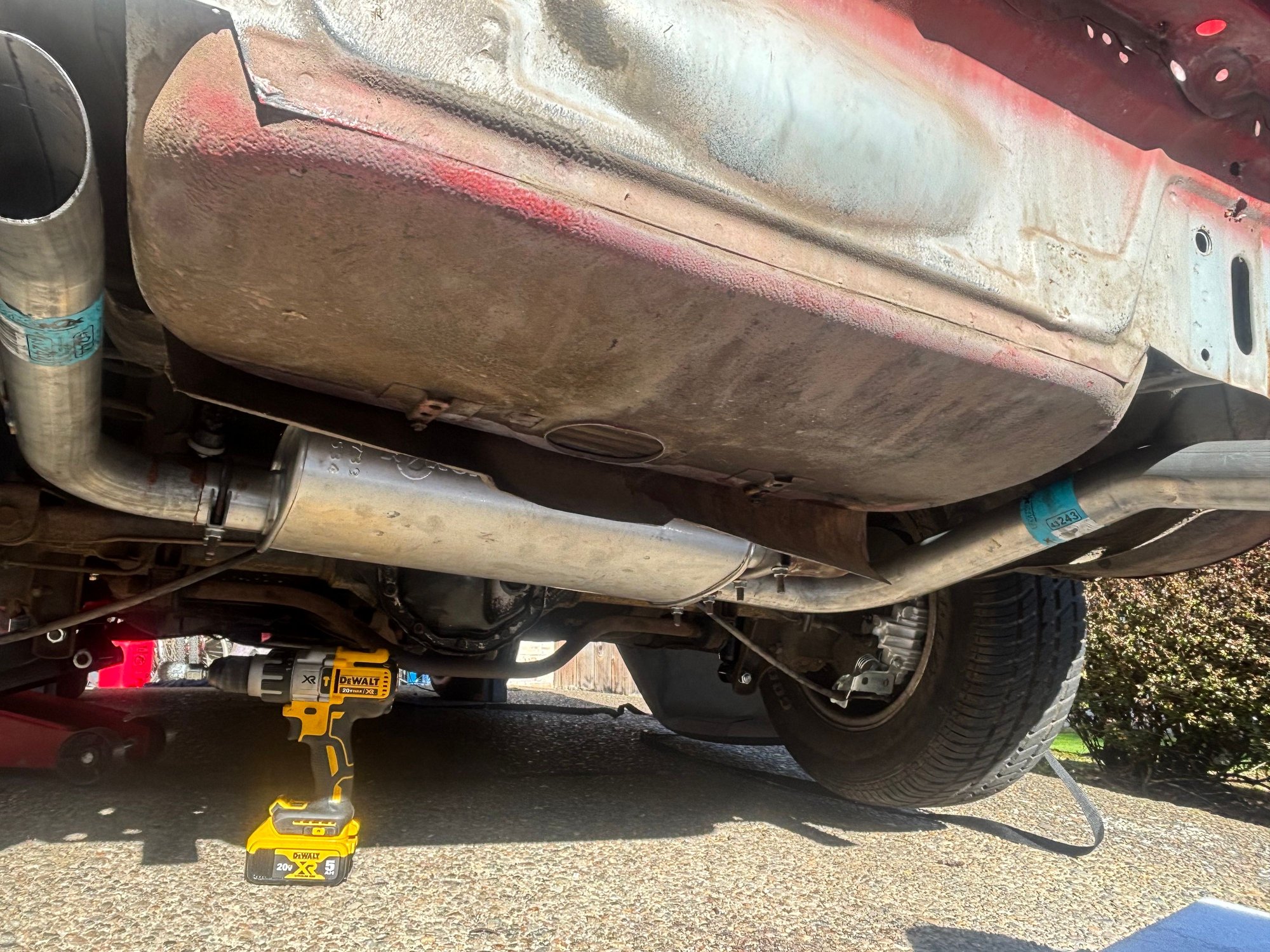

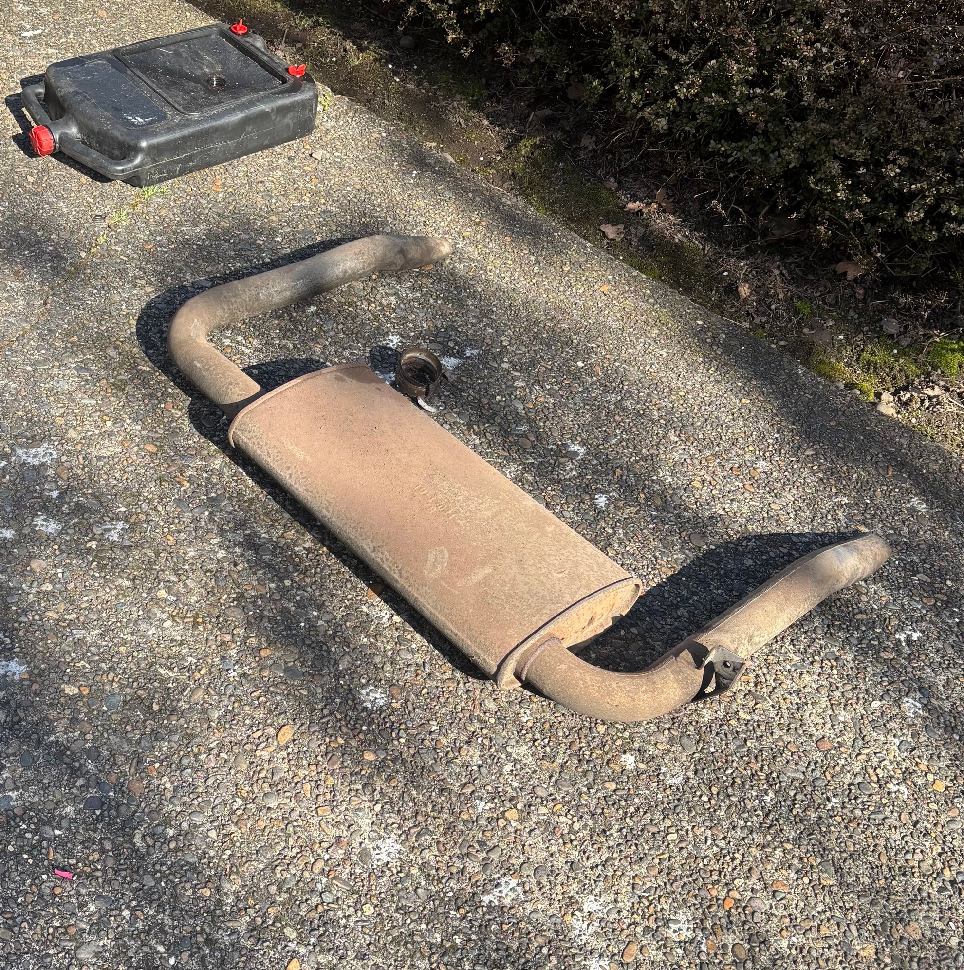

First i replaced the muffler and pipes
The old muffler.  It was clamped on at the inlet, so I was able to do it all without any welding or cutting of the original pipe.  Once I removed it I saw the whole interior had disintegrated.
The new one.
The new one.
Final product.  Some antisense and clamps all around so I’ll be able to remove it more easily than if need be for maintenance reasons.
Final product. Some antisieze and clamps all around so I’ll be able to remove it more easily than if need be for maintenance reasons. It sounds pretty damn good.

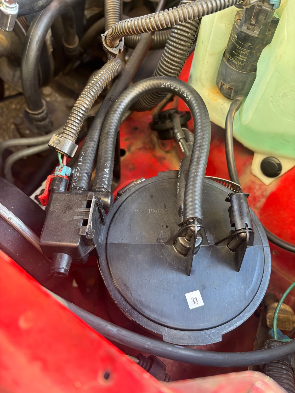

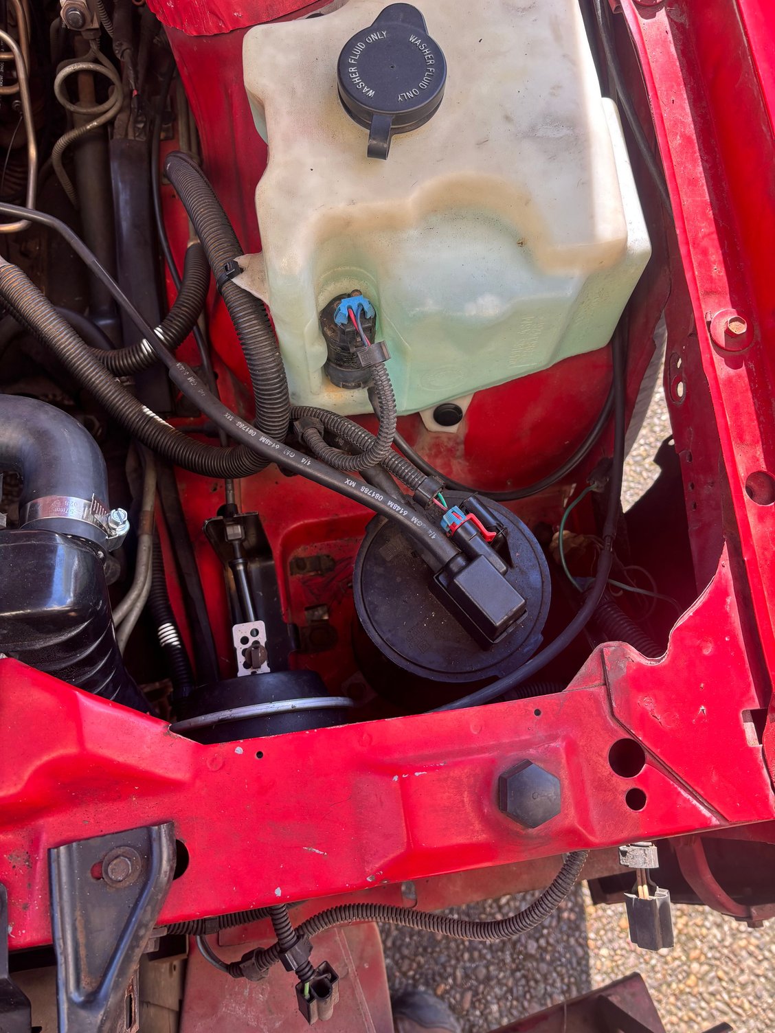

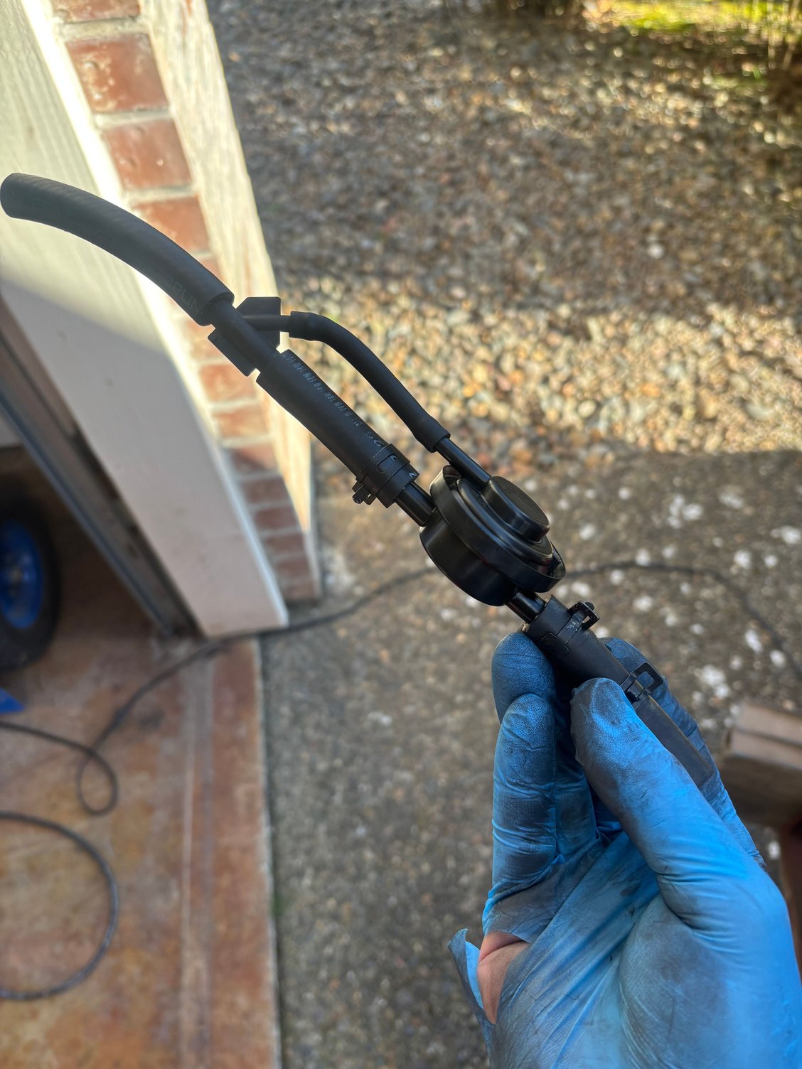

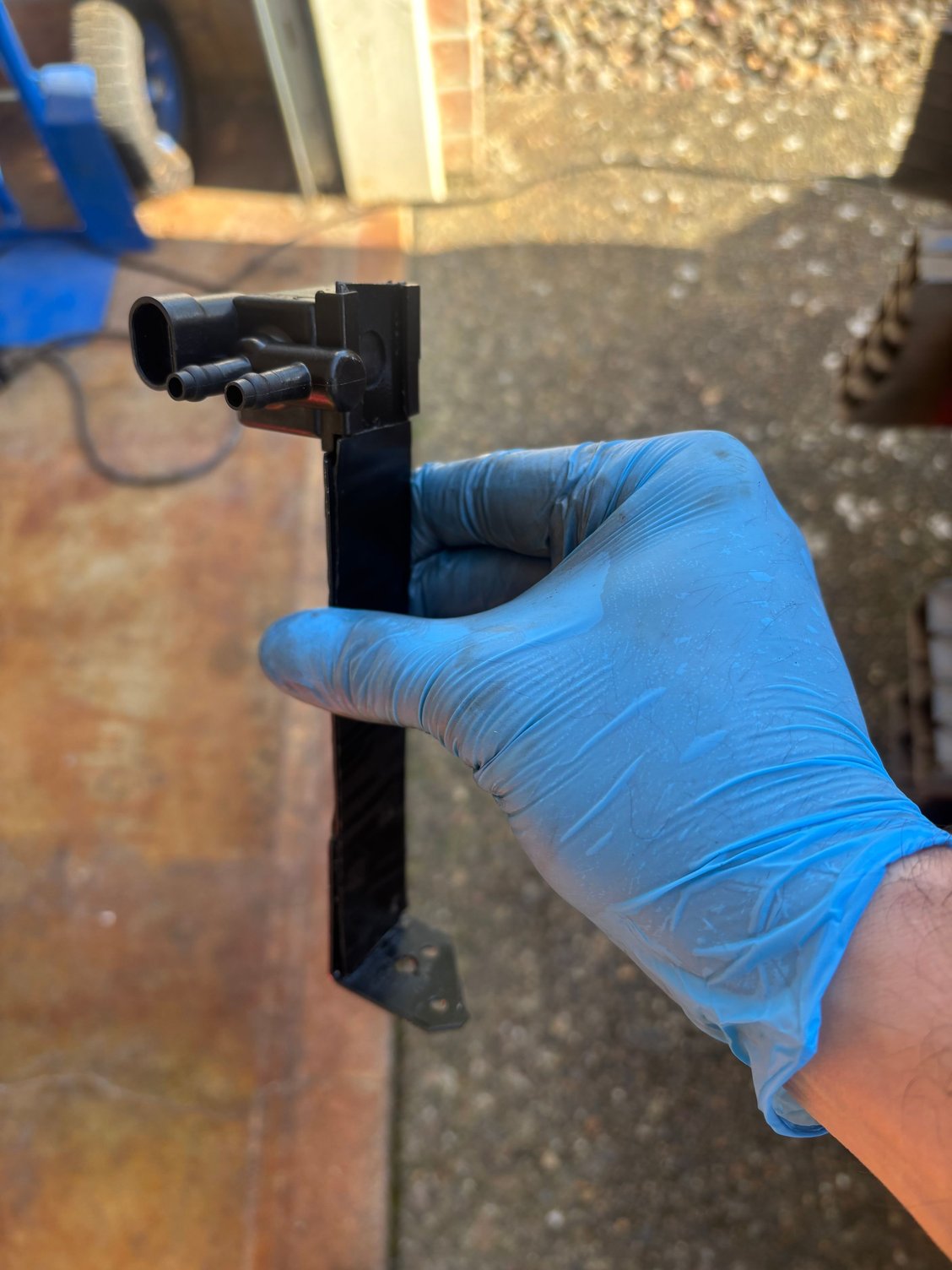

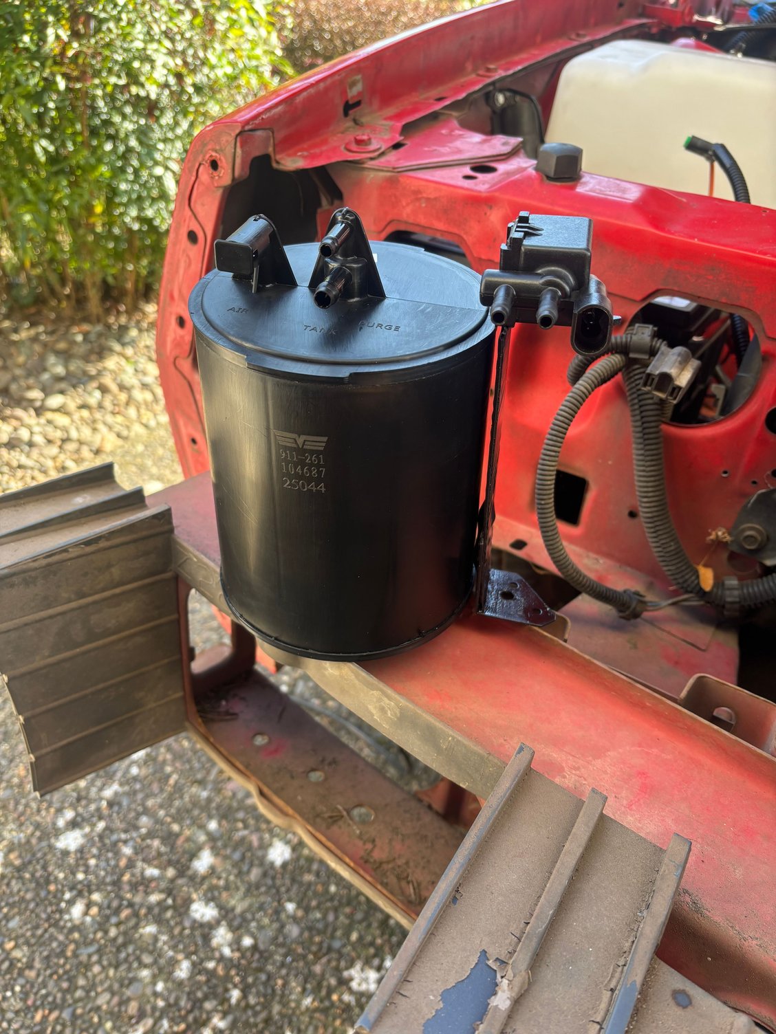

The next little project was kind of fun. I wanted to refresh the evap canister and purge solenoid/valve, but the part is discontinued.
This is the discontinued evap canister with the integrated purge solenoid.
Thanks to a video on youtube I found someone who had already came up with a solution to the problem. Different car, same equipment:
https://m.youtube.com/watch?v=hFrSDv5uHYw
These were the new parts that meet specs and that you can still source today.   You can find the part numbers in the YouTube video description.
I built myself a custom bracket for the purge solenoid with some Simpson tie down parts, cut it, spray painted it, and lined with with adhesive flash tape to dampen it/protect it.

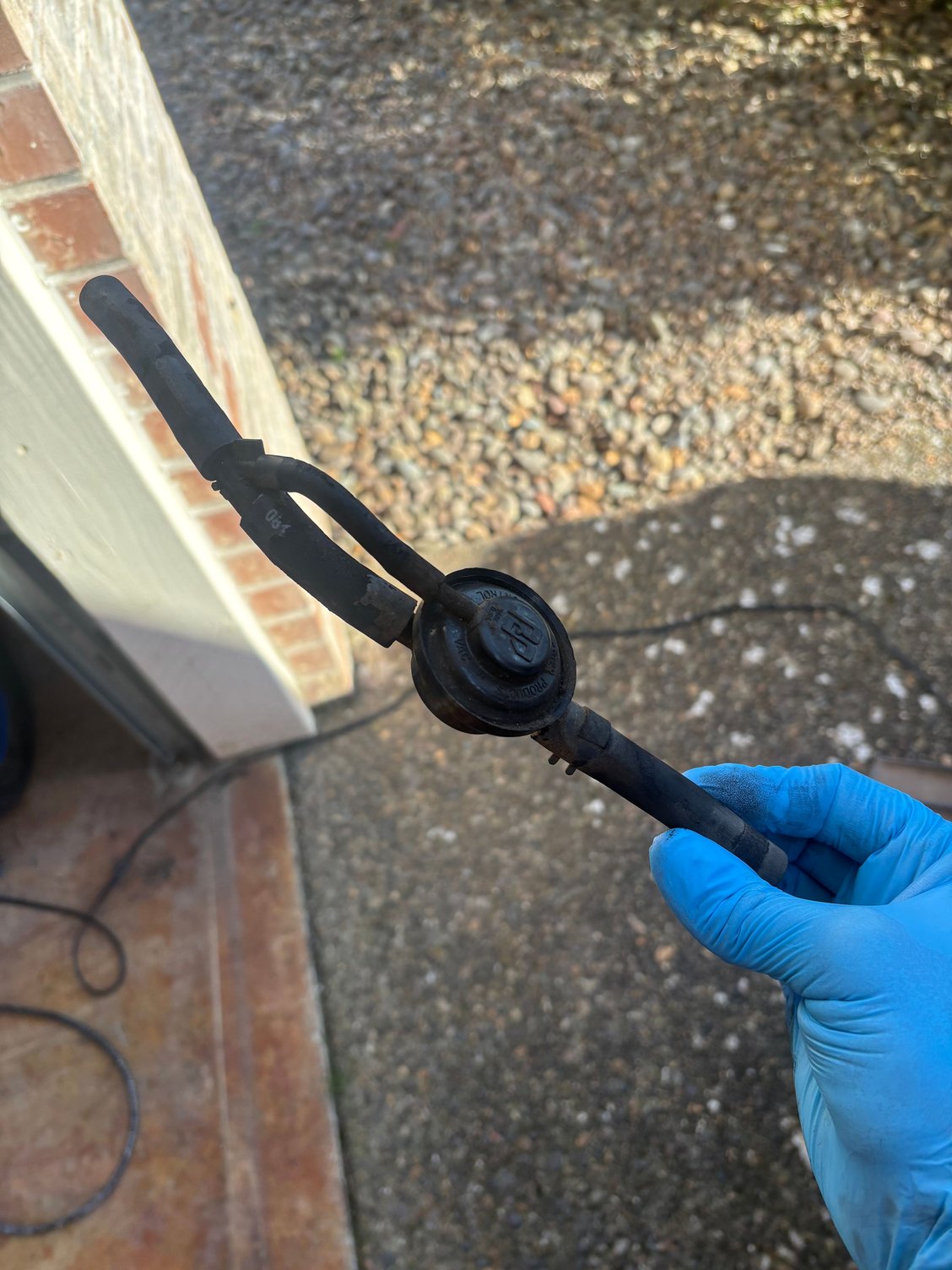

then I rebuilt the purge valve connection
The old one with old hoses
The new one with new new hoses
then I assembled it all like in the video and it works like a charm. One thing I added that wasn’t in the video was a tie strap around the top of the evap canister to keep the bracket buttoned up against it, preventing it from rattling.
The finished product.
I also replaced the gas tank vent valve, but I didn’t take a picture. That definitely helped with the cold start crank; there is nothing left to replace in the fuel system, so I’m going to say that’s as good as I’m going to get it.
All in all, a very productive day.

Ok, the car is out to the body shop where it will live for the next couple of months.
In the meantime I have a pile of car parts to clean.

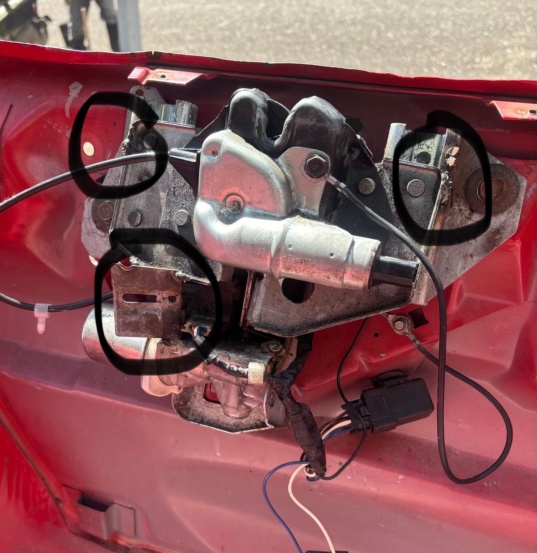

also, turns out that when the trunk hatch motor goes out, people just weld them fixed, instead than fixing them. I didn’t know that was a thing.
so, I found one at a junk yard and will rebuild it. Please note all of the black on it is not paint; it’s grime.
And these are the cleaned parts after I took them apart, cleaned them and prepped them for the rebuild kit that’s coming in the mail tomorrow.
there are literally a 1000 small projects to do while I wait for the body to come back lol.

I’ve been quiet for a while while waiting on the body, so I thought I’d post some pics to show the progress.
far from over, but good progress.
