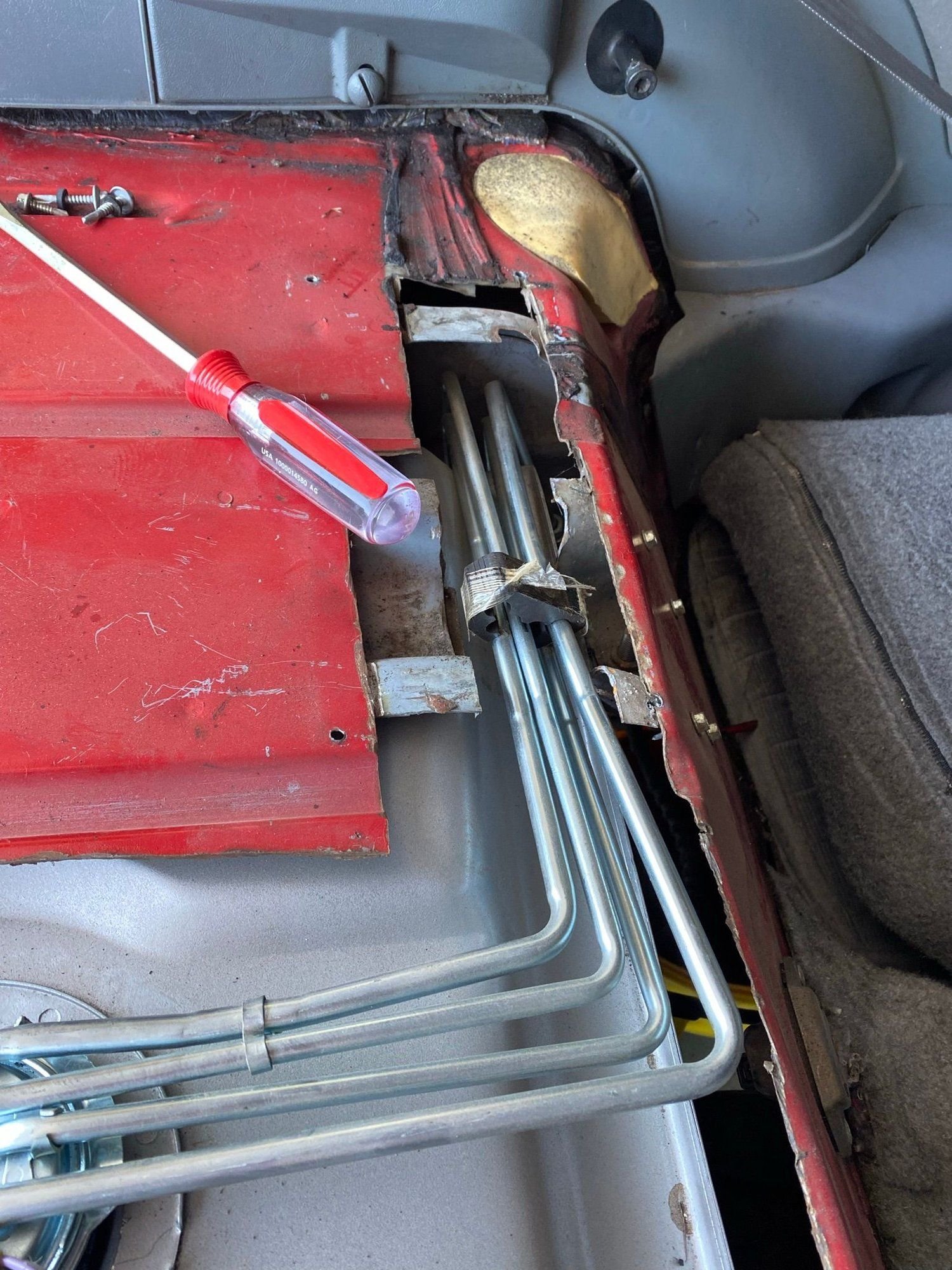

There is nothing about a fuel pump that would influence a car purchase. I would rather pull an engine than deal w pulling the tank hands down. Next time my tanks is out I'll do an awesome trap door. Not some sardine can looking POS.
PS, I wouldn't buy a car that had a duct tape/sardine can trap door cause that's an indication of the rest of the work done to the car.
I used to have an inline fuel pump feeding my efi. The pump was hot and loud. I switched to an in tank pump. It's much quieter and I assume cooler as well. The in tank pumps are a much better route despite having to pull out that miserable tank.

The neck is what makes it miserable. If mine ever comes out again, I'll use a 4th gen "soft" neck and it should cut half the time.

You're in an absolutely ridiculous mindset to think a trap door for the fuel pumps is a dumb idea. It isn't gonna **** with structural integrity, only you'll know it's there. The only reason I put a trap door in my car is because of Racetronix. Those pumps were absolute garbage and I got tired of dropping the rear end and tank and scratching my Midwest Chassis rear end to change those pumps. I cut in a trap door and it took me 10 minutes to swap pumps out.

I used to be against the trap door mod, but when done properly, such as a properly welded flanged kit, it's fine. I've been running the DSE one for years now and have zero buyers remorse.
Exactly! I've never been happier with my trap door. Just the thought of dropping the rear end and tank to take a pump out makes me wanna pass out
What kind of fuel pump hanger/sending unit do you have? I assume not the stock factory style because you can never get that out through a proper "Trap Door" mod.
Now a 4th gen tank with it's hanger/sending unit or something like that I'd have no problem with.
I wouldn't give a plug nickel for a car hacked up with a "Trap Door" mod you could get a factory style hanger/sending unit with its fuel and vent lines out of.
I was smart enough to cut those stupid hard lines back with my new tank to never have to worry about any of that. The factory chit is just that.... Chit. I cut my lines way back and used compression fittings to an lines. You're delusional sitting there high and mighty thinking the "factory" way is always the answer

Oh no I think they way GM did the 3rd gen tank, hanger/sending unit and fuel lines sucks.
The 4th gen setup is night and day superior.
I'm talking about the people that think they going to change the fuel pump the "easy way" because lifting the car up and doing it right by taking it out the bottom is too hard. They get in there happily cutting away where they think they should then realize the metal lines run over the tank and down the side of it and now they cut the back end of the car open like a sardine can from front to back and all the way over to the driver side fender well.
I wouldn't give a plug nickel for a car that had that done to it. I inspect every 3rd gen my friend and I look at to make sure that hasn't been done to it.
I'm not "hi and mitey", but I wouldn't be "down" with compression fittings on fuel EFI fuel lines.
Why not?? They're good to 250 psi made for fuel and go straight to AN lines

If you're going from hardline to -AN hose you can skip the compression fitting all together by putting a 37° flare on the end of the tube.

This is what I am against.
89 GTA refresh - Third Generation F-Body Message Boards

Originally Posted by Airwolfe
lol.. yup. Whole lot of those. Frankenstein's monster.
That's absolutely wild! I cut all my hard lines back and staggered before the 90 bend and made a nice clean hole and firewall.
