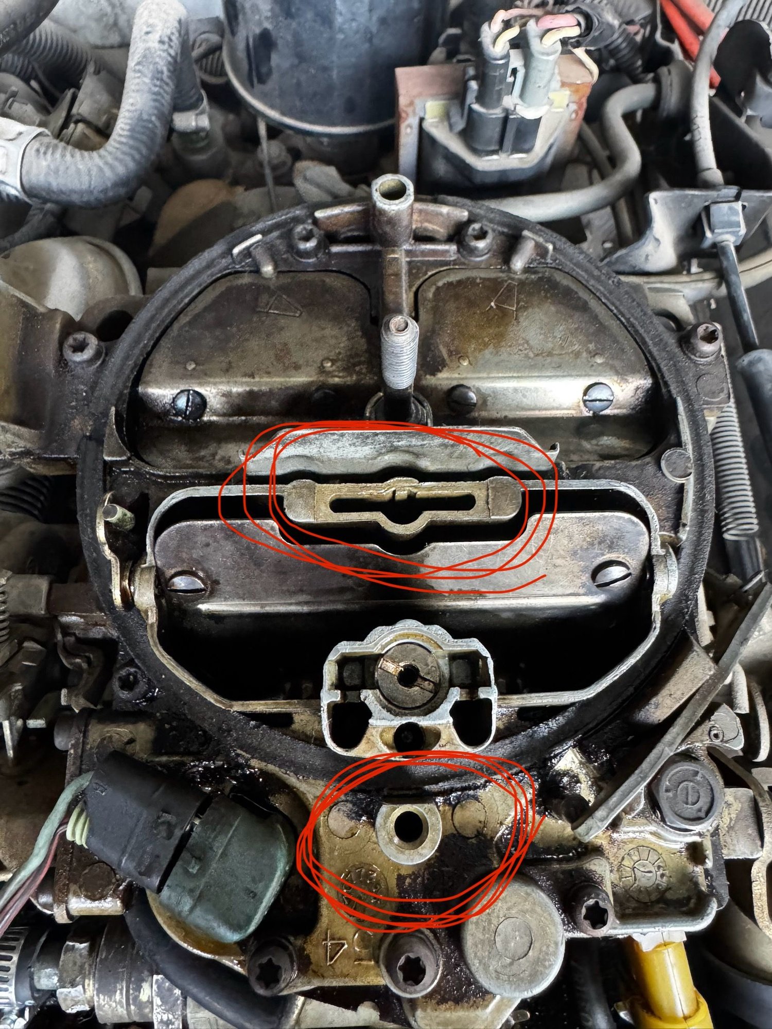

LG4 Carb Spewing Gas
I have a 87 LT with an LG4 with the 4 barrel carb and I just replaced the fuel tank, pump and cleaned the fuel lines because the car has been sitting for a while.
When I try start it, it turns over but the carb spews gas out of these two openings. It has yet to turn on. I’m confused if I made a mistake or am I missing something here.
Leaking fuel out of these openings while turning over.

Re: LG4 Carb Spewing Gas
Sounds like either there's a layer of old varnish (dried fuel gunk) gluing the needle & seat in the carb together in the open position, or abuncha crud got dislodged and has now migrated to the needle & seat, preventing it from closing off the fuel input when the bowl gets full. Same basic cause in either case, just a different mechanism by which it applies itself.
So, no, not a "mistake" really, just a natural but unintended unfortunate consequence.
I also notice that it looks like the fuel filter hasn't been disturbed lately, meaning, it's probably also full of crud. It's inside that big nut right next to that Fuel Leeeeek Of Death you can see in the extreme lower left corner of your pic; which in turn probably is the result of somebody trying to get to it, and not holding the big nut with a wrench while trying to undo the little nut that hold the line in the big nut. They pretty much destroyed the line nut in the process and just cut the line and put in that guaranteed fire source instead. That's a disaster just waiting for the right time to happen. Butt change out the filter regardless; makje sure when you put in the new one, you put the spring in first, then the filter with the metal end against the spring and the rubber end showing, then screw the big nut back on CAREFULLY so as not to strip the threads in the carb.

  1. Junk in the needle & seat
  2. Needle and seat, or float, stuck due to varnish etc. buildup
  3. Return line from pump to tank not hooked up (let's roll up all the details of how this could be into ONE bullet point, including that it's simply missing or whatever, or, the pump lacks the fitting for it, i.e. it's NOT a "stock replacement")
  4. Return line plugged up somehow
  5. New fuel pump is defective out of the box
Among those 3 things, which although certainly not "the only" potential causes of this, I'd venture to guess will cover probably all but one in a thousand such cases.
Now which are the MOST LIKELY?
Right: 1 & 2. Time to pop the carb apart and make sure the needle valve is clean and free to operate, and the float free to do what its name suggests. For that matter in a car that's been sitting up, the carb itself may well be so full of varnish that it needs a teardown cleanup and rebuild ANYWAY.
I'd add that somewhere in the process of all this, it'd be A Good Idea to glance down at the pump, and verify that the return line is hooked up. If not, either find it and hook it up, or get a pump that has it, or whatever else it takes, so that it can be hooked up. Might be A Good Idea to blow out the return line back into the tank, if that hasn't already been down, to verify that it's unobstructed.
So there we are. Haven't spent a dime on anything but a carb kit and filter, which it most likely needed ANYWAY.
OK fine, all that is now in order, does it still spew?
No: close the hood and drive the car.
Yes: maybe the new FP is defective. It is ABSOLUTELY possible. Not particularly likely I wouldn't think (I've only changed out about a hundred of em in my day and never ran into that, butt hay, it can happen, right??), and CERTAINLY not the MOST likely cause of the symptom. IOW, there are other possible "explanations" to investigate FIRST, before that one. Butt then, if it turns out that that's The Problem, handle it. Take it back and warranty it, or if they won't, or can't because it's been installed, just buy one. They're CHEEEEEEEEP and EEEEEEEEEEZZZZZZZY to replace anyway.

Last I knew, AZ only had ones in EFI ranges (like 0-75 psi or something) which makes it kinda hard to read down around 5 psi..
Naah. I am in AZ and have a low-pressure fuel gauge. Neighbors who lived in their house 40+ years and moved gave it to me. I don't know how I lived without it. That, and my dwell meter, set to 6cyl. scale, brings me peace, knowing I can pass a 50 state emissions test.
