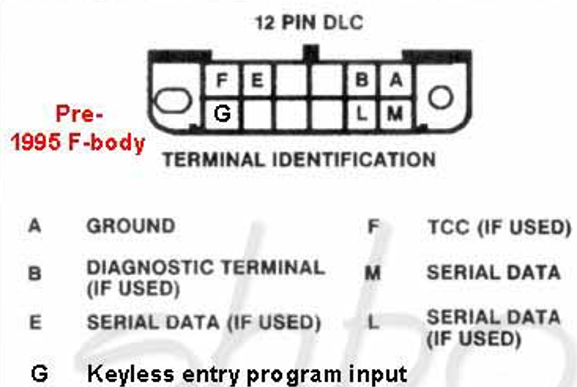

This is how to check for error codes on the ECM if you don't have a code reader.
The ALDL or DLC is located behind a plastic cover under the steering wheel.
Diagnostic Mode
If the "Test" terminal is grounded (Jump pins A and B) with the ignition "ON" and the engine stopped, the system will enter the Diagnostic Mode. In this mode the ECM will:
1. Display a code "12" by flashing the "CHECK ENGINE" light (indicating the system is operating). A code "12" consists of one flash, followed by a short pause, then two flashes in quick succession. This code will be flashed three times. If no other codes are stored, code 12 will continue to flash until the "Test" terminal is ungrounded:
On fuel injected engines, codes can only be obtained with the engine stopped. Grounding the "test" terminal with the engine running gives the "field service mode".
2. Display any stored trouble codes by flashing the "CHECK ENGINE” / "SERVICE ENGINE SOON" light.
Each code will be flashed three times, then code "12" will be flashed again.
On a fuel injected engine, if a trouble, code is displayed, a Diagnostic Code Chart from the service manual is to be used to find a problem.
If you do not have a service manual let us know what code(s) you have and we will look them up for you.
