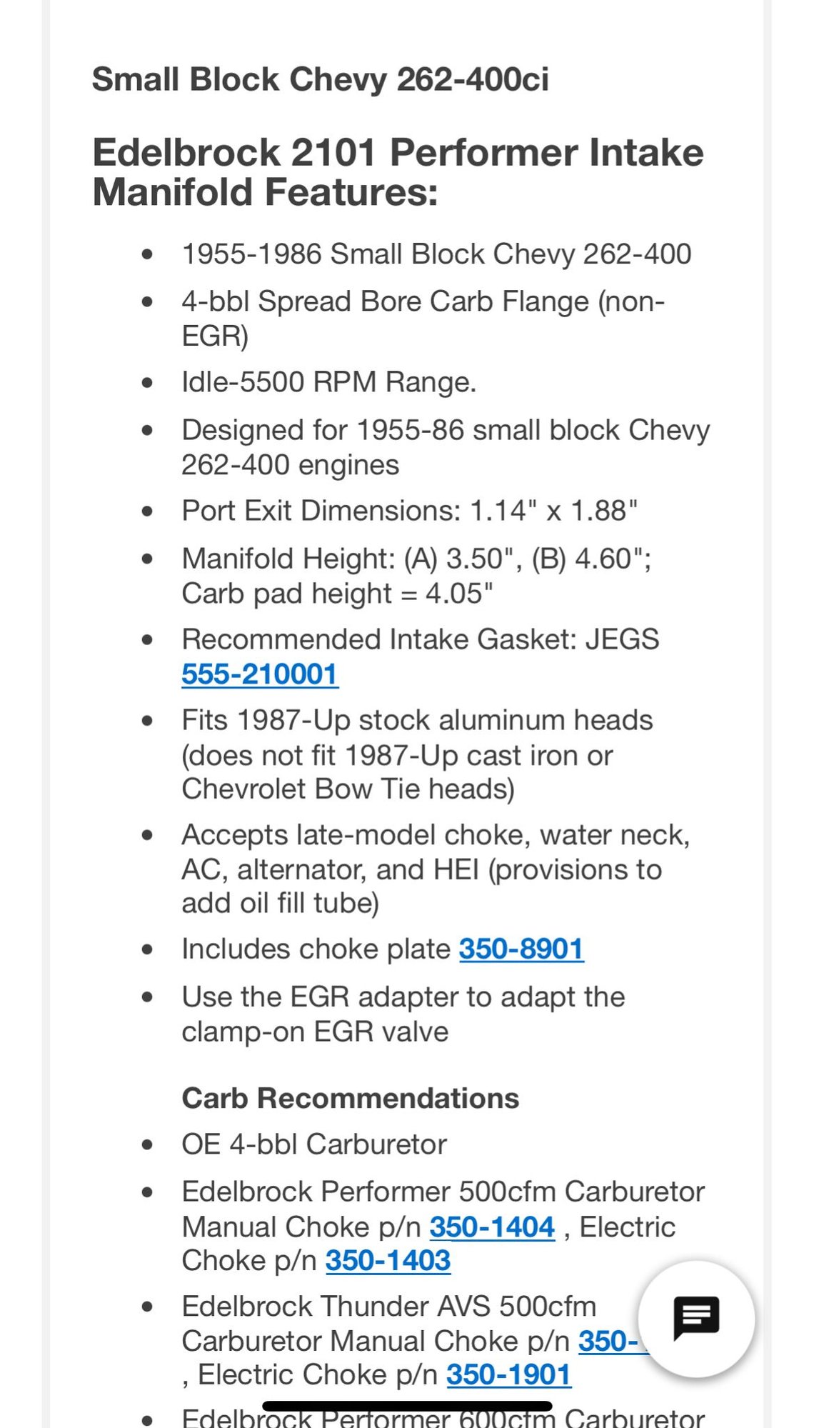

Re: Vintage edelbrock 2101 height
New one height
Appears they are the same height

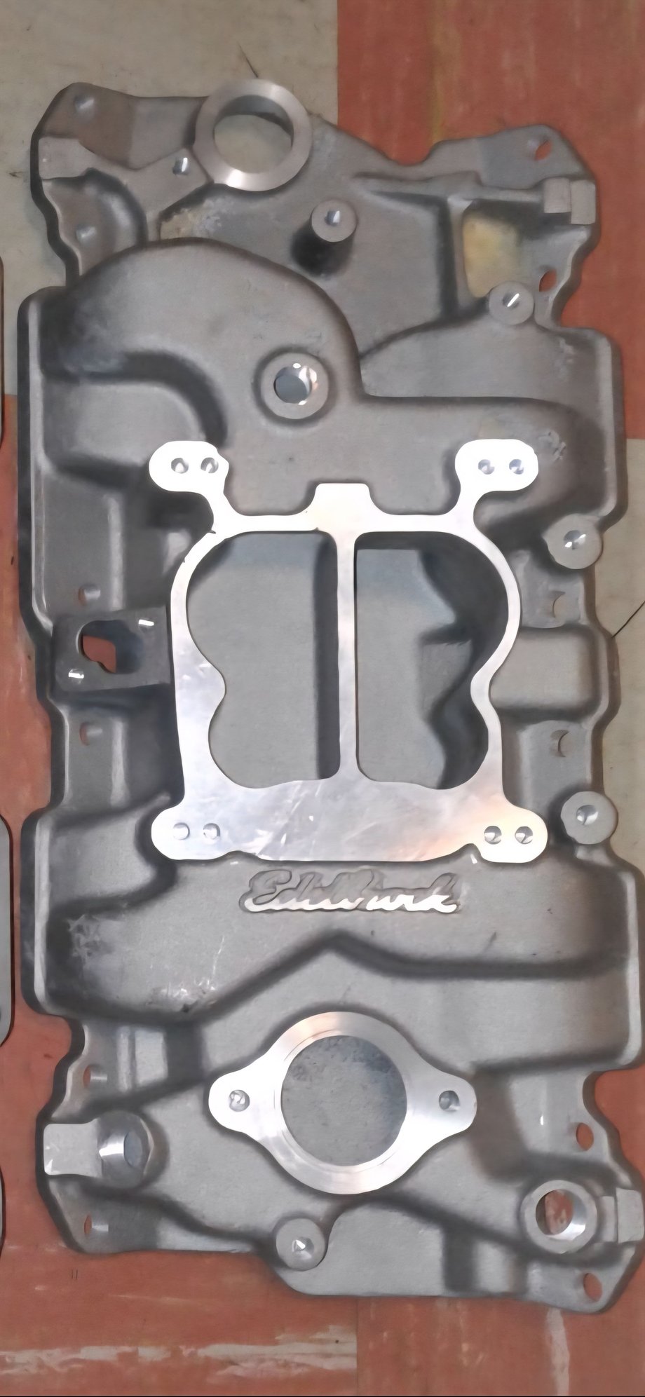

It appears these are all the modern 2101.
The old one is from the late 70s early 80s.
in my pic the vintage one has a much larger rear runner with a sharper 90 degree bend....

I'm not sure on the stock height.
Edelbrock told me the carb height of the vintage 1st design is 4.00" vs the modern 2nd design of 4.05".
But they have not told me the front and rear height specs (A and B) yet.
