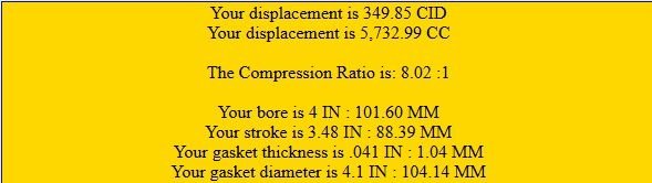

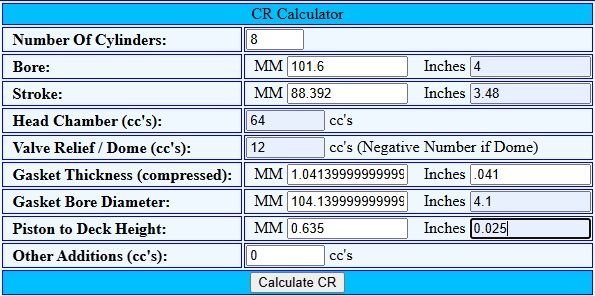

Do you have the actual specs for a Goodwrench 350? I think there may have been some values assumed but to dial it in further, as in a cam spec, operating range, not to mention what you want out of it, details are nice.
Just about a full point as suggested.
Any street orientated SBC, especially one with aluminium heads, would give give a greater kick in the pants on the other side of 10:1. That's my personal opinion although I've learned that, tuning aside, compression is your friend. But as with friends, there's a limit.

Throw in an .026" head gasket and you're at 9.26 with .051" quench.
If there's confidence that the deck surface is sound then there's always a shim gasket at .015 or so. Now it's 9.49 and .040" piston to head.

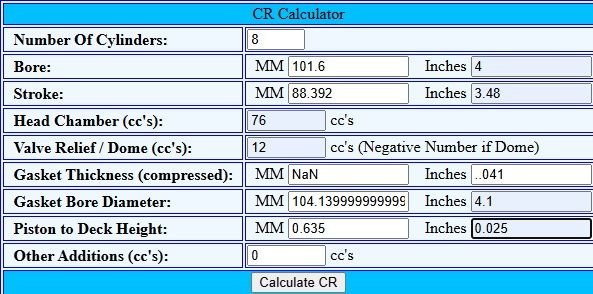

According to the "specs", compression is 8.4:1. Head gasket thickness is supposedly .026" to .028" x 4.100".

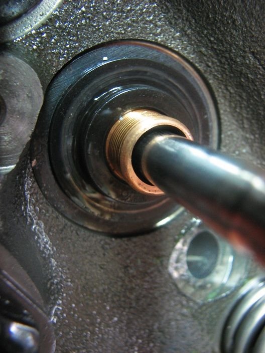

Any time you change some aspect of the valve train it will affect the relationship between the rocker arm and valve tip.
Let's say the geometry is presently good. That is the length of the pushrod places the rocker arm at the correct angle relative to the valve stem.
At the risk of sounding elementary, think of it as lever with the rocker arm as the beam and the stud as the fulcrum (which it is). The pushrod sets the angle of the rocker arm when on the base circle of the cam. If the geometry is properly set, the rocker arm will be at 90° to the valve stem when the valve is opened to mid-lift.
If a different set of heads has an overall shorter height, then to maintain that 90° angle, a shorter pushrod is required.
The same conditions might come into play if a different cam with a smaller base circle, rocker arms, block decking and or head milling have become part of the picture.

One variable in the geometry is the cams base circle. I/we have no way of knowing what they might be other than measuring or finding someone that has.
Even a custom cam such as my own, it was explained to me by the cam grinder/designer that any given base circle he comes up with is determined by the maximum lobe lift and what will fit into the cam tunnel. So it that regard, each may be unique. Between the OEM and Comp? I couldn't say.
Would it be much and would it have much impact? I think it was mentioned that at this level as stock or nearly so, there's probably not much that would go sideways.
But, if you drag a new set of heads into it, things get complicated.
Take two Edelbrock heads (as an example). When they offer two chamber sizes, how is that achieved? Two different castings? Maybe but it seems unlikely. The easiest thing ( in my mind) would be to take the 76 cc head and mill it to arrive at 64 cc. Generally (a dangerous word) it takes .006" for 1 cc.
12 x .006" = .072". That's within the .050" pushrod length selection. Maybe the base circle difference adds to that? You can see where it's going. How about the difference between the OEM and the aftermarket heads in general?
All that said, it's not difficult to measure.
Or you just have at it and see what the outcome is after a few thousand miles.
I'd done an extremely poor job when I first set up my Vortec heads with an aftermarket cam and rockers. I mistakenly went for a centred contact patch on the valve tip rather than trying to achieve the narrowest contact sweep. The saving grace was that the Vortecs had cast iron guides. My machinist said those suckers last forever.
But when I kept all of the above components and went to an aftermarket Vortec with bronze guides, I wiped them out in short order having incorrectly setting up the geometry in the first place.
I learned the hard way.

@sofakingdom you were right about that 66789 tool. It's useless. Perhaps it's meant for a bone stock cam but for the lingenfelter 74211, definitely not. I've been chasing a cold tick for quite some time. I used that plastic thing and it told me the correct length was 7.200. That's the tool flat on the valve tip and pushrod tip. That's also the stock pushrod length. I have flotek aluminum heads and scorpion 1.6 rockers so something wasn't making sense. Anyway this past week I took it apart... again. This time I did the mid lift method while using EOIC. That was an eye opener. Using the mid lift check I measured a pushrod length of 7.375. using the 66789 with that length, the valve side sits quite a bit higher than the valve tip. So that tool is very misleading. I believe I've solved the tick. Now it sounds like a sewing machine on the cold start instead of a jack hammer.
The midlift method is king in my books. And while I've never tried that plastic tool I knew enough about it to not bother trying.
All sorts of weird things can creep into the need for a different length pushrod. And sometimes it can't solved with just that. My RHS heads have .100" longer than stock valves. As such when getting the midlift geometry correct the longer pushrod was placing the roller tip right near the edge of the valve tip. Too close for my comfort level. The fix in this case was a roller rocker with a .050" backset trunnion. With the hole for the stud off-center towards the exhaust side, it drew the valve tip contact back. Result was a narrow sweep and practically dead centre.
That tool told me that my 7.200 pushrods were right. I think that was stock length to begin with, I had a rocker sweep over the tip of more than .100 wide. But the tool "indicated" I had the correct length. Live and learn. Now I'm running 7.375. I just wasn't sure if I was supposed to add the preload or an extra .020 to that using the mid lift method. I'm running around .035 preload on Hilift-Johnson lifters.
Live and learn.
Live and learn indeed. And sometimes learning can be expensive. Expensive as in needing new guides and yet another valve job. The bronze guides don't appear to have the same durability as the OEM Vortec cast iron versions. That may seem like a Captain Obvious statement but those cast guides will mask a poorly setup valvetrain for many many miles. The bronze guides, in my experiences, are definitely less forgiving.
