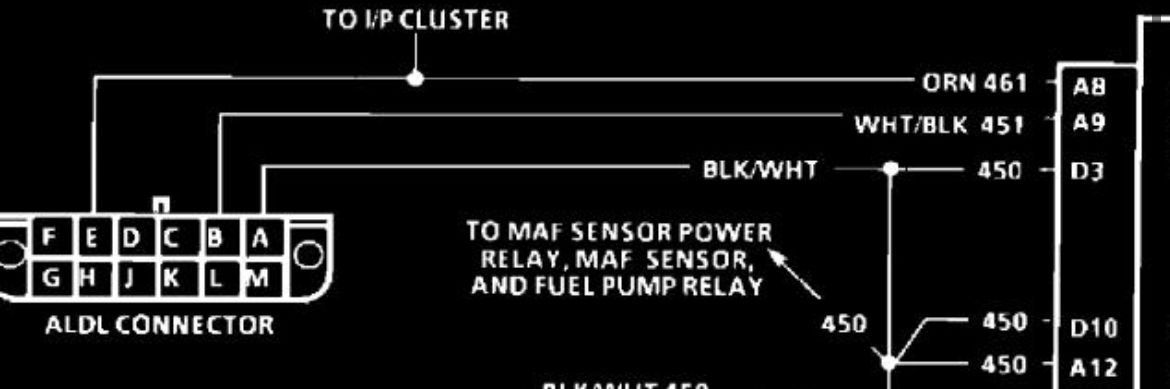

Sounds like two issues, tach board in the instrument cluster is faulty. The running your seeing 15-20 with est connected or that’s the base then it’s around 35 with est plugged back in?

Ohm est to Ecm d5, it should advance to 15-20 at idle depending on lv8

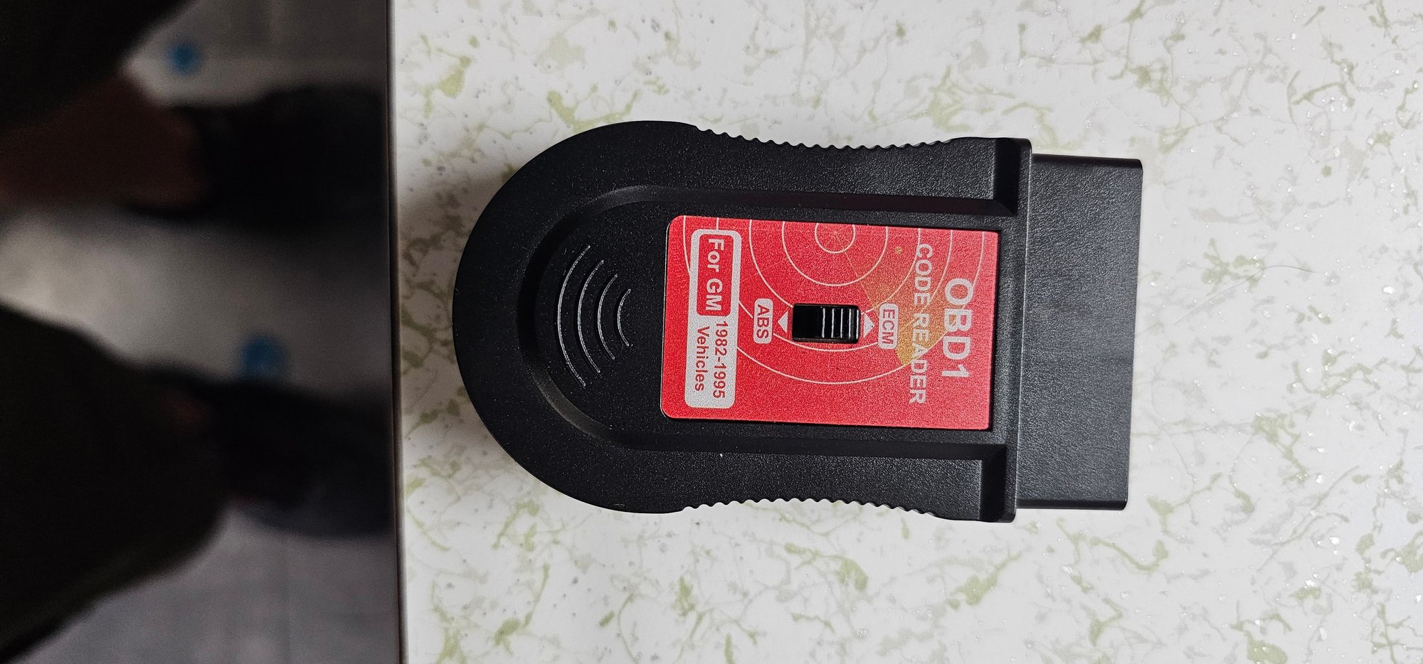

Ok, so I tried the paperclip method and the light just stays completely solid when I key on. So I bought one of these thinking it might work and it does nothing as well which is why it's leading me to believe I have a computer issue. No beeps, flashing, nada, service engine light just stays solid. Oh, and the radiator fan stays on no matter what.

That’s kinda funny, if you open up that tool it has wheel weights and is just a switch that connects a to b. If your wiring and ground at aldl checks out i would say it’s a bad 1227165 ecm.

To be honest before I got my Snap-on Scanner, I've poked the paper clip into the wrong terminals before. I would have loved to have had that fancy paper clip in a box thing back in the day. I don't see as good close up these days as I did back then. Even then, I didn't see all that good close up so if I didn't have a scan tool today, I'd have that thing you bought as long as it was cheap.
With the Check Engine light being illuminated all the time, it not going into diagnostic mode and flashing code 12 at you 3 times when you jumped terminals A & B, and the ECM not taking over proper control of the engine timing from the ICM I figured it would be the ECM or a wiring problem related to it.

You can ohm the ground and a9 continuity. I do have 1 1227165 ecm but unfortunately it’s an untested unit .

Yeah, I tried the paperclip. Didn't work. So just to double check I figured this thing was only 25 bucks and came with a book for OBD1 codes for every gm. So I figured why not just to rule it out. What do you guys think about an remanufactured ecm? I see those online. Worth a shot?

The command to go into diagnostic mode requires B to be grounded. So if the aldl A isn’t a good ground or an open in the line going to the ecm you’re not just throwing parts at it .

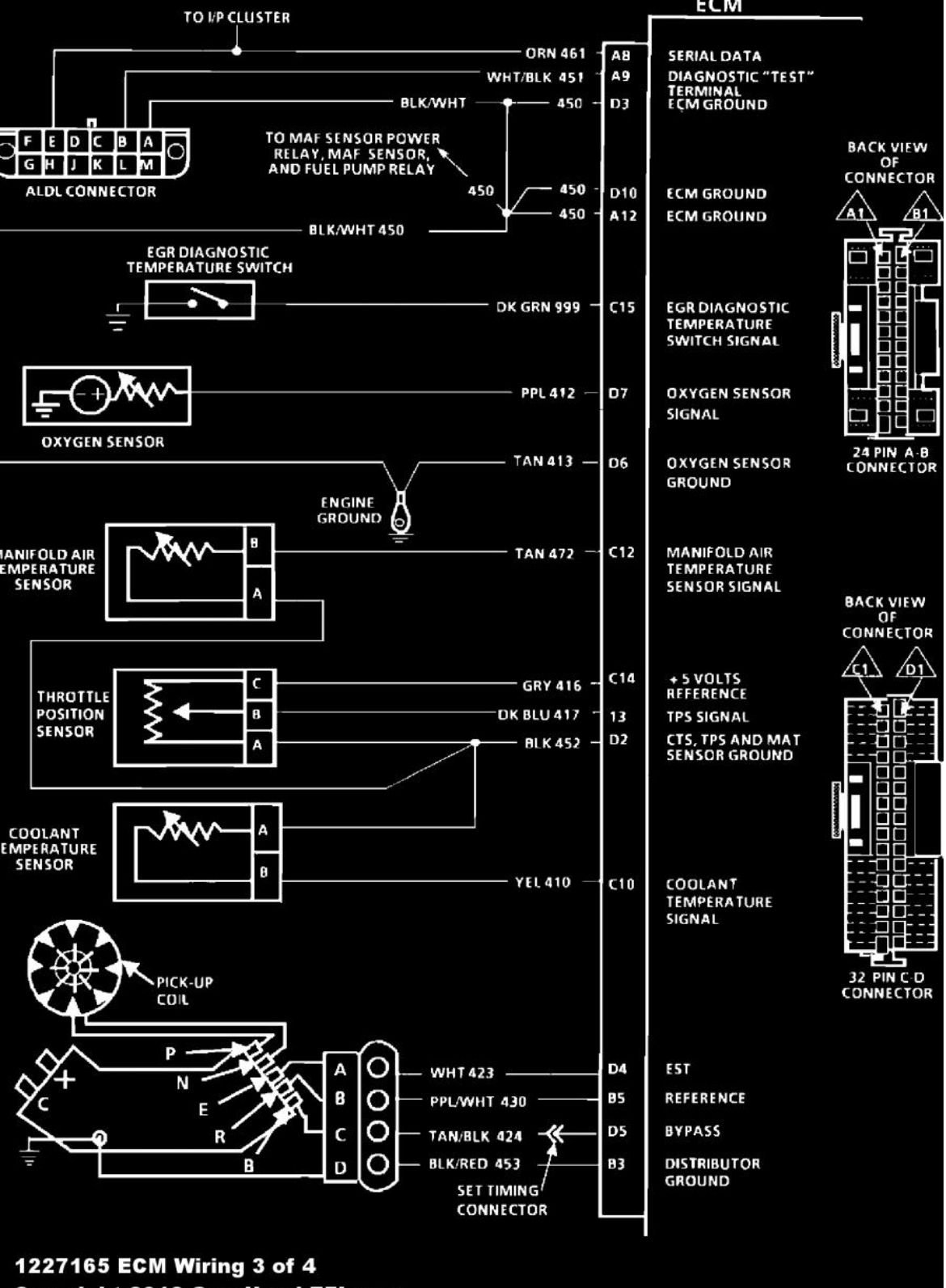

New developments. I installed the new chip just for giggles. At idle the check engine light started flickering, then went out. As soon as you give it throttle the light comes back on. Still can't check codes. The chip I had burned removed the need to run emissions. Car runs significantly better after tuned chip install. Fan still stays on, still can't read codes.
Just to be sure, this is the timing wire correct?

Just to update this thread Incase it helps someone in the future, turns out it was indeed a dead computer. Ordered a remanufactured one from eBay for $280 and it fixed all of my issues. Fan now kicks on when it's supposed to instead of just being on all the time. Check engine light is off.
