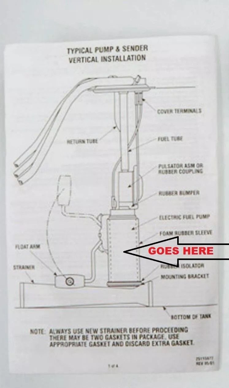

Just redid the fuel system on a 1989 GTA from the gas cap to the fuel injectors. Used a Delphi fuel pump and no pulsator. Runs just fine. Did a 1986 GN with a Walbro fuel pump and no pulsator. Runs just fine. About to do a 1989 Turbo TA. Will be a Walbro without a pulsator and it will also run just fine too.
To be honest I'm not 100% sure what the pulsator does. I guess it was for use with rotary-vane or gerotor style fuel pumps.
Below is a crappy low-resolution picture I stole off eBay ages ago.
Rubber Bumper that goes between fuel pump and pulsator. Modern turbine style fuel pumps dont need either of those parts.
Rubber Bumper that goes between fuel pump and pulsator. Modern turbine style fuel pumps don't need either of those parts.
Cool video about Walbro turbine style fuel pumps.
Take away for 3rd gens since our tanks don't have the fuel well that always stays full is to keep the fuel level at least a 1/3 of a tank or more. Fuel is the coolant and lubricant for the fuel pump. Your 2002 4th gen has the fuel well built into the fuel pump module assembly. If you really hate replacing fuel pumps on 3rd gens then keep the tank from running low on fuel.
