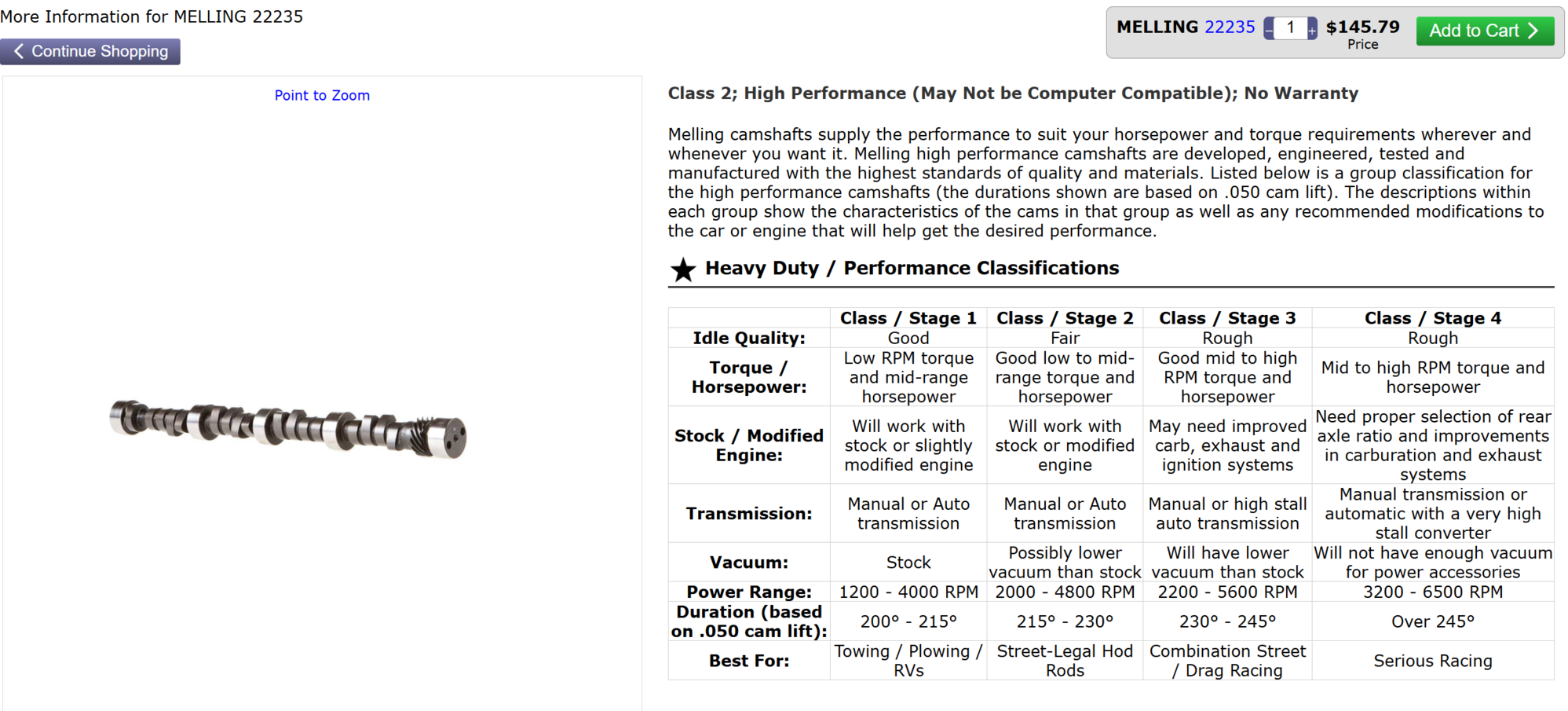

Firstly, does anyone have experience running a rockauto camshaft in their Trans Am or Camaro? I found this one for a pretty decent price imo, but I am unsure if/what I would need to modify (on) my car to run it. I would like to avoid a retune on the ECU as I am not currently savvy with PROM flashing, nor do I have the burner or chips. t
Currently, I have a TRUCKLOAD of work to do to my car. 3rd and 4th are gone (def a 700r4 moment), so a trans rebuild is on the to do list, it has a solid timing chain slap coming from the timing cover, so I need to install a new timing set (already have one, a nice cast iron double roller set), it smokes on startup (valve stem seals and possibly guides), mystery coolant leak (so probably seeping from a hose or head gasket), and an oil leak from both the oil pan and valve covers (yippee). What I am getting at is that the car is one or two parts away from needing a full rebuild.
Because of this I have decided to go ***** to the wall and throw some power adders at it since hell, I'm already going to just about strip it down to the long block, might as well make it fun!
This very long winded prelude is just so I can ask this: How much power can I expect to gain with;
Either the cam I have listed or the longest duration, largest lift cam that will sync with my stock ecu and fuel injectors (I understand it will be mild),

So would the camshaft I found work with my stock ecu and injectors? That's my biggest concern with this project atm. I know that the 85 is more forgiving when it comes to cam swaps due to the lack of a speed density sensor, but I'm unsure what the limit is.
That's a subjective "yes". What does "work" mean, to you? There are "Toon-o-philes" on here who'd tell you that the world will end if you run that cam w/o a tune. My experiences says that 224/224 is a lot of cam for a 305 on a stock tune, so while I wouldn't recommend it...I might try it for my own junk. I think if you were:
* Willing to dick around with injector sizing/fuel pressure and base timing
*O.K. with poor running, some stalling perhaps, and knowing that it's not optimized
.....you could run the wee out of it for a while and it could be O.K. enough. It's a personal judgement call.
There is no hard "limit"...where it works below a certain cam and not above it. The further you manipulate the shape and range of the tq curve from stock (and that's what more cam does)....the worse the engine will run on a stock tune. Again....224/224 is a stretch, IMO. It'll run and probably work...O.K. But you'll have to accept some drivability issues, I think.
IDk...someone else might, but I bet tq wouldn't change much unless you raise compression.
See, that's exactly what I was wondering. I have heard people mention 214/214 as being streetable without a retune, and I would greatly prefer to stay away from having to learn how to reprogram/flash an archaic operating language onto chip from the mid-80's.

If I decided to talk myself into running the cam I listed, what # injectors should I run, and what to I need to retune on top of that? Just tweak timing and let the ecu think it's the original injectors, or will that cause issues with the fuel tables that I will have to PROM flash to fix? I'm no slouch on a PC, but the earliest OS I'm familiar with is probably Windows 98/2000, and this car predates that by a good bit.
