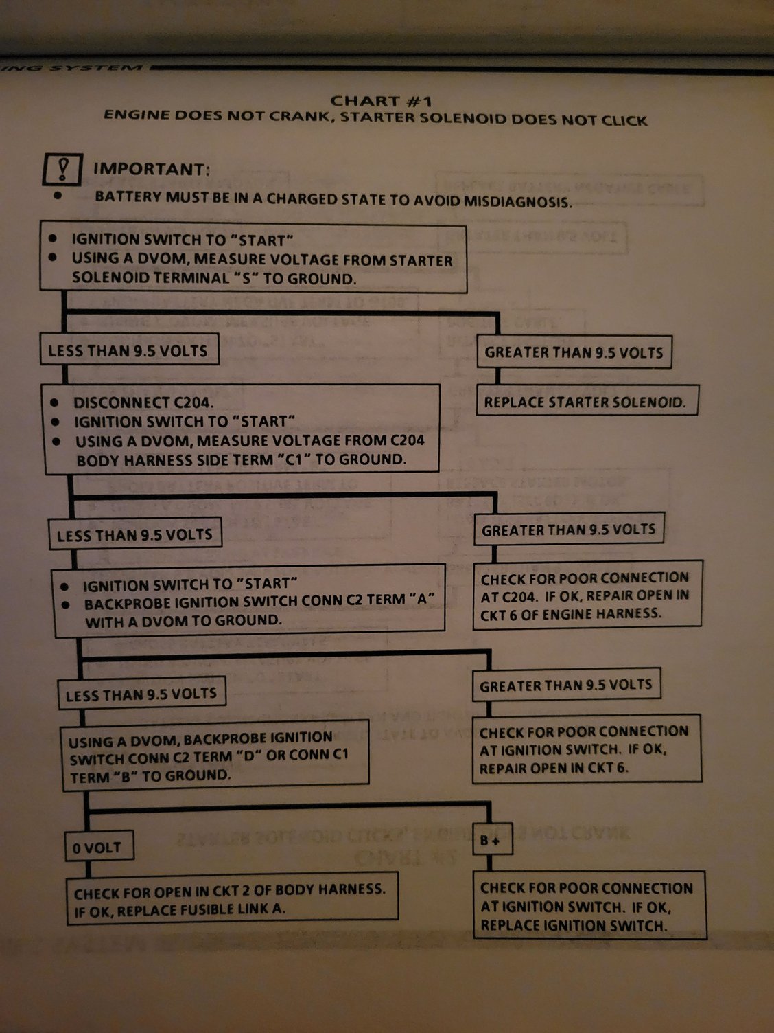

First of all need to diagnose properly. Get a wire diagram and voltmeter and start testing the key switch crank circuit for voltage starting at first connection from key switch. Keep going to the next connection until you find where it stops.

Quote: Get a wire diagram and voltmeter and start testing the key switch crank circuit for voltage starting at first connection from key switch. Keep going to the next connection until you find where it stops.
This is good advice. If you arent able to do this wherever the car stops working then I would start by replacing the fusible link by the starter. I have seen them do this before due to poor connection.

Understand that from your original post. What about all the connections from key switch crank signal wire down to the starter. Any of those could be corroded, spread terminal making marginal connection, wire pinched, etc (connection at bottom of steering column, vats, ecm, relays, bulkhead pass through, etc)

Quote: First of all need to diagnose properly. Get a wire diagram and voltmeter and start testing the key switch crank circuit for voltage starting at first connection from key switch. Keep going to the next connection until you find where it stops.
Quote: This is good advice. If you arent able to do this wherever the car stops working then I would start by replacing the fusible link by the starter. I have seen them do this before due to poor connection.
^These guys are giving you the right advice. Do ^that^.
