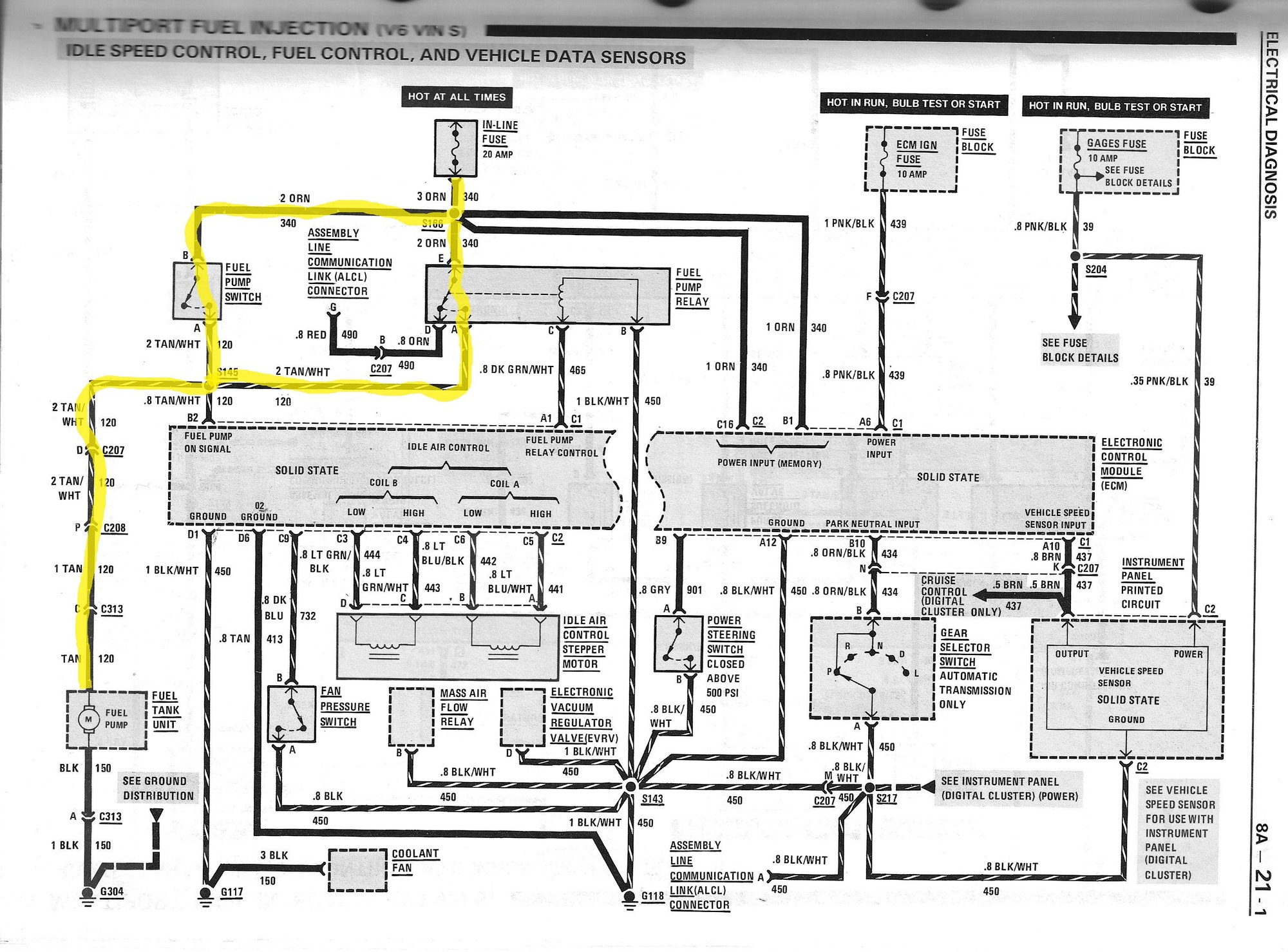

This is the wiring diagram of your fuel pump circuit.
In this diagram it starts at the 20A inline fuse and can travel through two separate paths. On the car it has to go from the battery through the key switch first.
1 path goes through the fuel pump switch which is actually an oil pressure switch that closes on about 6 psi of oil pressure and the 2nd path goes through the fuel pump relay.
Method one would be to introduce 12 VDC at the oil pressure switch terminal A and see if the fuel pump starts? Yes and the problem is between the oil pressure switch and the battery, NO and a bad connection or fuel pump issue is happening.
The oil pressure switch is located at the oil filter and this picture shows the oil filter and cap removed from the oil pressure switch.
Method two
Start testing one path at a time when the fuel pump wont start, key on to see where you are losing the voltage.
One thing to remember is that the pump only runs for about 6 seconds when you turn the key to the on or run position and then the ECM drops it out because normally by then the engine is running and the oil pressure switch and ECM keeps it on. This is a safety feature so the fuel pump relay de-energizes if the main motor stops.
