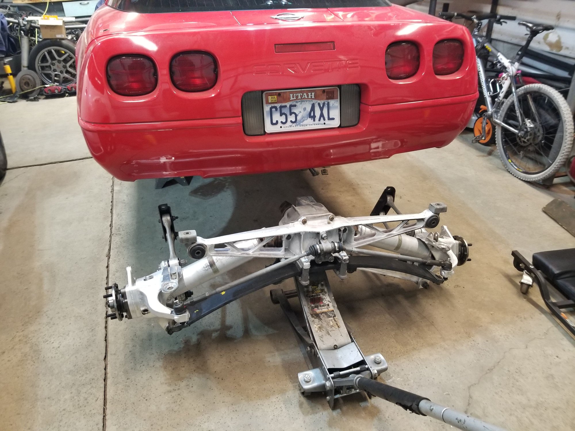

Yeah, jack stands are cheap. I did a 700>T5 swap back in the early 90's on jack stands....then a T5 to T56 swap in the early 90's too, on jack stands. Just did this on Jack stands.....
...and on, and on and on, countless projects for decades. Easy button. Also? Same tools, same procedure, same-same allows you to do corner work/wheel/brake/tire/suspension, etc. where race-ramps, linkin logs etc do not. Props for the initiative, but while you're doing carpentry, I was banging out a car project, and in between those, I store 4, 12 ton jack stands.
OP, w/o knowing the goal of the engine removal.... Remove hood fans/fan shroud. Remove the power steering pump from the engine, lay to the side. Same with AC comp. Disconnect Y from manifolds. motor mount bolts, tq converter > flex plate bolts, bell housing bolts (if T5, pull trans, leave bell housing on engine and remove slave cyl)
Drain all coolant incl block drains, unless you like messes. pull harness throw on the windshield, vac lines, fuel lines, batt cables, motor mount bolts, pull engine.
