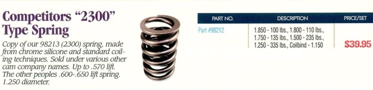

Here are the springs I got.
At 1.7" I figure the seat pressure is about 155#, subtract .492 for lift of the cam and there's still about .050-.060 til coil bind. So if I use the standard seat height, I should have ~355# at max lift. I think I've read that roller cams want 350# at max lift so would this work at standard seat height?

not sure what you have or what you've done, but basically match the springs to the cam. run the spring makers installed height, trash the factory rotators and go with aftermarket retainers.

the guy at the machine shop said 5# over the max recommended at full lift won't hurt anything so i'm leaving the seats alone and just taking .050 off my valve guides to clear the retainers.
