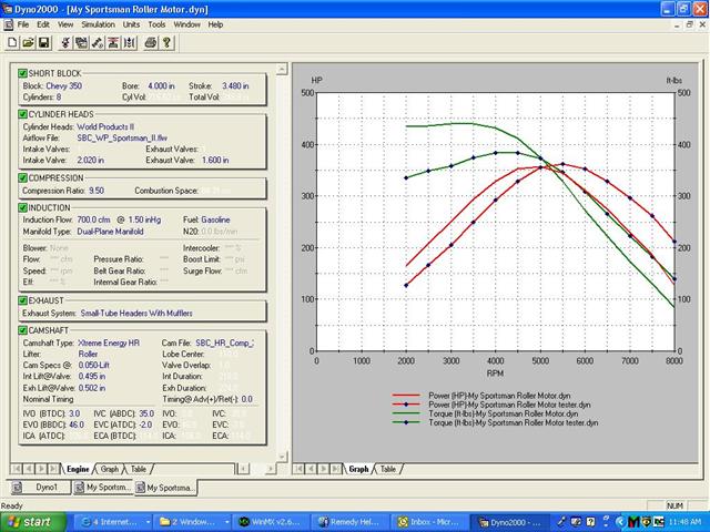

here a dyno comparison does it look acuate?

IMO it's worth it. A roller can have far more aggressive ramps to snap th evalves open and shut faster, so the valve spends far more of its time in a high-flow condition. As a result, you can get alot more performance out of a roller system than out of a flat with similar specs, without the "too big cam" problems like low idle vacuum etc.
You do need to use better valve springs though: a real (non-factory) roller puts a whole lot more stress on them due to the faster valve motion. Believe the cam mfrs' recommendations in that area.

and, I don't think your get 50ft/lbs more torque just by using a hydroller. 20-30 is a little more accurate. And you'l get more than just 10hp. DD2000 is a little simplistic.

PS, don't compare it to the 270HR. That is an old version. Compare it with one of the XR series.
