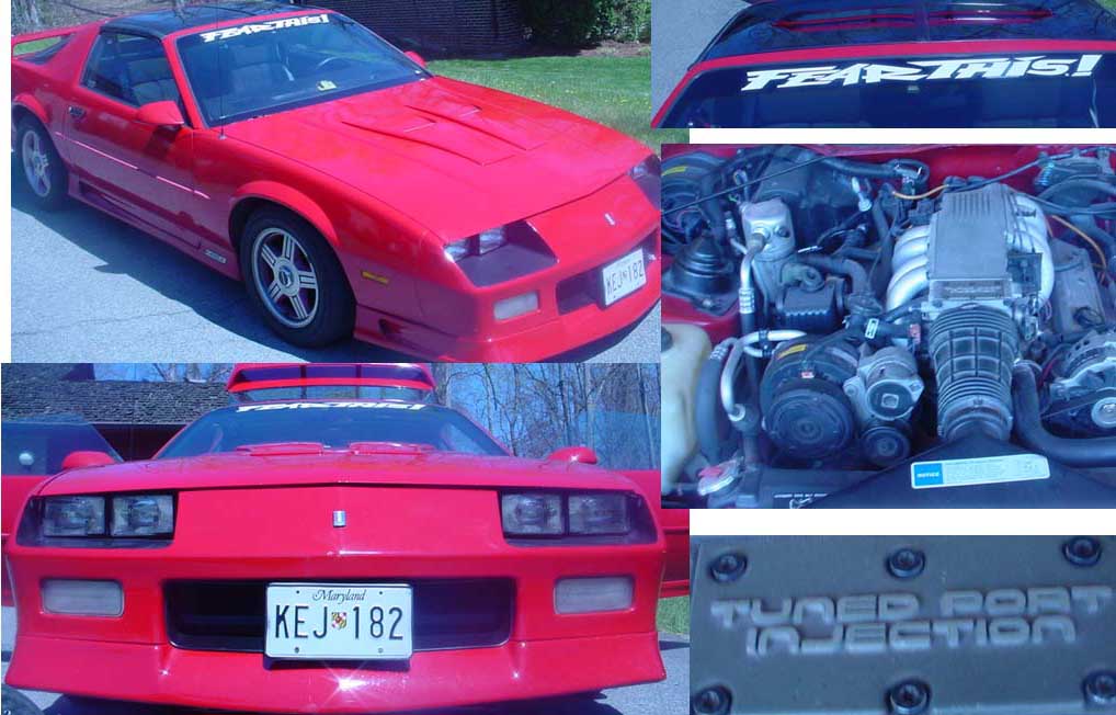

this is my car and i want her to be faster in the acceleration what can i do????? i dont wanna spen a lot of money its just a city car
to race stangs only
please help me
1991 z28 5.7L v8 245 hp all stock lowered springs
350 tpi
Attached Thumbnails Acceleration!!!!!!!!!!!!!??????????-sin-t-tulo-1

First off, nice car.
Secondly, swap in some 3.73's and get yourself some good, sticky rear tires to help it hook.
What kind of $$$ are you looking to play around with?

Port and polish the intake and plenum. Cold air induction. Good aftermarket headers and exhaust.
Loose the windshield sticker

Lose the "i've got a huge *****, I swear!" sticker, those are so gay

come on guys, chill out on the sticker issue.. its his car, not yours. If he likes it, then thats all that matters. Thats why there is opinions out there, everyone has them.. cridom did not come here posting a subject that says " LIKE MY STICKER? " he is asking how to go faster, we need to stick to the point here.. he likes the sticker, good for him... thats my 02

i like the sticker so stop it with that
