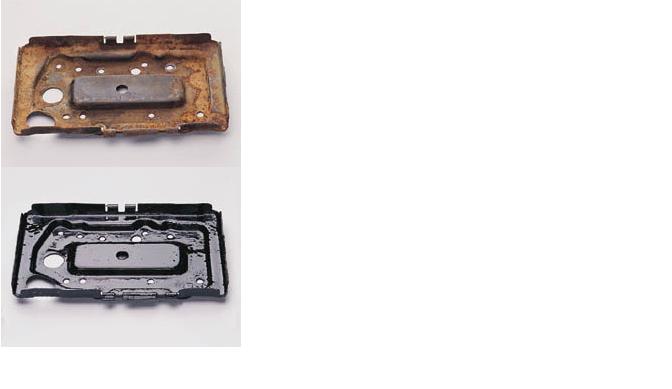

Old May 23, 2002 | 02:46 AM
MR. JORDAN's Avatar
Joined: Apr 2000
Posts: 435
From: SUDBURY ONTARIO CANADA
Before and after pic..
