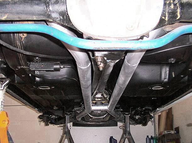

Another testimonial for POR-15.
I've used it to do the "topside" of my floorboards, my SFC's, and various other parts. It's worked great so far, but you have to prep it properly as they state on their website. If it's a clean smooth surface, you have to sand, do the Metal Ready thing, etc. That will be time consuming on the whole underside of a car, but not impossible.
I wouldn't bother with coating the POR-15 for UV protection. As stated, it will fade in UV rays, but won't affect its strength.
My car has ugly asphalt undercoating (put on by previous owner). When I put on my SFC's, I had to use a heat gun to scrape off the undercoating where the SFC's go. It was a major pain. Then after the SFC's were welded in, I used POR-15 to cover them and the areas where I scraped.
I definately don't have a pretty underside, but it is protected!
