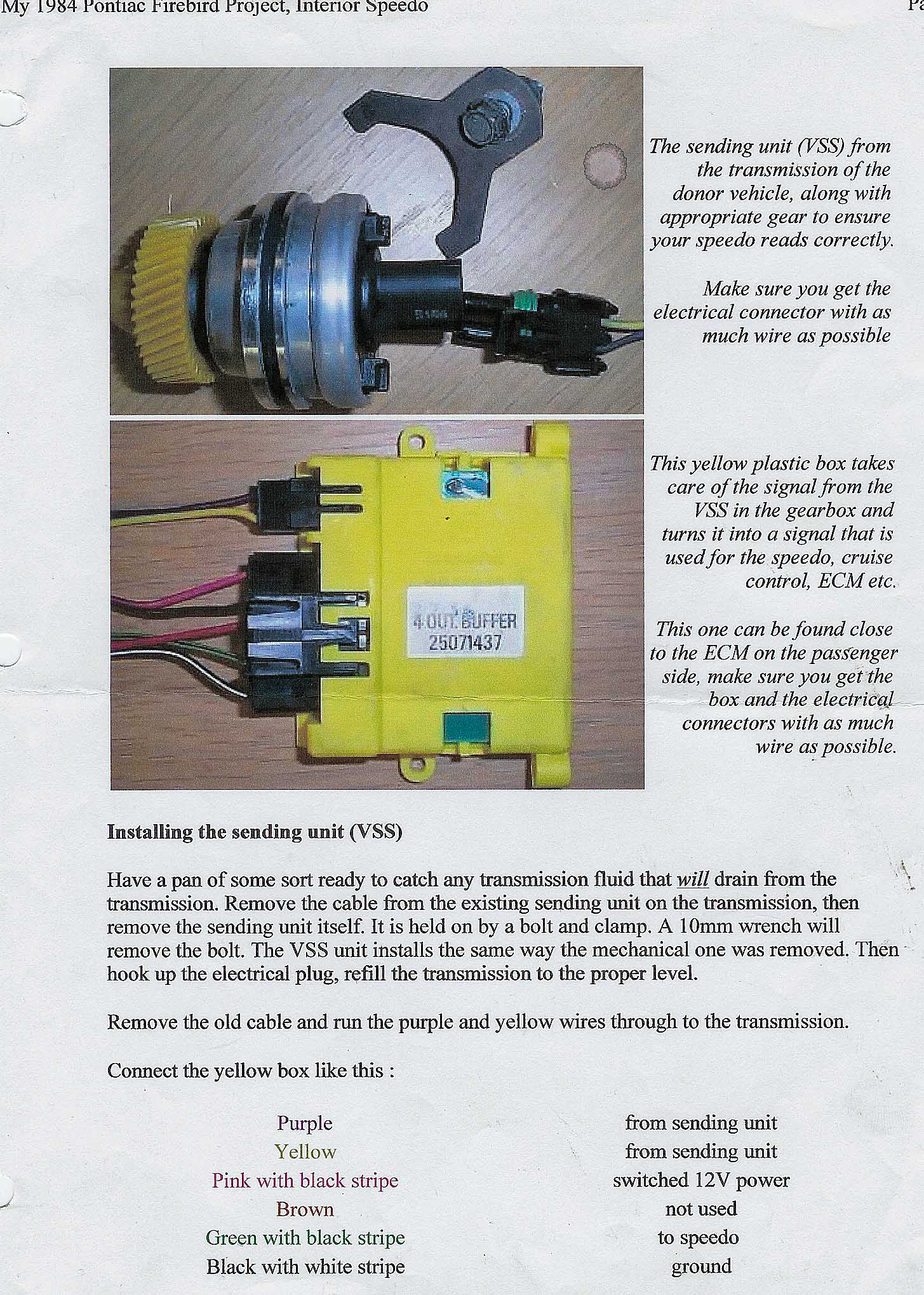

Could one of you provide me with the wiring diagram for the 4out.buffer. I'm upgrading to a tuned port and need to provide the ECM with the proper input. I already have the module, just not all of the connection points.
Here is a link with the pics :https://www.thirdgen.org/forums/elec...s-cluster.html
If that doesn't work, here is scan of the same info.
I have also added the schem diagrams for the ECM wire harness for TPI cars and the VIN E (tbi v8 cars) VSS wire schematic.
One thing tho, wire colour (and possible circutry) may be different from what I have posted. The two schems are for a '91 TPI and '91 TBI car -
depending on the year of ECM that you intend to transplant into your car the wire colours may be different and in different pin locations on the female ECM connector (or if you are splicing into the wire harness, then obviously on the male end...) From what year of F body is the ECM comming from?
-Andrew
