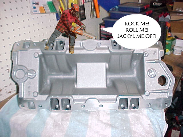

what will I have to do to what holes to get this to fit '87 heads, please dont just just elongate the holes, I dont know which ones or what exactly to do, dont worry, I wont be doing it, my dad will do most, and I will learn, but Im just curious and I dont live w/ me dad.

The center holes on each side. Edelbrock makes a tool just for doing this if you are worried about it.
Manifold Bolt Hole Slotting Tool #8501
Manifold Bolt Hole Elongating Tool for Small-Block Chevy Intake Manifolds
This handy tool is for the amateur as well as the professional engine assembler allowing for simple elongation of the intake manifold hold down bolt holes. It¹s for use on intake manifolds in which the engines have had either the heads or the deck surfaces milled and the stock location manifold bolt holes are mis-aligned. This steel tool can be used in the shop or at the track. With only three parts, this tool is very easy to use with detailed, step-by-step instructions and a user-supplied drill motor and 7/16" drill bit.
