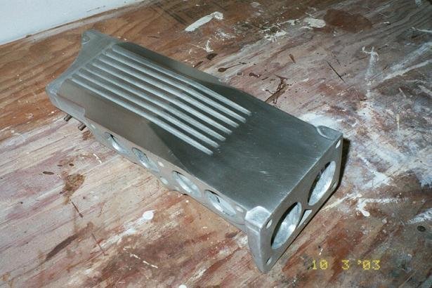

Pics of polished plenum
It took me about 2 hours to make it look like this, i started with 80 grit and ended up with 800 grit and used the mothers aluminum polish to clean it up. looks great! i also ported it for my slp runners and ported the whole plenum, car runs great now!

that looks very sweet indeed

That looks awsome, nice job. What did you do the porting with? How long did the porting take?

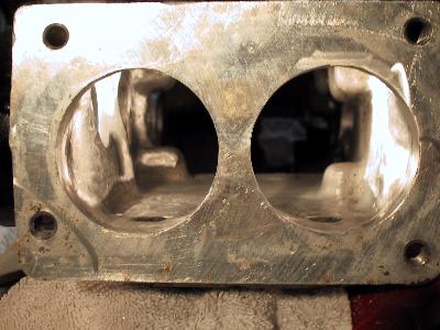

can you explain the porting on the front of the manifold? What is being removed there. I havent looked at one in so long i forgot...
edit: looks good btw i have my runners polished but not the plenum, i know what im doing next week though...

Are you gonna take more material off the tb area?

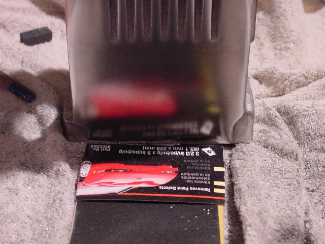

Looks good! I took mine right up to 1000 wet sand, then a 3 stages of buffing compounds, but I am going to finish it off with 1500 and 2000 wet micro. I will, by then have a total of 20 hours into the TB and the Plenum.. Now I need to buy a Vette Plenum extension and polish it to match...
here are some pics.
