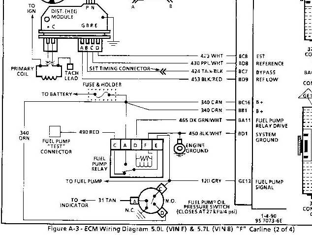

try jumping the fuel pump relay to make sure the wire from the relay to the FP is good. Also would help if you make sure the relay wors too. If that checks out, then yes, it is likely that you missed or misplaced the fuel pump relay enable signal from the ECM to the FP relay. Don't know the wire colors or pin numbers offhand, but if you just swapped harnesses you probably have a schematic handy.
OK, just remembered i posted the relevant piece of the schematic in another post recently.
If you don't have BA11 going to the FP relay, therein is your problem.
BTW, you are correct in that VATs doesn't disable the fuel pump, it diasables the starter relay and injectors. And you have a VATS delete chip anyway so...
